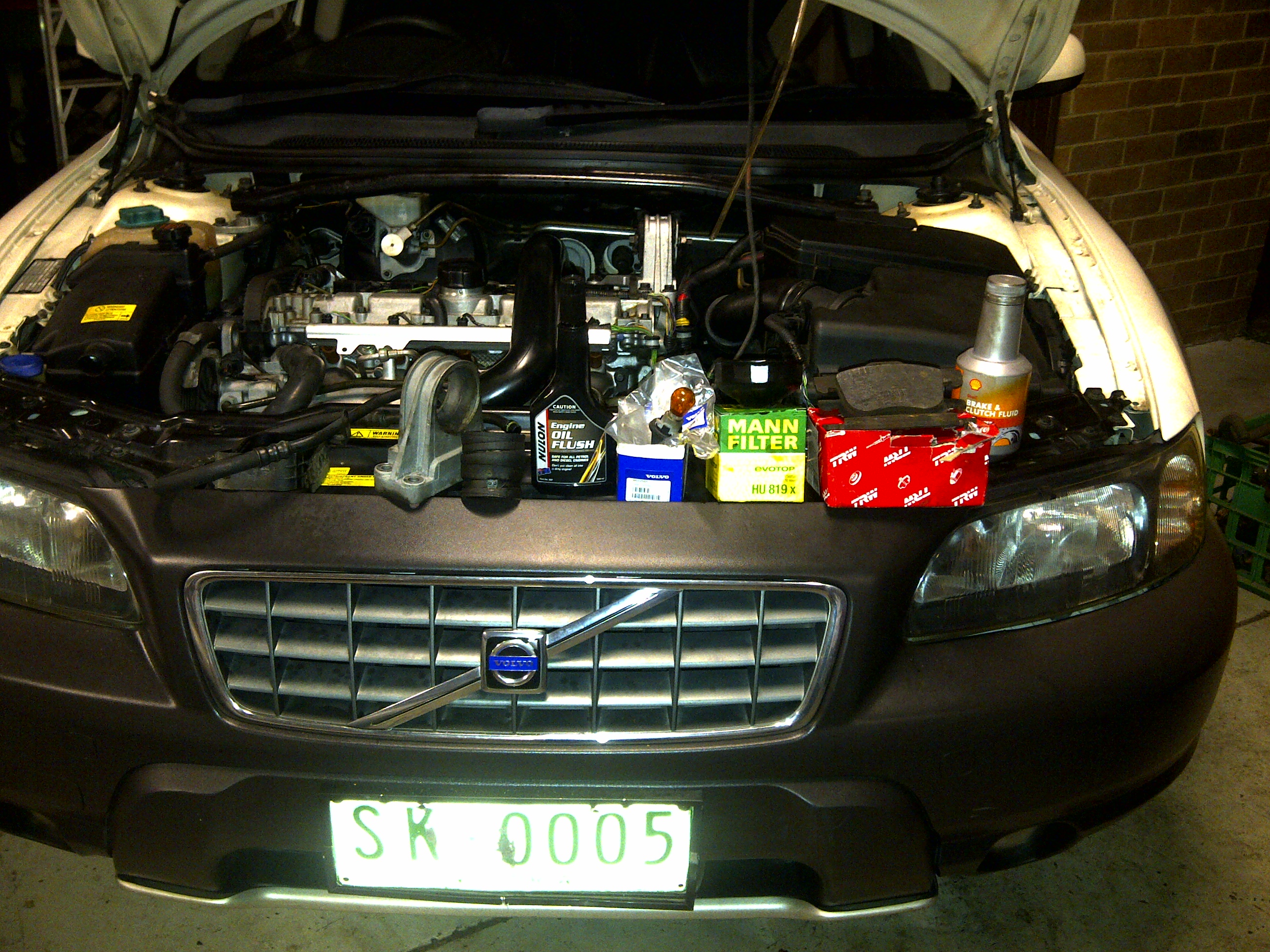

These items were the start of the "Clean up of my 2000 V70 XC", you will notice the Nulon Oil Flush Black Bottle, this is the "Goods as we say" and does a great job on cleaning up any engine.

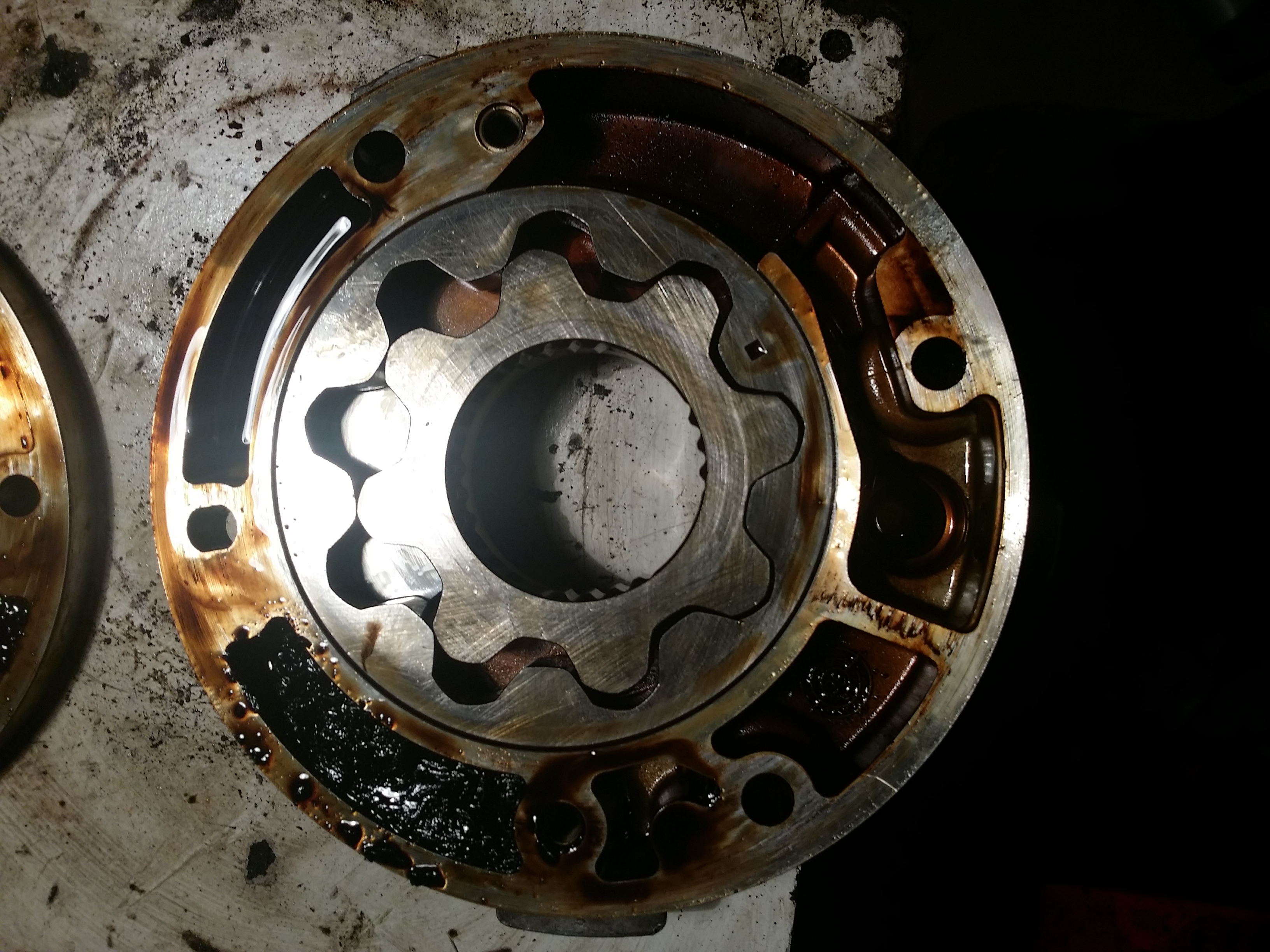

Above is my V70 Oil Pump that has just been pulled apart and in a corner of the Pump where there was no circulation there is still a lot of Sludge on a motor that is now very Clean as you can see in the balance of the Pump.

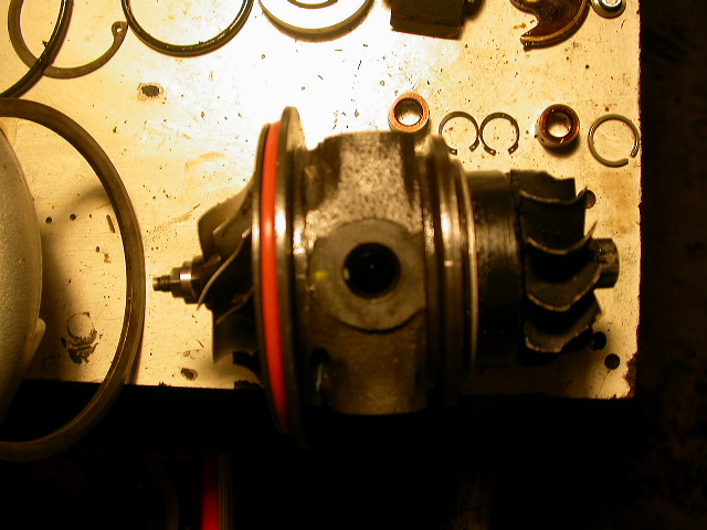

4 Now for the "Turbo Charger", you need to pull off all of the Incoming Piping Systems to give you access to the front of the Turbo.

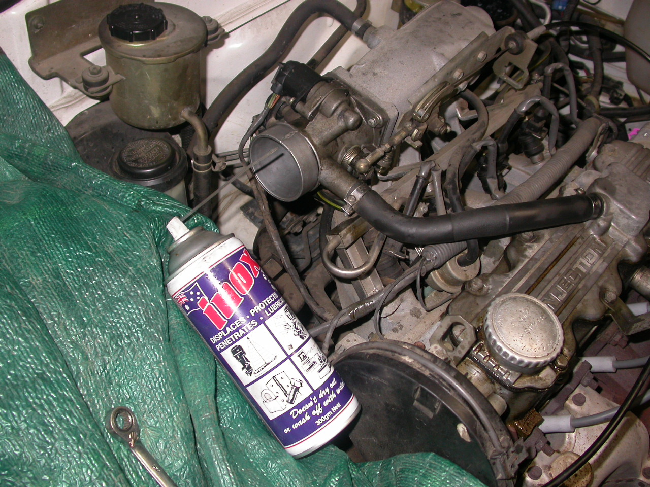

5 You will only see a small amount, but this Photo shows you the access that you can get one hand into and you will be able to "Spin the Turbine with your fingers" and you will get a feel for how free the "Turbine is to start with".
6 Now you start the "Inox Treatment" and Spray in liberal amounts of the Lubricant and then start to "Spin the Turbine Free", as you will feel the Turbine start to move Free-er as it starts to De-Carbon, just do it as long as you can or feel that it is not getting any free-er. You will be amazed I assure you of this if you put in the effort!
7 I do mine on the Bench when I can, but I did my V70 in the car as I have described and it works a treat now.
