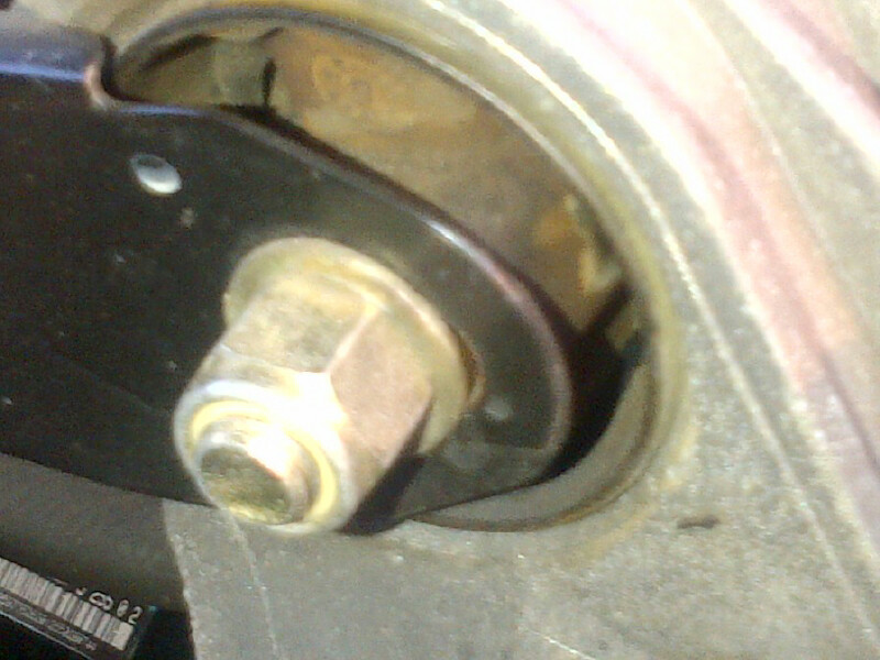

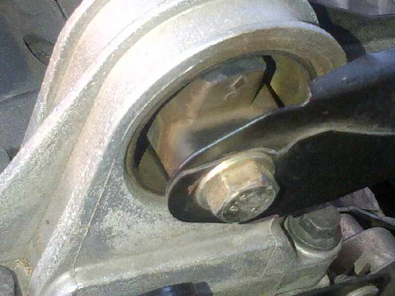

Thanks for the offer, erikv11. Here are two pics of the top mount, in which I tried to show as much of the rubber interior piece as possible and any horizontal cracks...

Well I can't tell for sure but that top mount does look at least OK, it isn't trashed. Try shaking the engine by hand and check for motion, or revving it up and see if it leans in the mount. If not, maybe it is still good.
