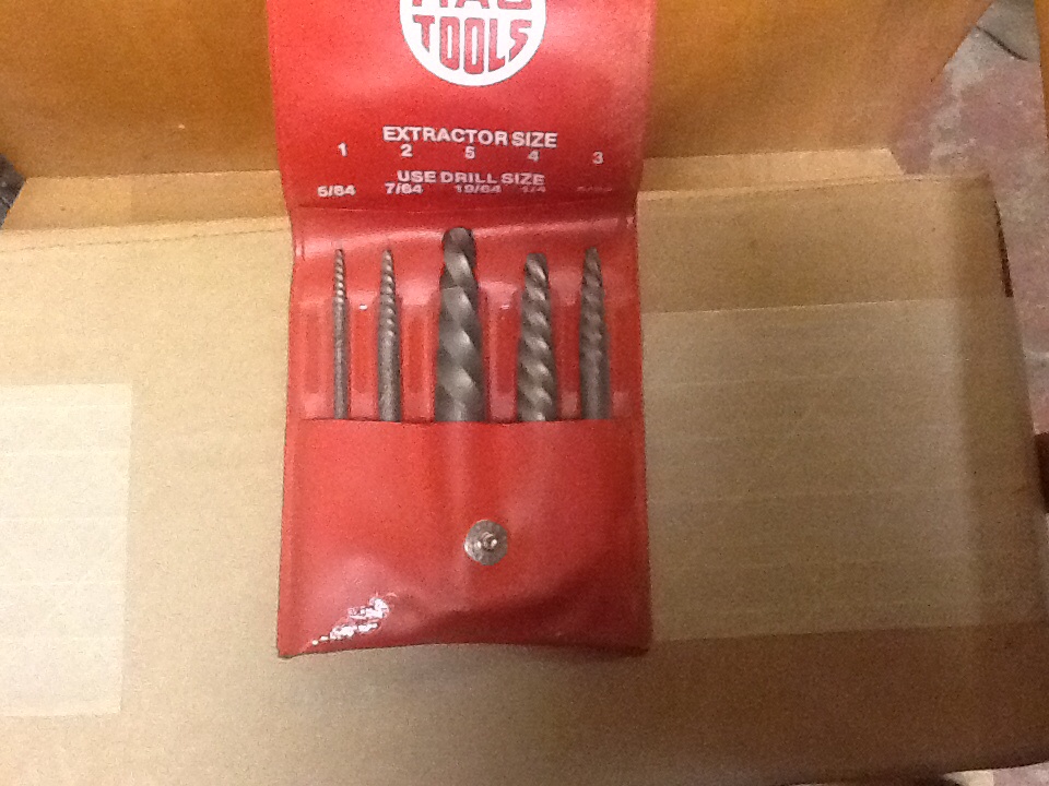

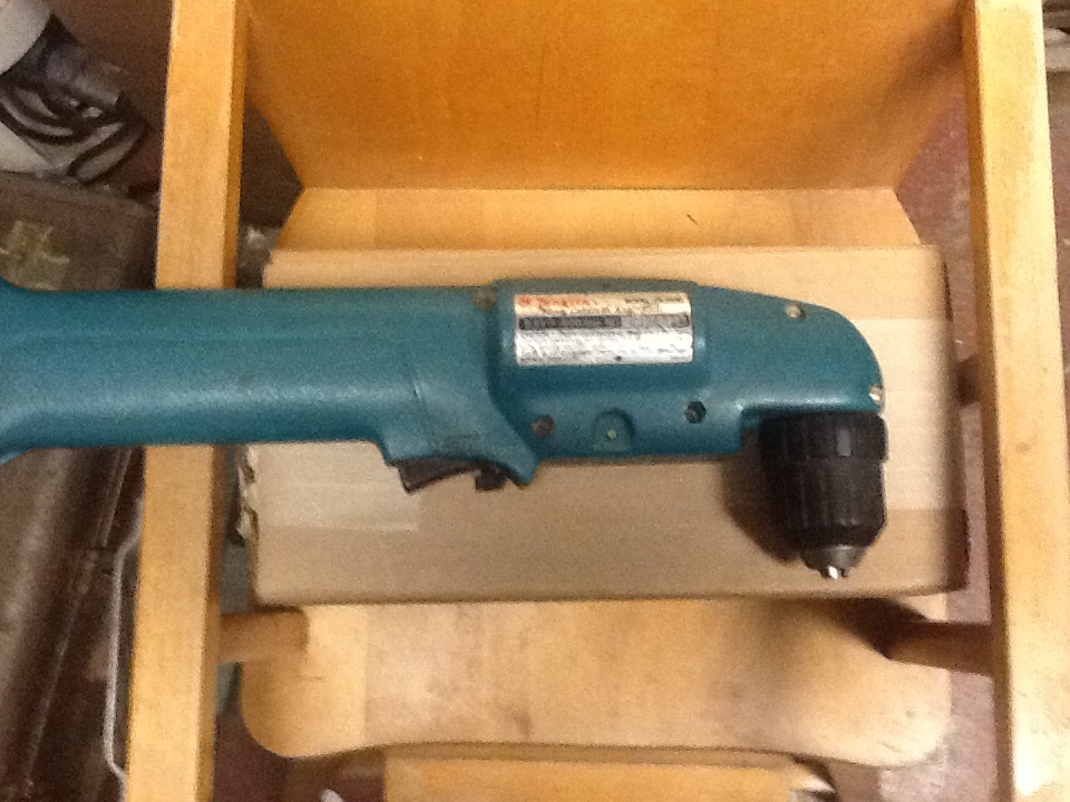

If you can get to the bolt with a 90 degree drill and a screw extractor you can get the screw out.
