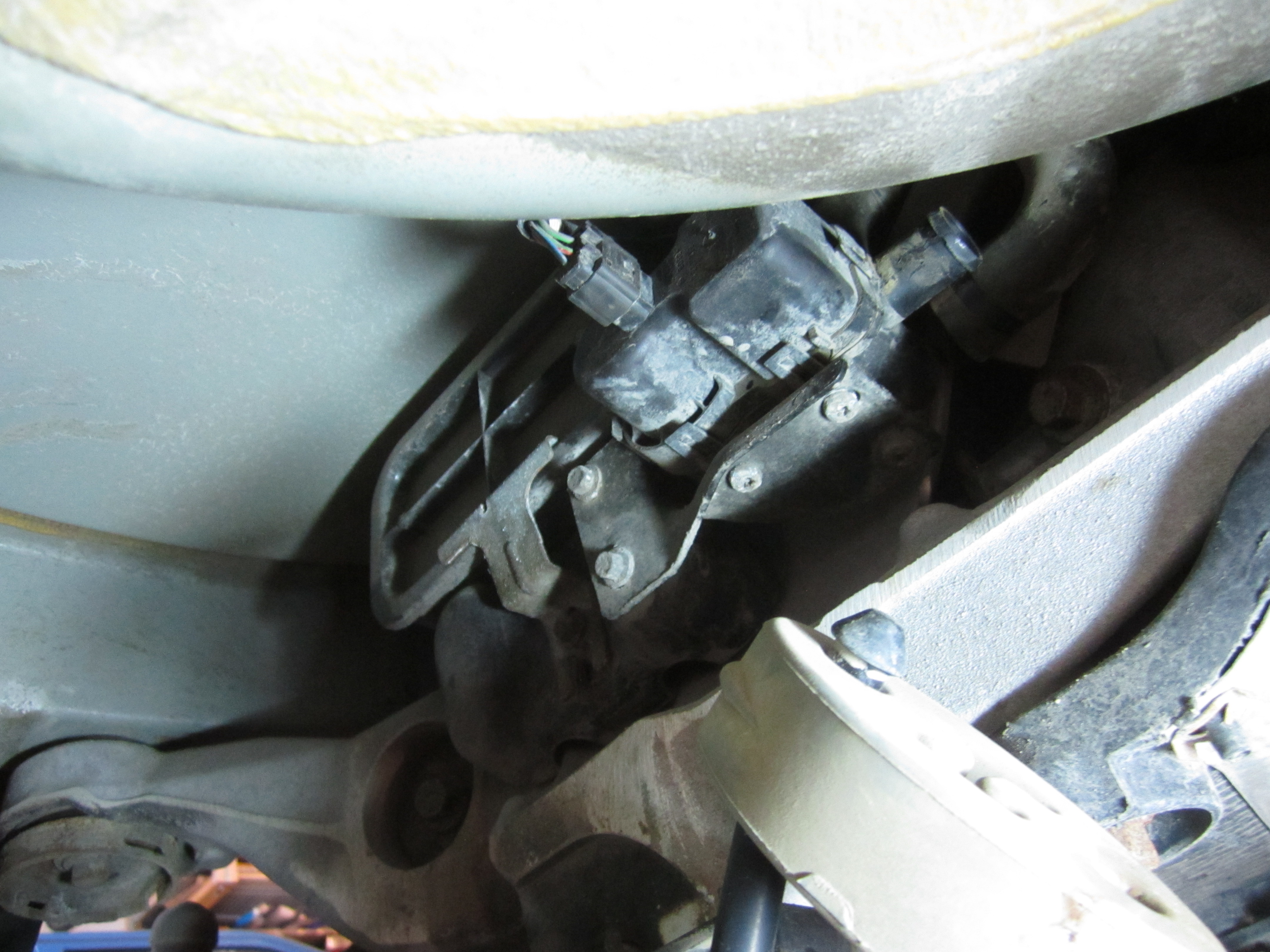

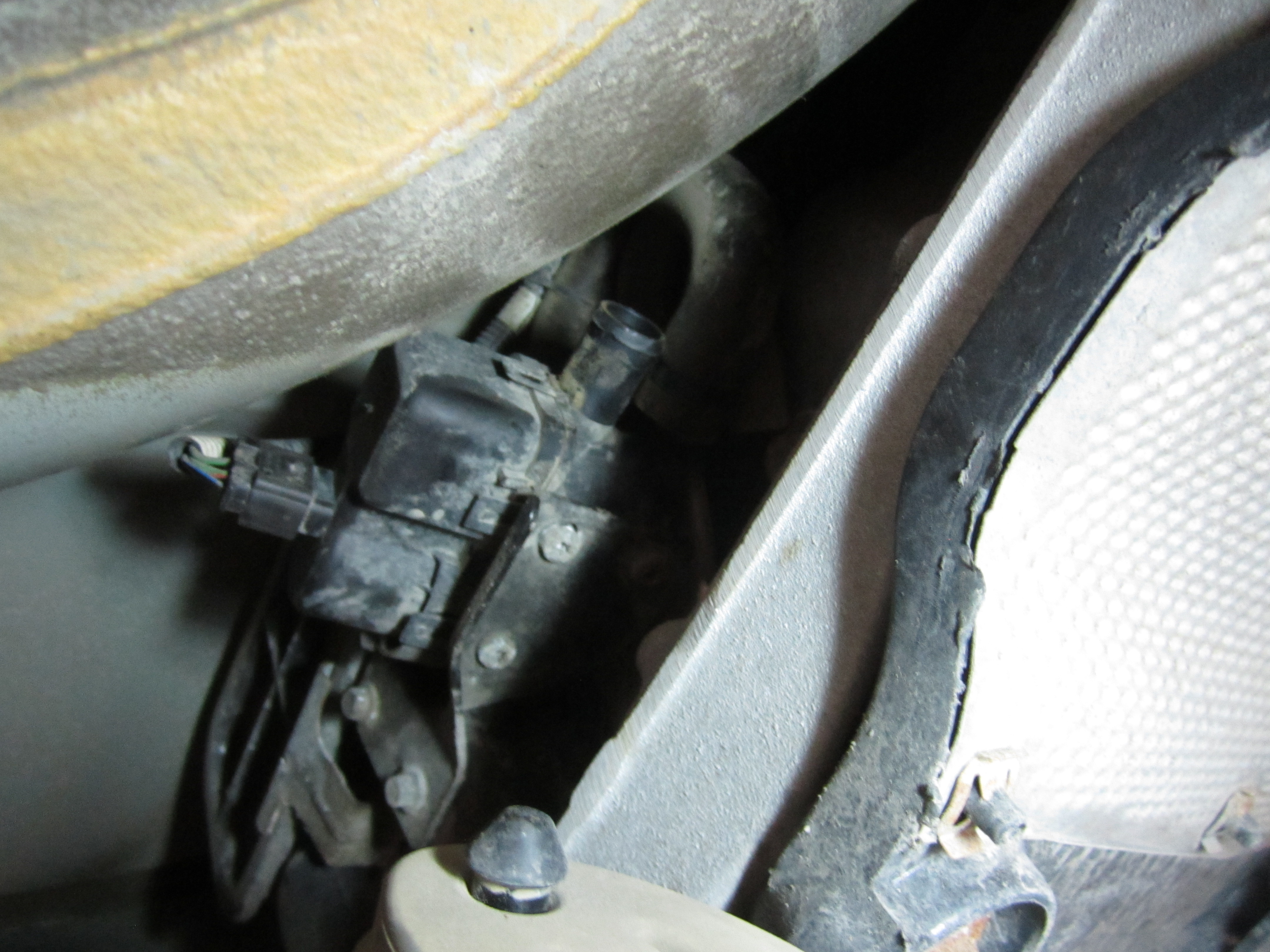

9) This now gave access to the Evap. Pump (although not much room!!).
1 of 3 views of pump. Positioned in-front of spare wheel well and above rear axle
2 of 3 views of Evap pump
3 of 3 views of Evap pump
10) I used a flat blade screw driver to pop the lowest oetiker clamp, and then removed the 2 bracket bolts ( can’t remember if 8 or 9mm socket)for the Evap. pump which gave room to allow it to drop sufficiently to access the upper pie and remove the 2nd oetiker clamp. With a little WD40 and gentle persuasion, the 2 vacuum pipes were removed allowing the pump to be removed.
Remove the wiring connector. Maybe there is an easy way to disconnect this, but I ended up using a small hook tool to carefully lift one side of the connector where there is a raised 'bump' before being able to disconnect it. Be careful as the plastic will be fragile by now!
