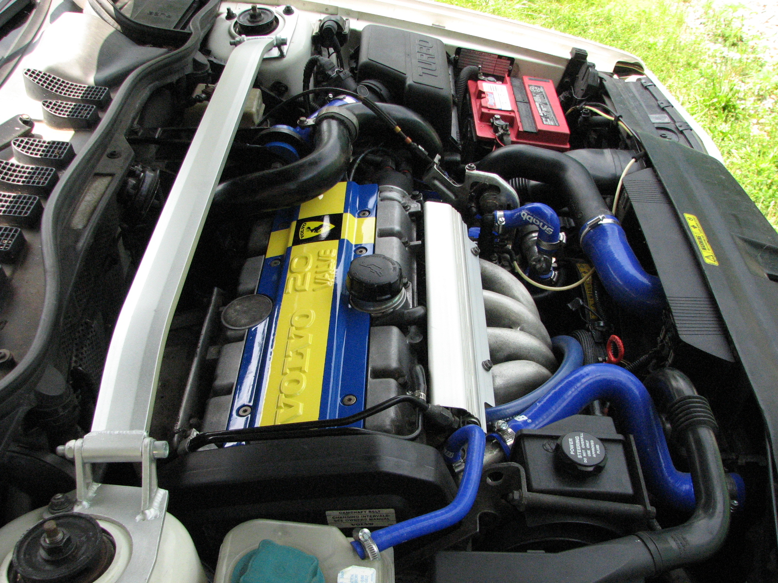

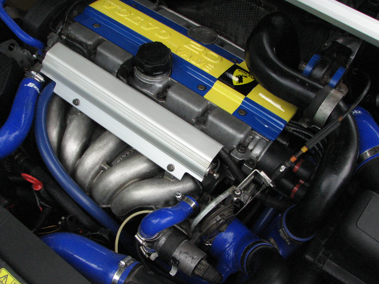

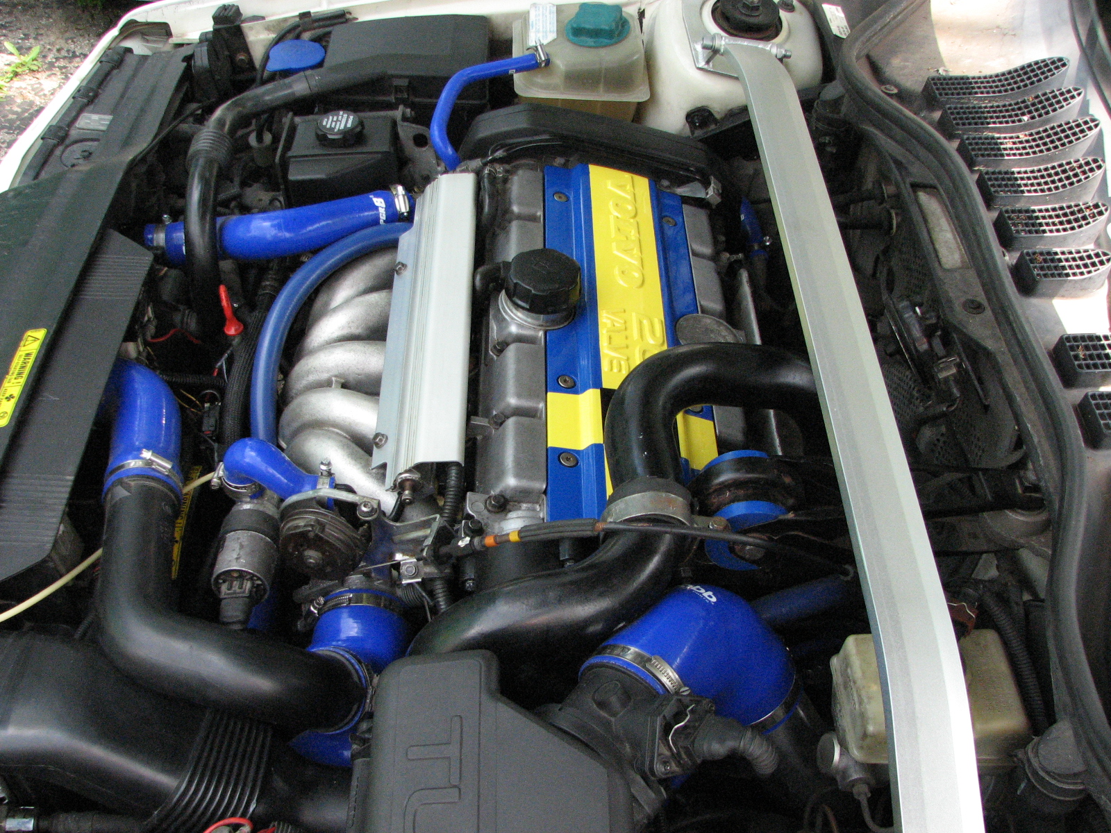

Ben850 wrote:Test drive went well today. Weather is going to be in the teens this week, so next week will be favorable for transferring the Wagon back to the daily driver.
The ECU took only a few seconds to realize the new injectors and airflow.
The R ECU will have to wait until next week.
Ben ..watch the inboard corner of the coolant hose on the sharp edge of the fuel rail cover for chafe. Is that corner of aluminum safely free of the hose?
Ben850
Posts: 1613
Joined: 08 Sep 2011, 13:53
Location: Michigan
Been thanked: 7 times
Post by Ben850 »
That hose is the 5/8" heater hose that is substituting for the PCV line from the oil trap to the PTC nipple.
I ran it that way as to not kink it anywhere along the route.
You can see a black one of the same size in the before photo. The N/A manifold is slightly larger so I had to change the routing just a little.
I will keep an eye on it, but it would only be moving with the engine because it is connected to itself, so I don't believe it will even rub much, unless the top radiator hose puts pressure on it.
The top torque arm bushing mount is solid as well.
Thanks for pointing it out though.

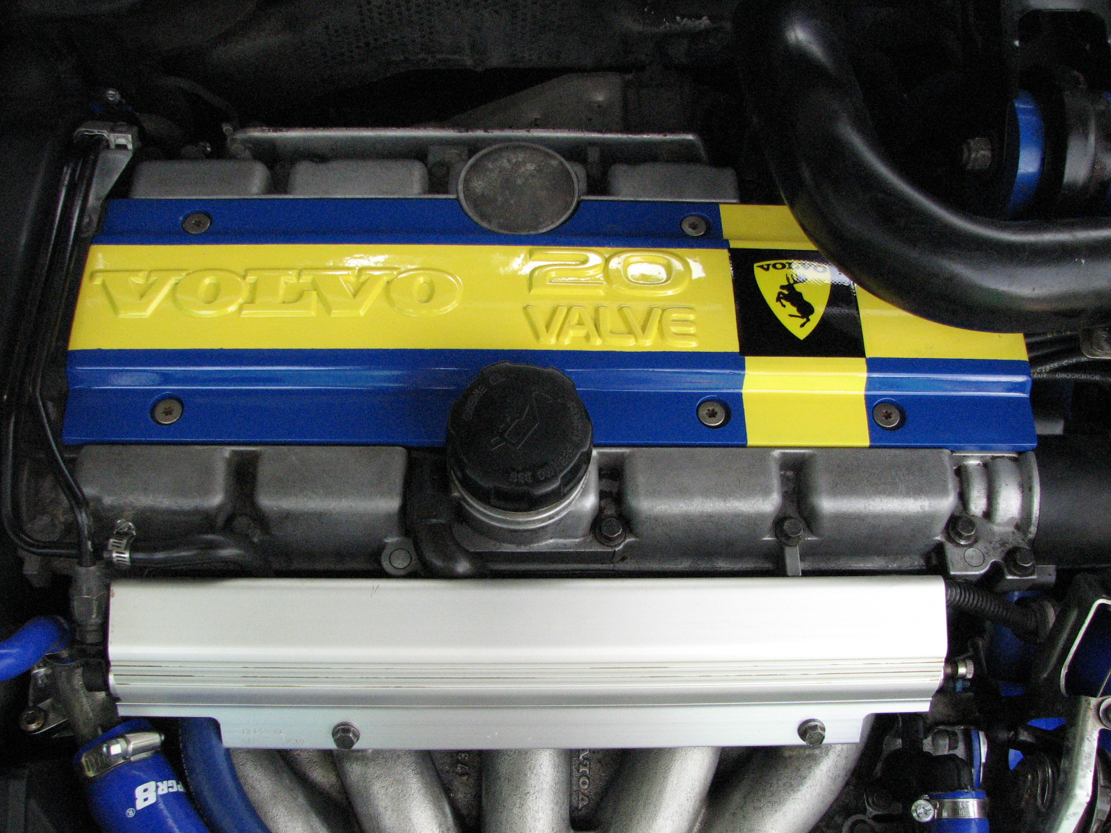

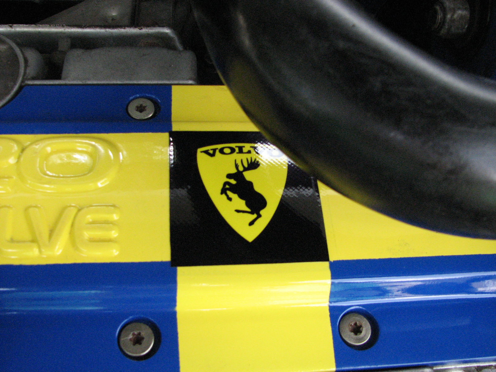

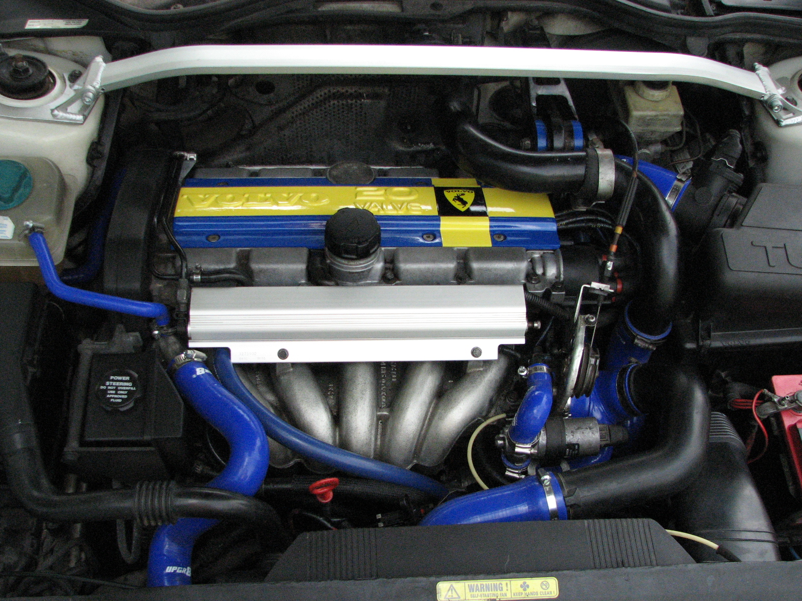

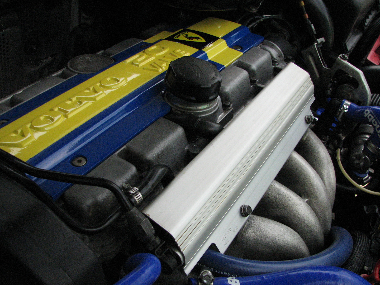

I found a guy customizing spark plug covers on e-bay.
They look pretty interesting so I went ahead with one.
It was reasonably priced. I did add a heavy coat of oil and gas resistant engine clearcoat because it appeared to be paint and sticker only.
I think it's a creative graphic. I'll give it some time to grow on me.
It looks pretty good with all the other blue stuff. I can always change back.

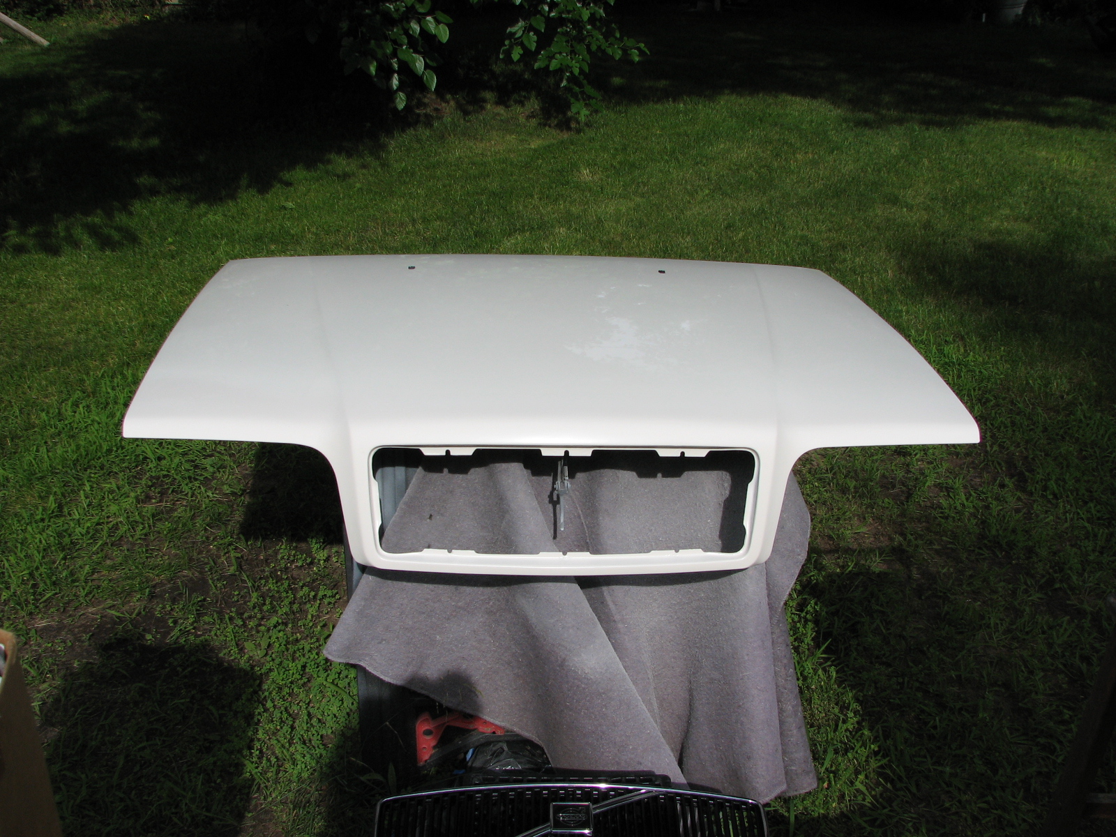

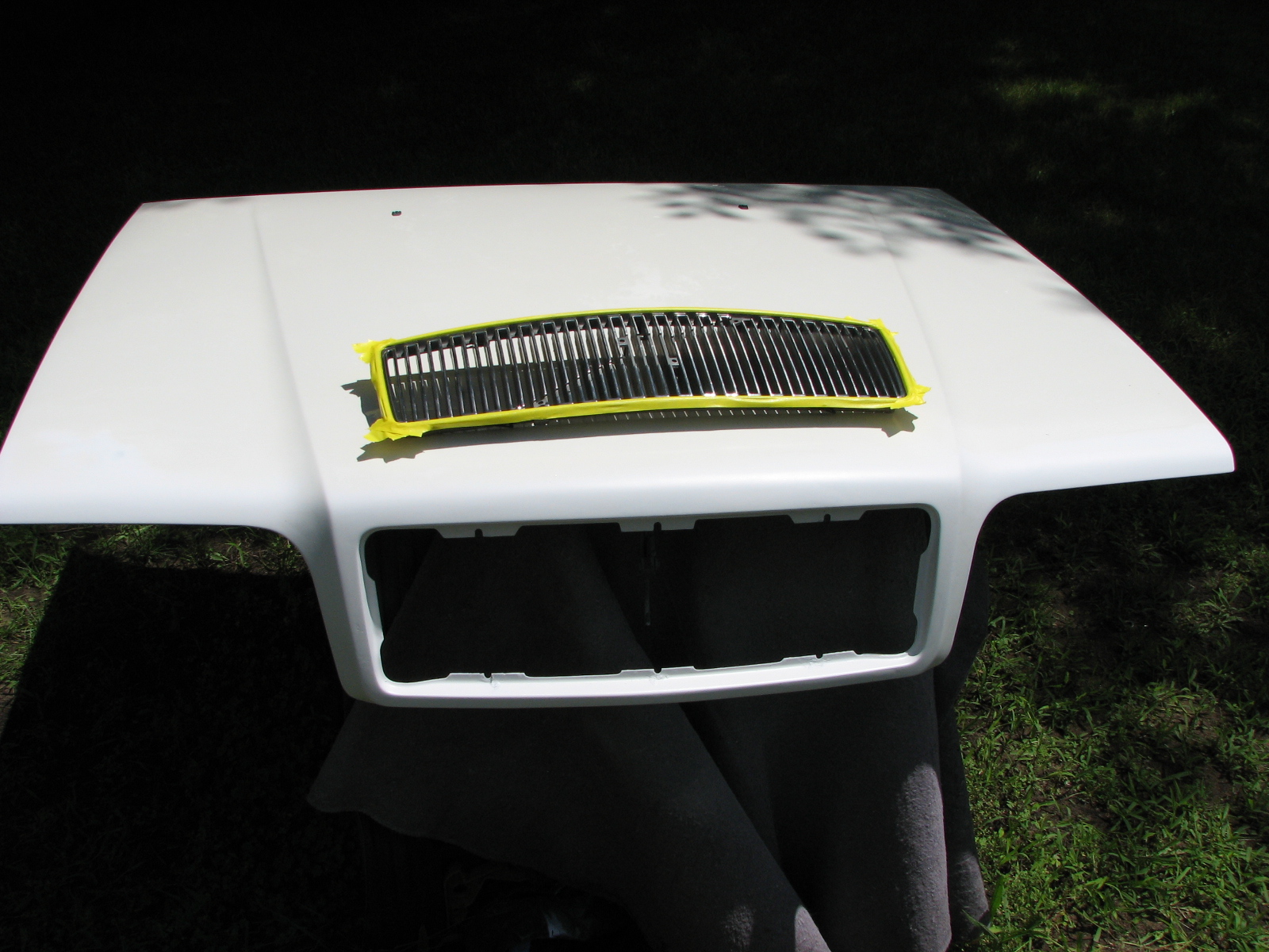

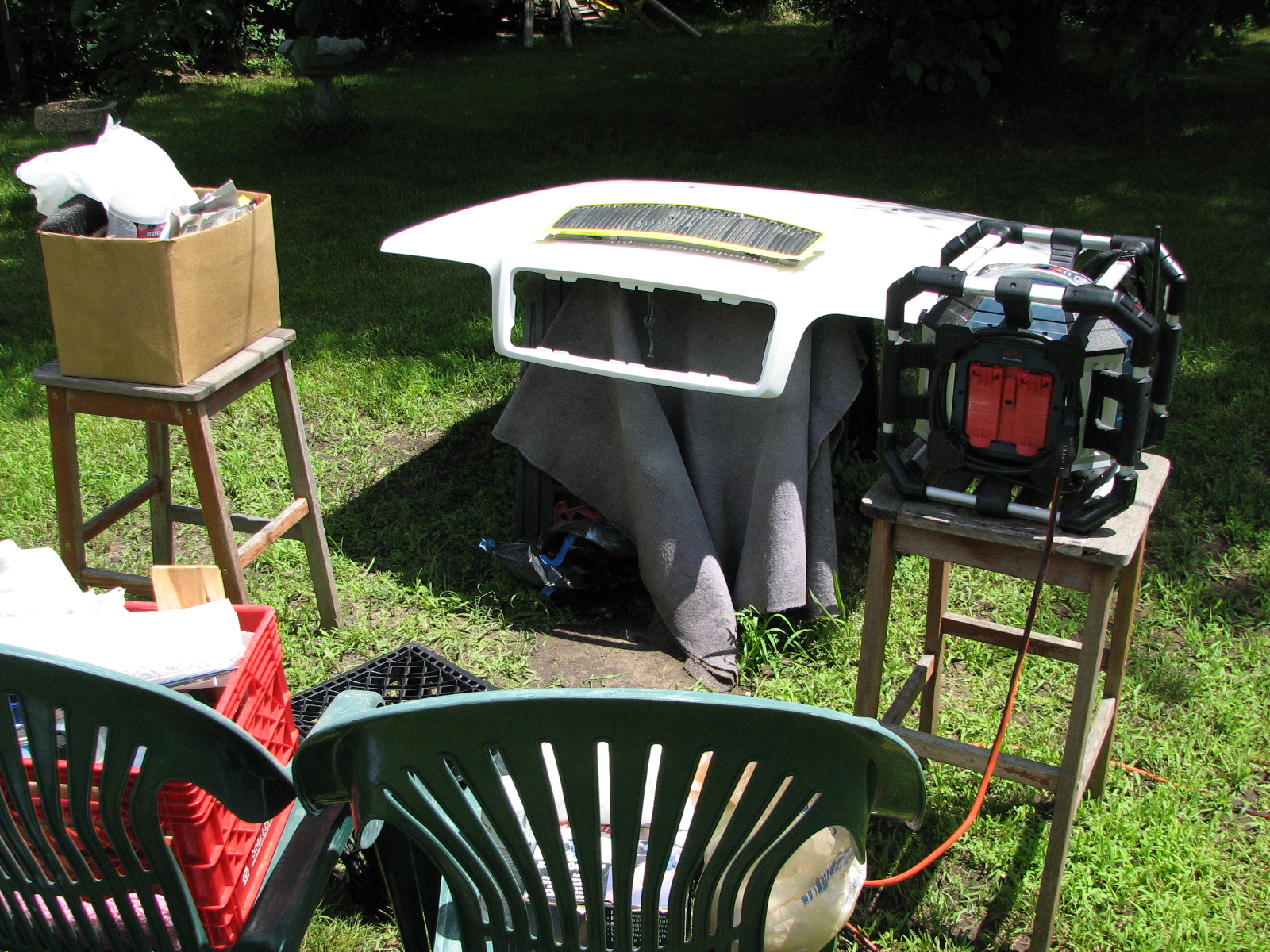

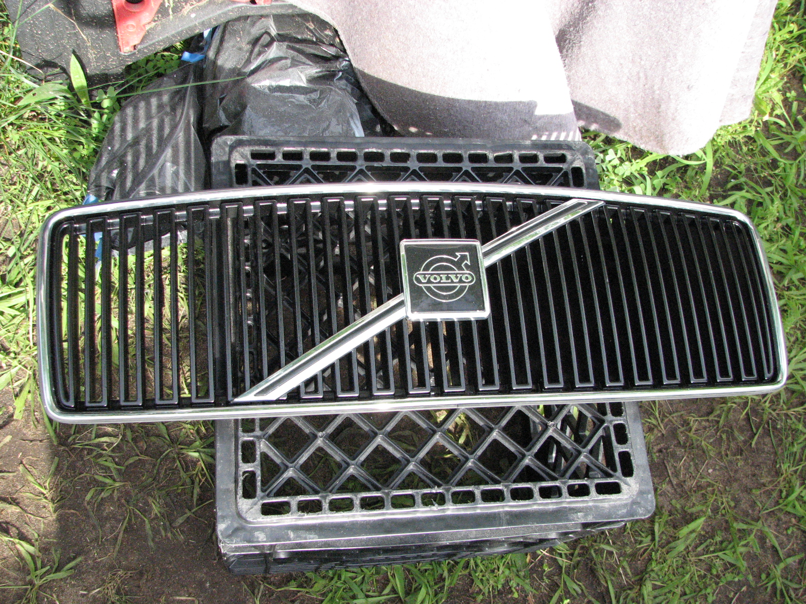

Finally got back to the hood in the back yard today.
finished sanding, priming and clear coating the hood.
Also blacked out the grille. This is the third one now. The spare will go to the T-5R project as I will retire the sedans old hood and have an extra.
Musical hoods.
The new hood goes on the wagon.
The Wagon hood goes on the Sedan.
The sedan hood goes to storage.
Sedan grille goes to T-5R project.
Work site.
Work site.
Grille prepped.
Grille prepped.
Grille painted.
Grille painted.
Hood clear coated. Rub out tomorrow.

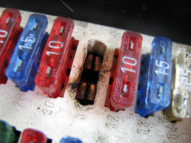

I finally fixed the power issue to the ECC unit after reading schematics, testing for continuity, swapping parts and inventing tools.
I chased it back to a damaged contact at the fuse box where the previous owner had learned about ground apparently.
Previous owner getting creative with the fan motor wiring.
He did something to this circuit as well.
There were a couple burnt spots at the fuse box, but the bad contact turned out to be on the side of the fuse that was not burnt. It seems it was just spread too wide and made intermittent connection.
I went in with some dentist tool type pokers and tightened up the contacts.

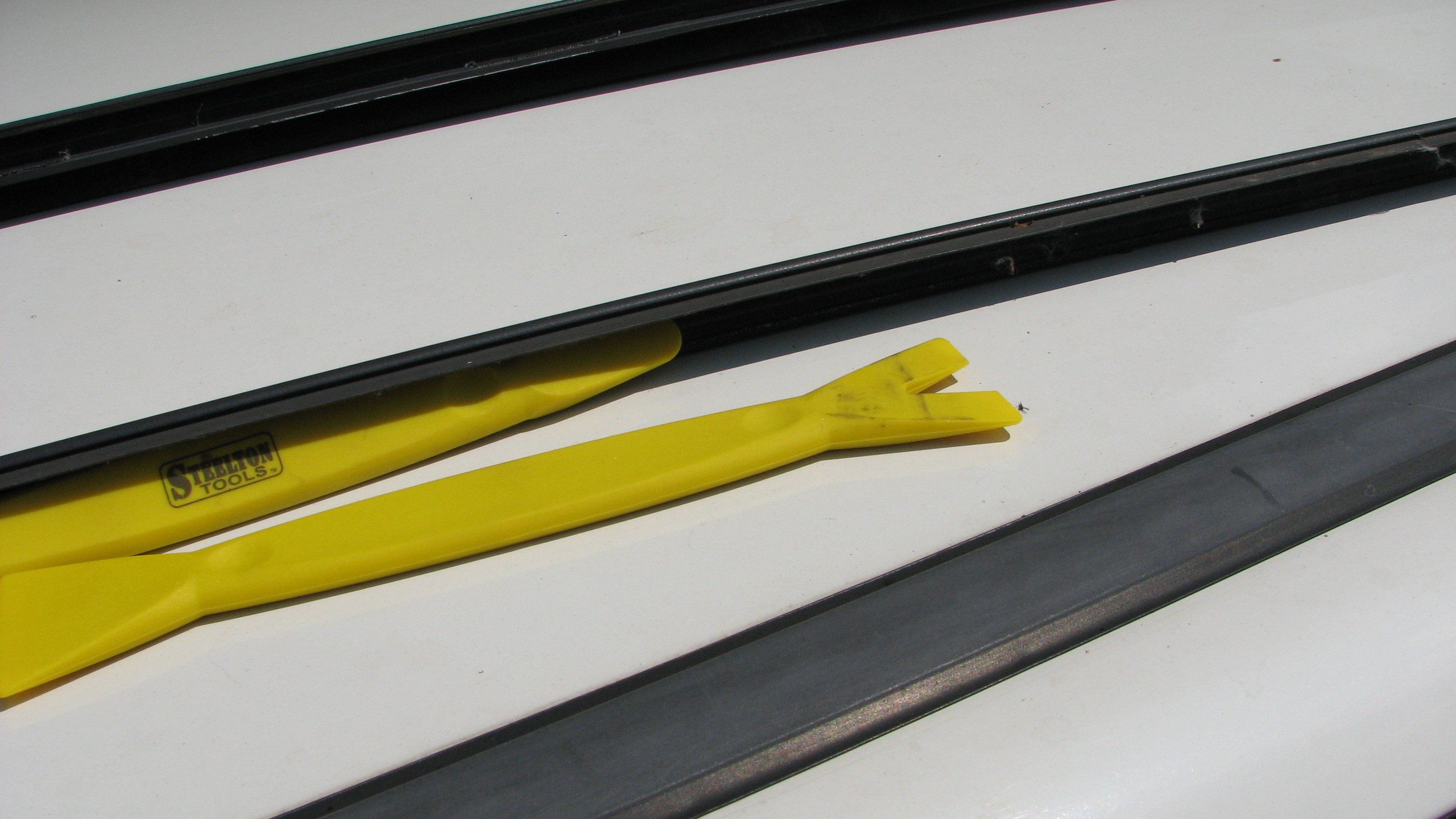

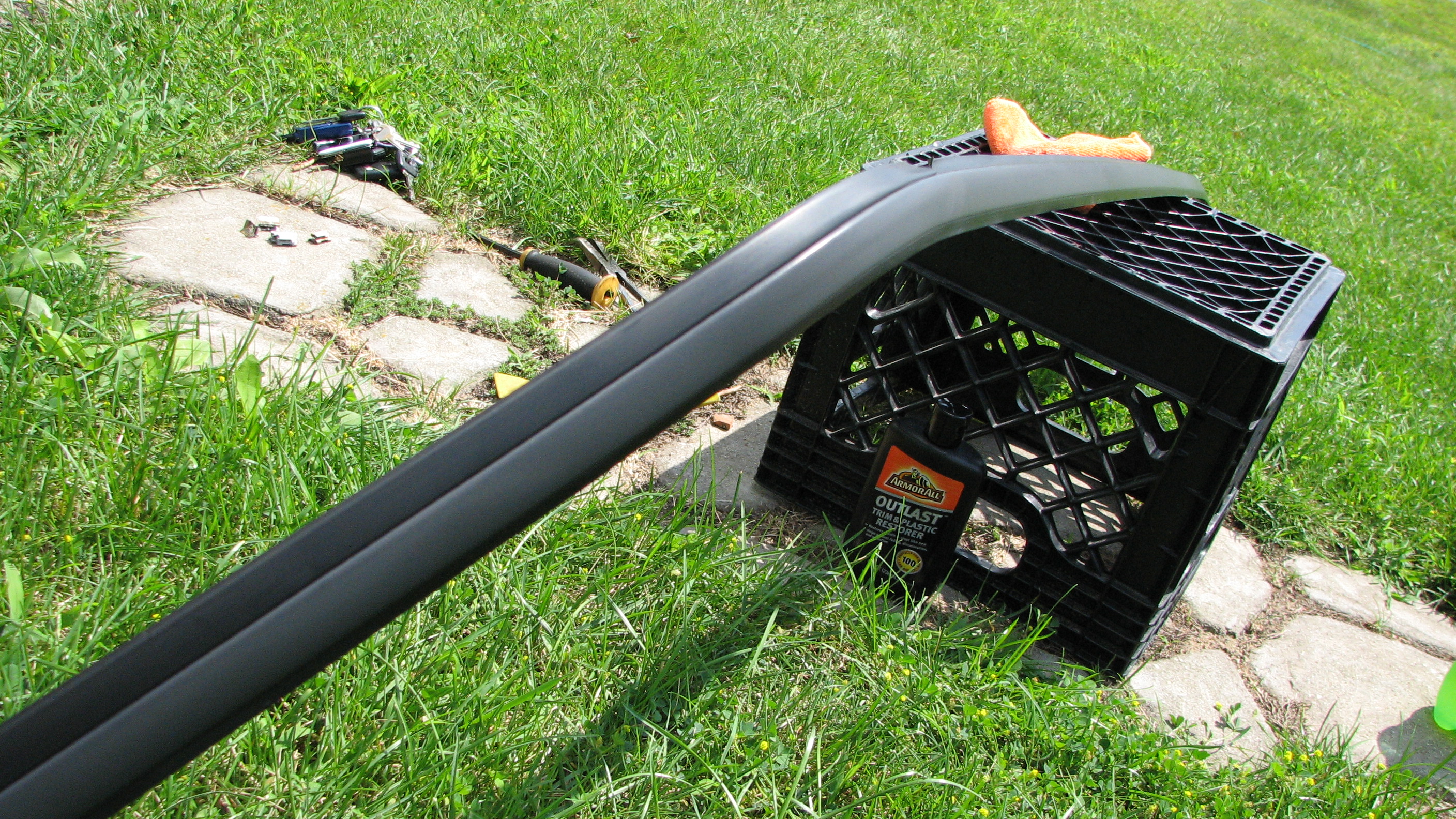

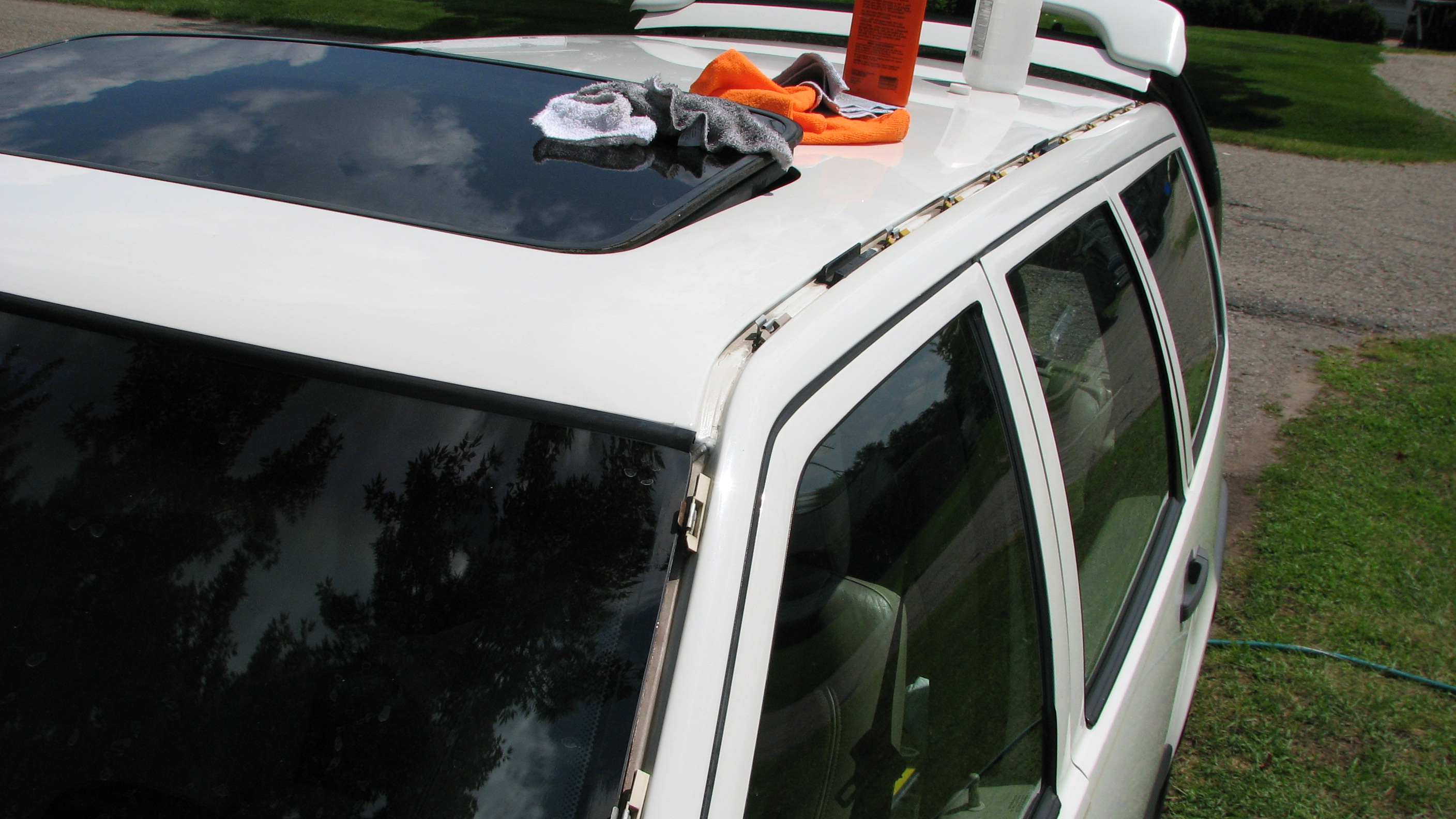

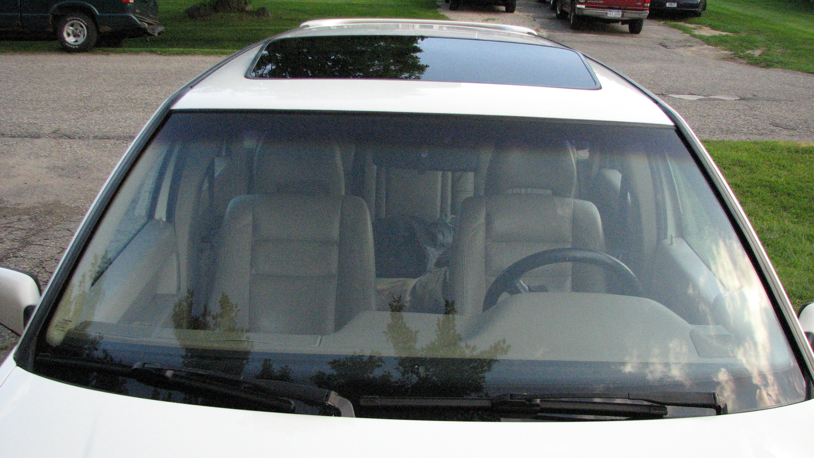

Today I felt like getting something out of the way, which was the V70 roof molding. My roof trim was beginning to crack up and peel and I've been patching it with Gaff tape.
The V70 rails have a rain diverter track along the windshield so the water, washer fluid, snow or whatever, doesn't come inside the front windows if the happen to be opened at all.
They have been sitting around since last year.
I cleaned them up with alcohol and used  the new Armor All trim restorer.
Cleaned out the track and got rid of the years of dirty wax along the old trim.
They look great and should be pleasantly functional.
I plan on grabbing some from an S70 for the Sedan/s

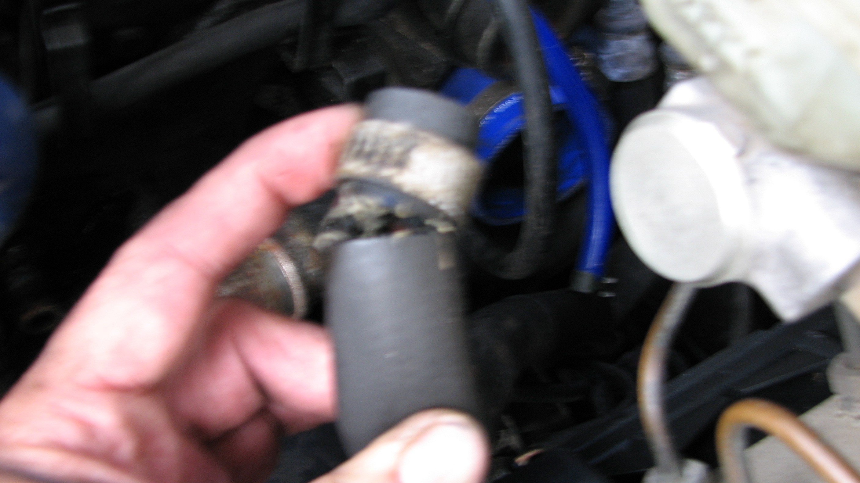

So at the end of the season a heater hose failed luckily a half mile from home.
After the whole summer.
These and the turbo coolant return hose were the only ones I had not replaced.
Now taken care of both.
