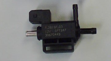

Most other threads and websites show either of these sensors. See pictures please
Which one are we talking about?
Can I check / test any of these with a Multimeter or something?
I hate to buy 3 sensors, 2 boost and one MAF, when only one may be needed.
thank you
boost sensor 2
boost sensor 2
boost sensor 2.jpg (16.19 KiB) Viewed 9511 times
boost sensor 1
boost sensor 1
boost sensor 1.jpg (19.98 KiB) Viewed 9511 times

The top one is located clipped to the air cleaner box and is not a boost pressure sensor; it's a TCV (turbo control valve)
The lower picture is the BPS and is Iocated on the intercooler pipe leading to the throttle body.
If resetting the engine code doesn't clear or it returns it should be replaced. Junkyards will sell this cheaply enough.
