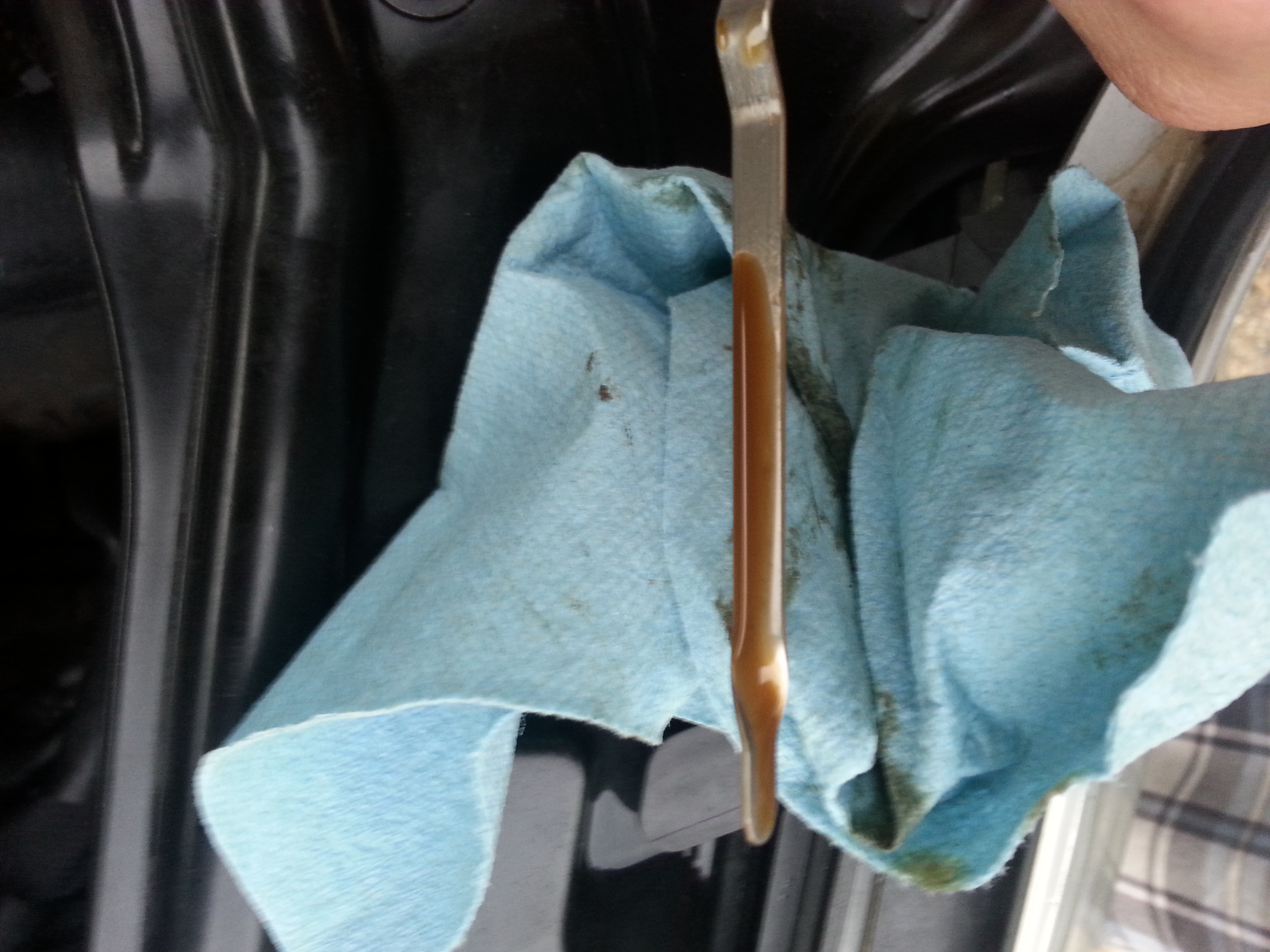

Recently purchased this 06 S80 with a cracked radiator, before purchasing, checked the oil and everything else, looked fine. Finally I was able to change the radiator and also changed the oil but when drained the oil, it came out like mud, it was thick brown, the car sat about 4-5 months after purchase. I changed the oil and filter and oil looks still bad like in the picture. Do you guys think I have a blown head gasket? What you guys think?
I appreciate for any input in advance.

Yes it does rather look like it.
The coolant level will be going down also as it gets into the crankcase.
Do a compression test but also look for evidence of water in the cylinders when you remove the plugs.
Needs attention urgently as its going to damage the motor if not rectified ASAP.
Leaving a motor sitting for a long period like that is not good either as corrosion starts.

Don't jump on HG yet. If the car was run only short periods due to the radiator leak prior to you buying it the condensation could make the oil that light milky color.
If the only symptom ends up being milky oil the oil cooler can leak and do that too.

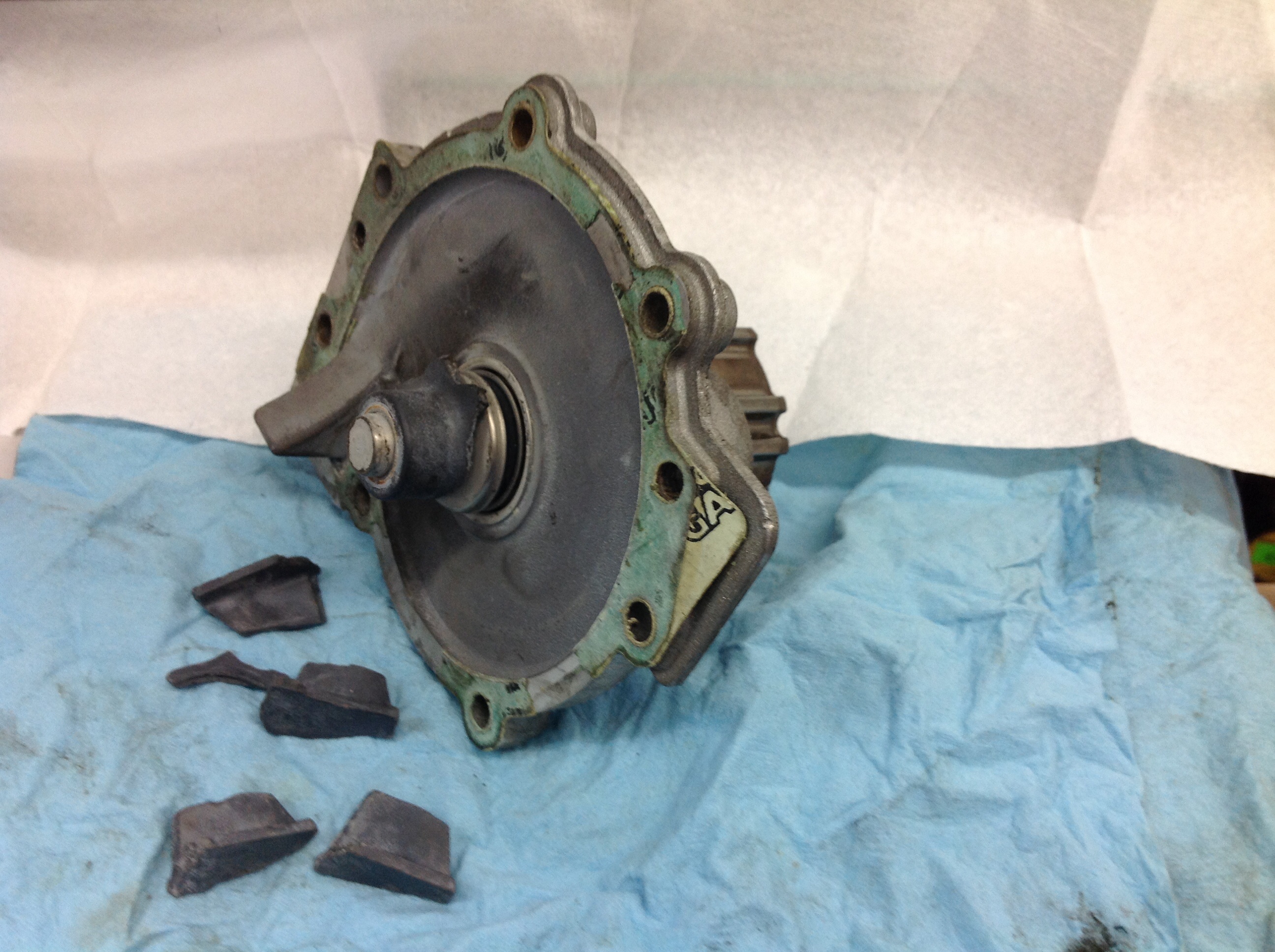

This is my broken water pump.
My engine oil look fine for all that time never had mix with coolant at all,I didn't mention,the engine sometimes started rough in the morning for about 1-2minutes before it runs normal,yes CEL flashing but did not stay.
One commenter said this product works best with Prestone antifreeze only and I took his word.First I drain coolant out because mine was not a Prestone,flushed the engine and drain it off,then remove hose clam at the cylinder head coolant outlet toward radiator pull the hose out bend up and pour the BlueDevil liquid into the radiator and the premix coolant followed til it full,reconnect the hose back and tight the clam,refill coolant reservoir til it full to the top no need to cap it yet.Start and idle engine til it burb, top it off to the Full mark and cap it,keep an eye on coolant level and let engine idle for One hour total.I did mine in the evening time so I didn't have chance to drive.Next morning coolant drop little bit below Low mark and just top it off.2 months ago my water pump bearing busted broke all the impellers(which made from plastic) lost haft coolant.Since after my radiator broke I always keep 2gallons of water in my car for just in case.This water help me to get home 3hours later,on and off driving,firsthing come to mind was head gasket is blownout,secondthing it could be a water pump,I chosed the second.After 2 1/2 hours later the pump is out of car with all the broken impellers.Another 2hours of putting all things back together fill up the new coolant this time no BlueDevil.Till now I havn't top any coolant off or high pressuse in the reservoir yet.Keep my fingers cross.Hope it helps...
