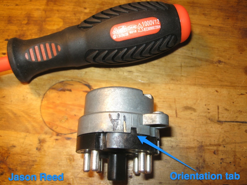

1. Mark the case so you can align it correctly later during reassembly:
1 Clocking marks.jpg (176.09 KiB) Viewed 2411 times
2.There is a tab on the side that must fit into the slot on the metal case:
2 Orientation tab on side.jpg (184.33 KiB) Viewed 2411 times

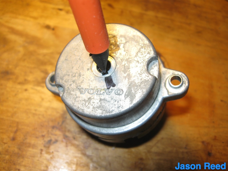

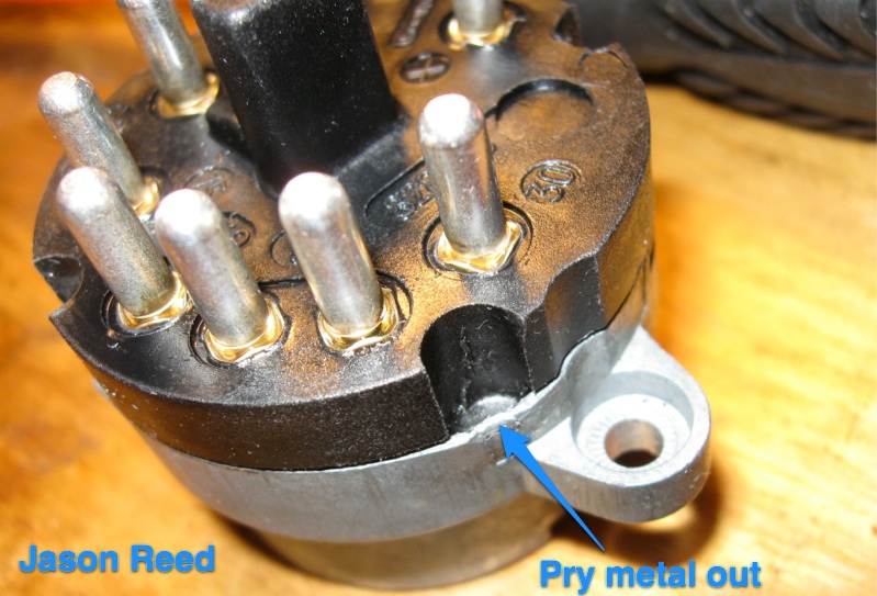

3. Pry out all four metal tabs using a narrow flat blade screwdriver:
3 Pry out metal tabs.jpg (178.43 KiB) Viewed 2411 times

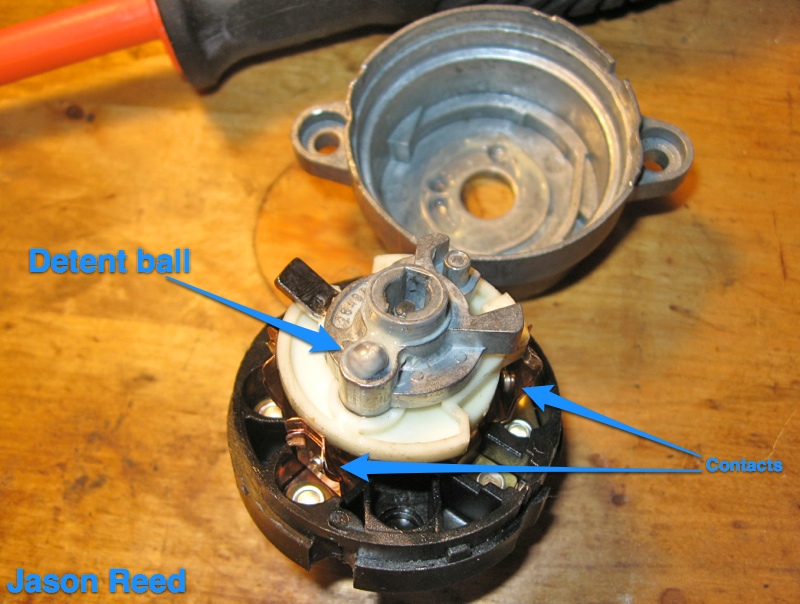

4. Lift off metal case to reveal inside of switch:
4 Inside of switch.jpg (180.74 KiB) Viewed 2411 times

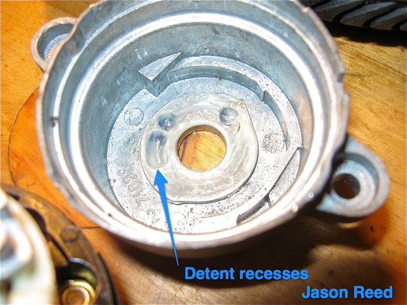

5. Check the detents for the ball in the lid of the case. You may need to clean up and add grease:
5 Recesses for ball.jpg (234.28 KiB) Viewed 2411 times

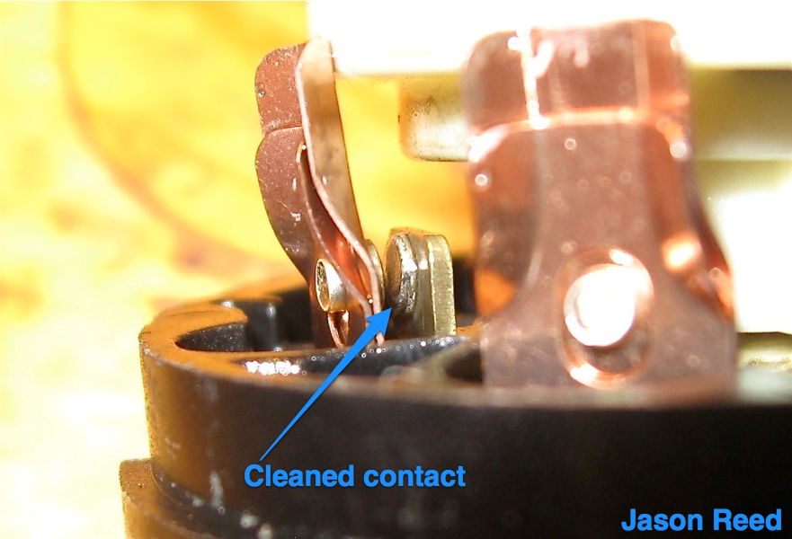

6. Spray contact cleaner on the contacts. This picture shows the dirtiest contact, with the CRC 2-26 cleaner still on it:
5 Contact close up.jpg (165.49 KiB) Viewed 2411 times
7. Wipe the contact with a lint free cloth to remove build up and excess cleaning fluid:
6 Cleaned contact surface.jpg (149.75 KiB) Viewed 2411 times
