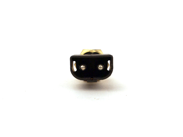

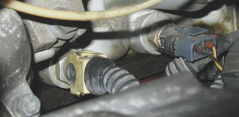

Now, let's get your car fixed. What is your engine displacement? That might make a difference in searching for images of the connector.
A Google image search for "volvo 940 ect sensor" shows these, among many others.
I haven't read the associated pages, one of which is here at MVS, so please take these images with a grain of salt. I haven't worked on any RWD Volvo, so this info isn't vetted.

Thanks for the images. It certainly helps altough I cannot easily figure out how I should disconnect it. If I was more certain that it is the ECT, I'd simply cut the cable.
It's a 2.3 liter engine btw. Today I'll try to get a clearer view by using a mirror or maybe my smartphone camera.

I did it! Turned out I had to press a metal clamp from below. Easy if you know what to do.
I'll open a new topic regarding my findings. Thanks for the cooperation!
