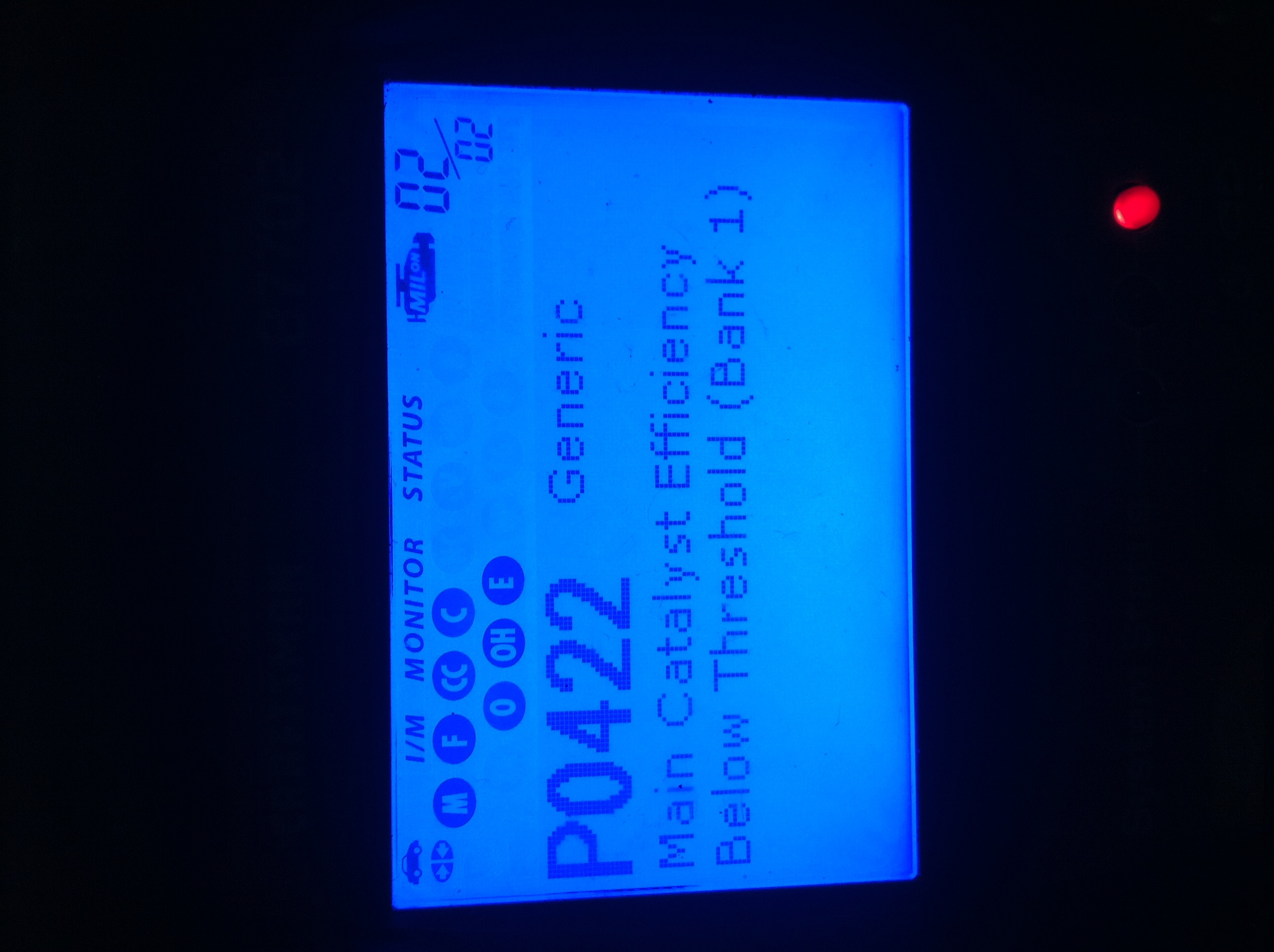

I scanned my OBD again today and code P0422 popped up. Let me give you some data on what happened this week. Changed my coolant temp sensor, so i took off my intake manifold and noticed fuel vapor/leak from some where. Bill from fcpeuro.com said it has to be the fuel pressure regulator on the fuel rail because thats the only part that would dispense fuel in that area. I took off the vacuum side of the fuel regulator while vehicle was on and no fuel vapor/leak. Hmm.... Ok what now ?
