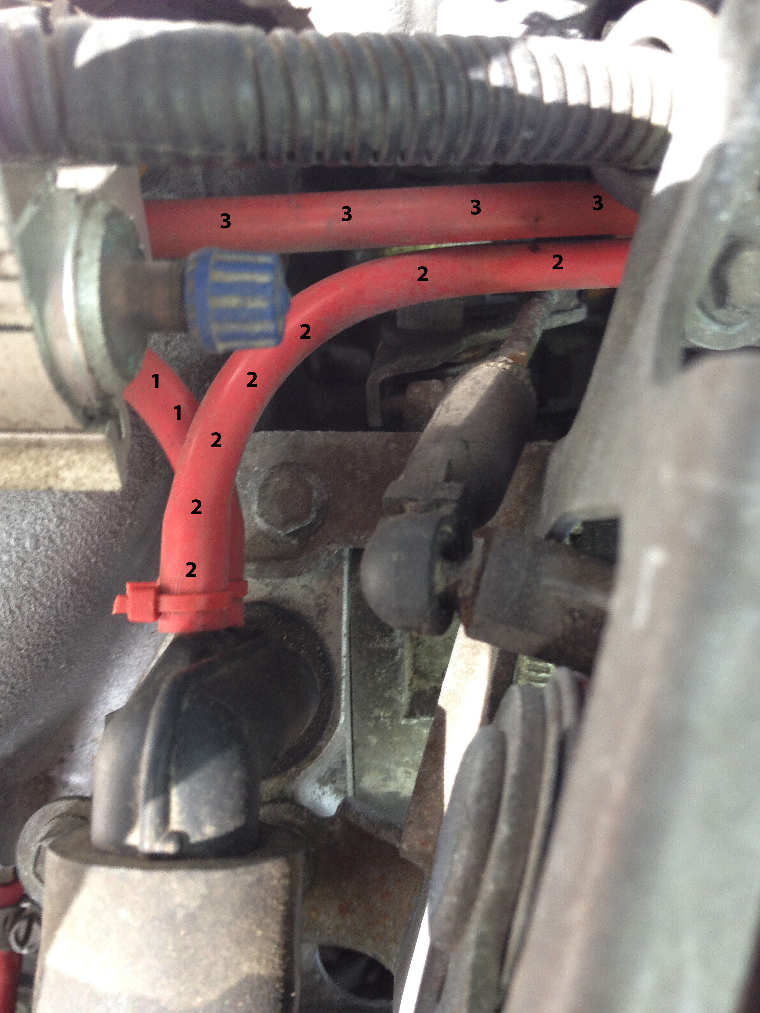

1 - vacuum tree to the fuel pressure regulator (FPR)
2 - vacuum tree to the airbox cover, upper nipple

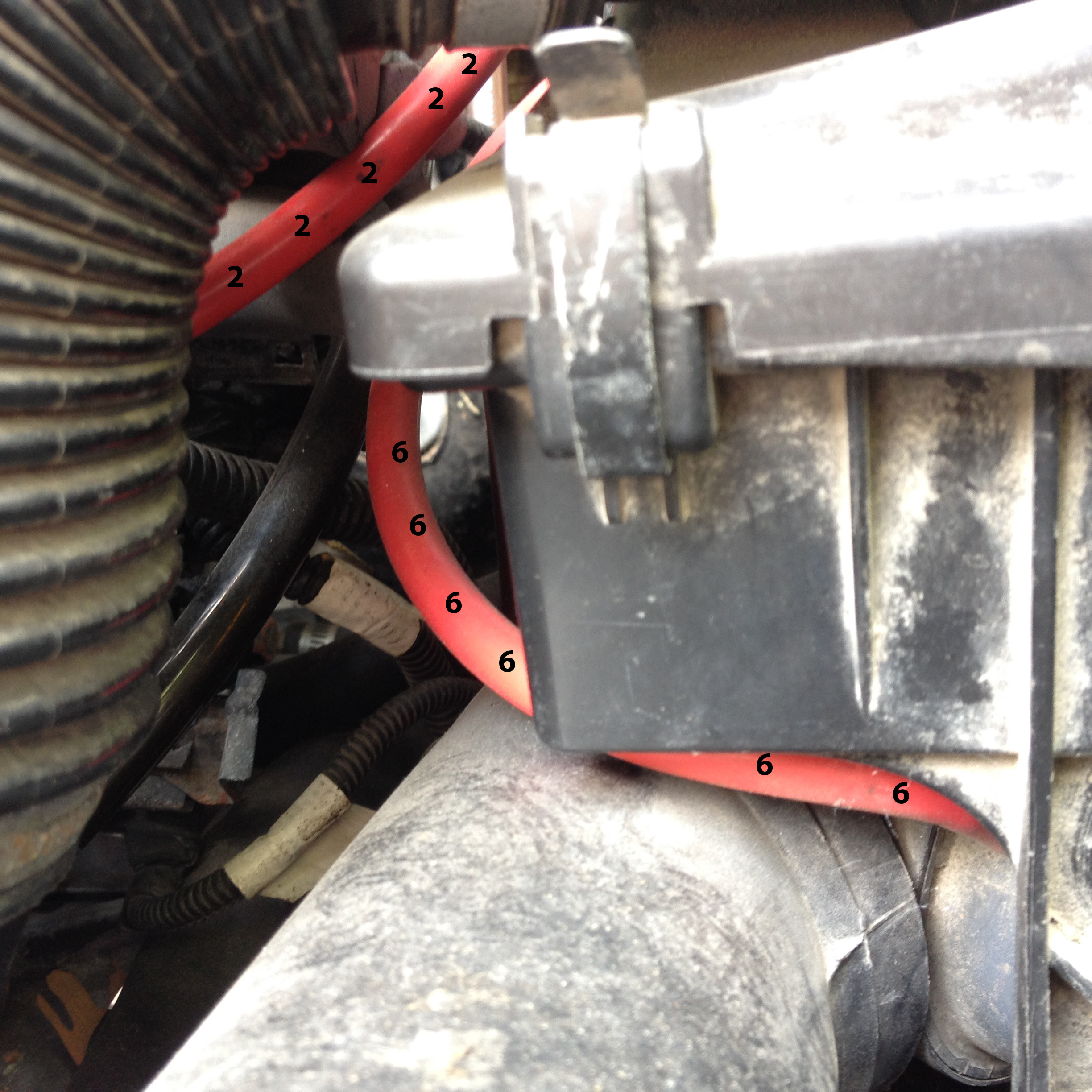

6 - airbox cover, lower nipple, to the bottom half of the airbox

Start with the vacuum tree, note that three ports/nipples are capped and two have vac lines on them (lines 1 and 2):
Where line 1 attaches to the FPR, is nearby to one end of line 3:

Line 2 runs from the tree over to the top of the air box, where we also get a look at line 6 that goes from the air box top around to the air box bottom:
