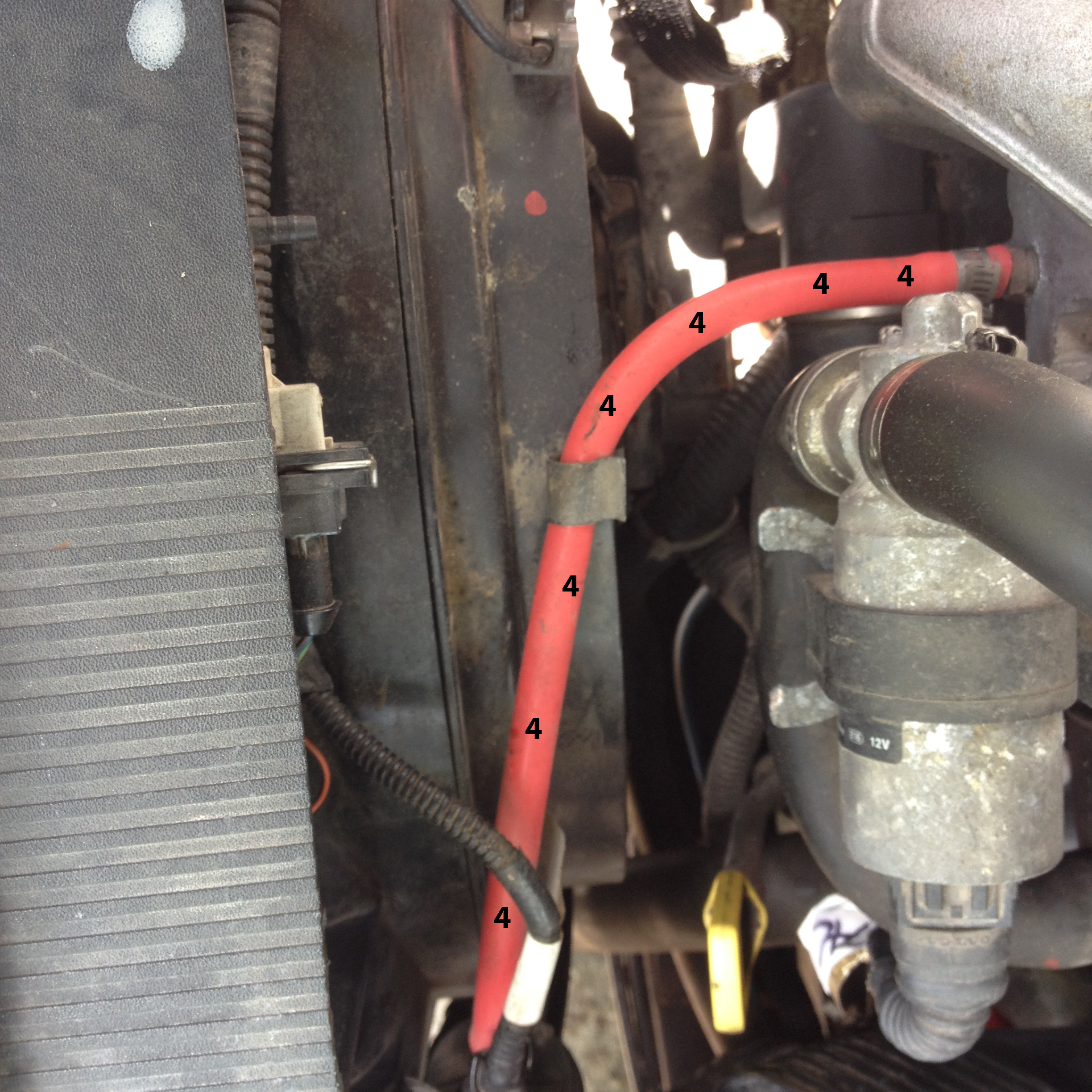

From directly overhead you can again see line 4, it starts at a nipple on the intake and heads to the radiator fan shroud where is connects to a purge valve:
line 4 from intake
line 4 from intake
line 4 at the purge valve
Note that the purge valve can be round or square, this car has the round type. And then off the bottom of the purge valve we have line 5, I do not have documentation of the other end of line 5 at the charcoal canister:
