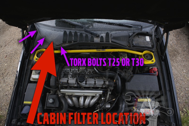

It could be your cabin filter...

I put in a cabin air filter this spring - there hadn't been one previously. (the car was new to me last winter). I cleaned out around the air intake at that point - it wasn't that bad surprisingly. I'll check it though, for the smell.
This wouldn't explain the fact that no water ever drains out under the car. Hmmmm.

phils94850 wrote:It could be your cabin filter...
This.
It's a few T25 or T30 bolts and you're in. Sometimes the filters can be cleaned, sometimes they're just done and you need to get a new one.
[Ooops, I got this post in too late. Seems you're familiar with the location and access.]
Also -> Amazon link

There's also a drain near the third arrow (l-r) in the pic above.

The hard surface I hit was about a foot up into the drain, which seemed to be all the way up the hose.
I'll check out the drain from the wiper area, but I don't think there's a problem there, since that wouldn't be affected by running the AC...
