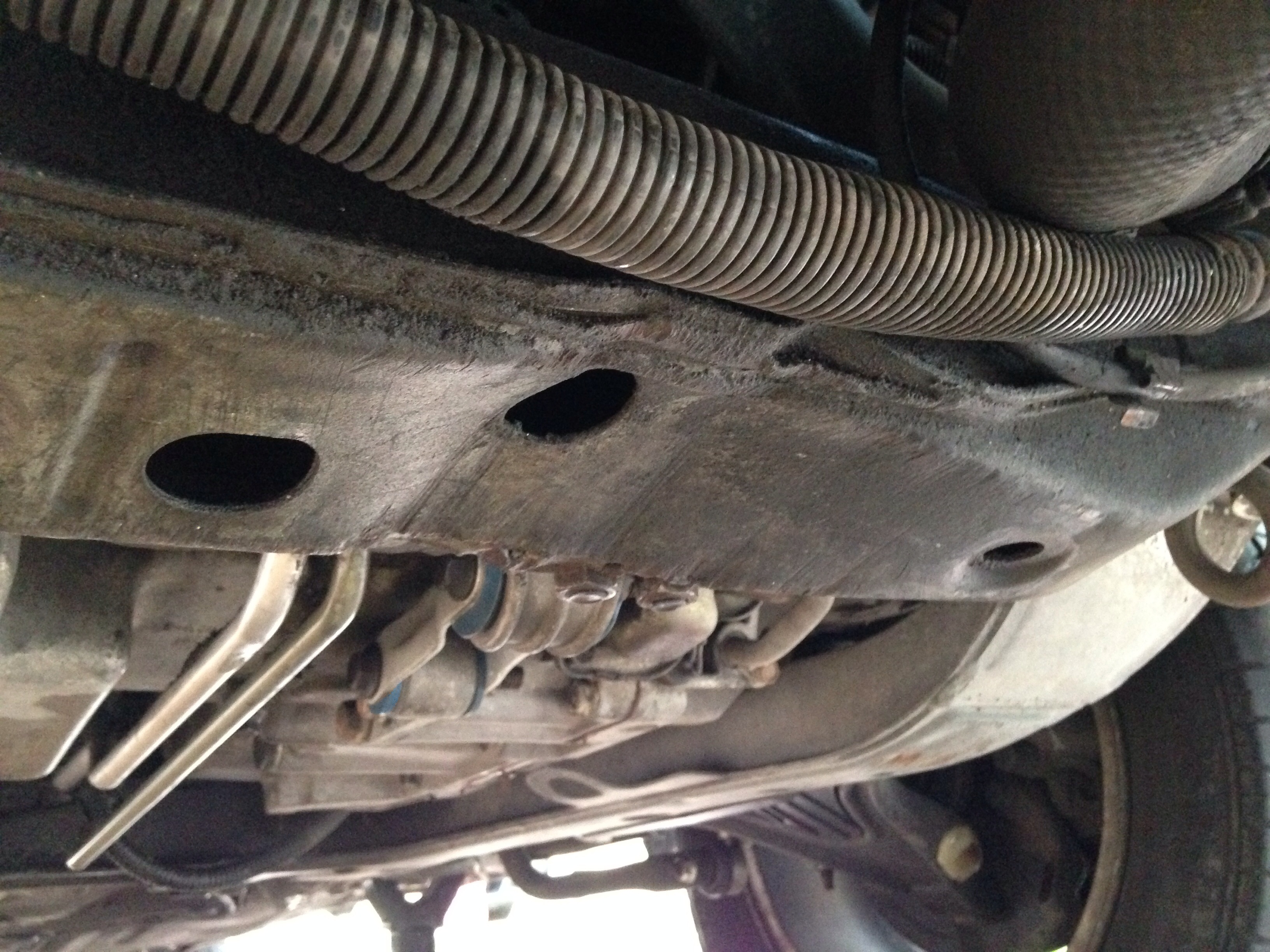

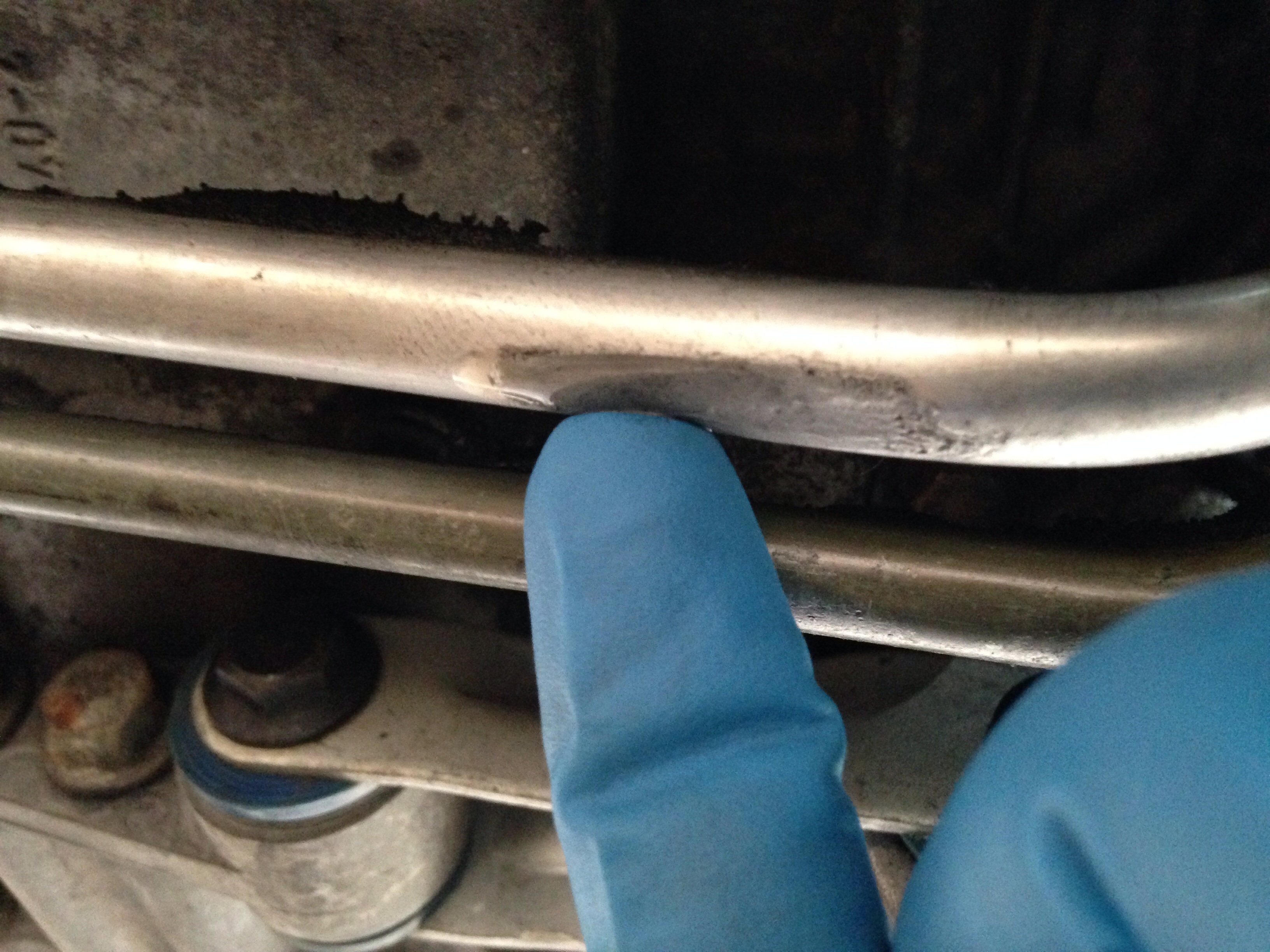

Noticed P/S fluid dripping on the bottom of the car. Found the culprit. I admit my front struts are SHOT and when I'm on NYC uneven roads my vehicle bottoms out which sends a Big Bang thru my dash and front. Is there anything I can purchase to protect my P/S lines at the bottom ?
Subframe damage

P/S line cut from concrete. Any way I can quick fix this ?

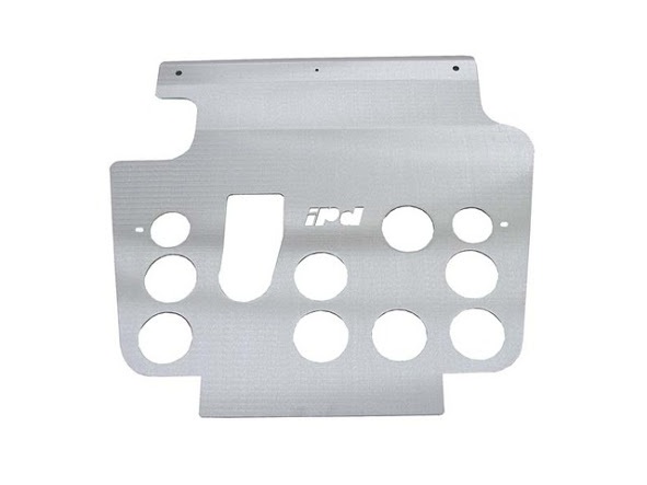

Maybe this from IPD to help protect bottom

My first thought would be to replace those struts with all associated hardware, including new bump stops, before something really gets damaged.

I got this 1/8" thick steel pan from a guy over at Volvospeed a few years ago,
That's a nasty hit your subframe took! You're very lucky
