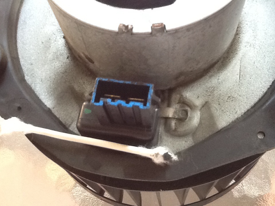

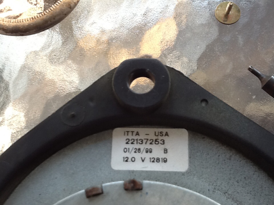

I pulled out fan and did not see any loose lugs, the plug looked to be seal as part of the motor housing. I cleaned the electrical conecter with contact cleaner and a Q tip. I cleaned off a fair amount of gunk.
Cleaned connectors with q tip

Build date 1/99
Build date 1/99
Ozark Lee
Posts: 14798
Joined: 7 September 2006
Year and Model: Many Volvos
Location: USA Midwest
Been thanked: 75 times
Post by Ozark Lee »
That blower is a bit different than the ones I've had apart. Now to think about it, I think the only ones I've been forced to deal with were on the 850s. Sorry I sent you down the wrong road. :oops:

Posts: 35282
Has thanked: 1500 times
Been thanked: 3812 times
No resistor pack on the later P80s with Electronic climate control. It's a transistor pack taking variable current from the control unit.
Mine packed up like this and I finally replaced the fan after three cleanings in as many months
