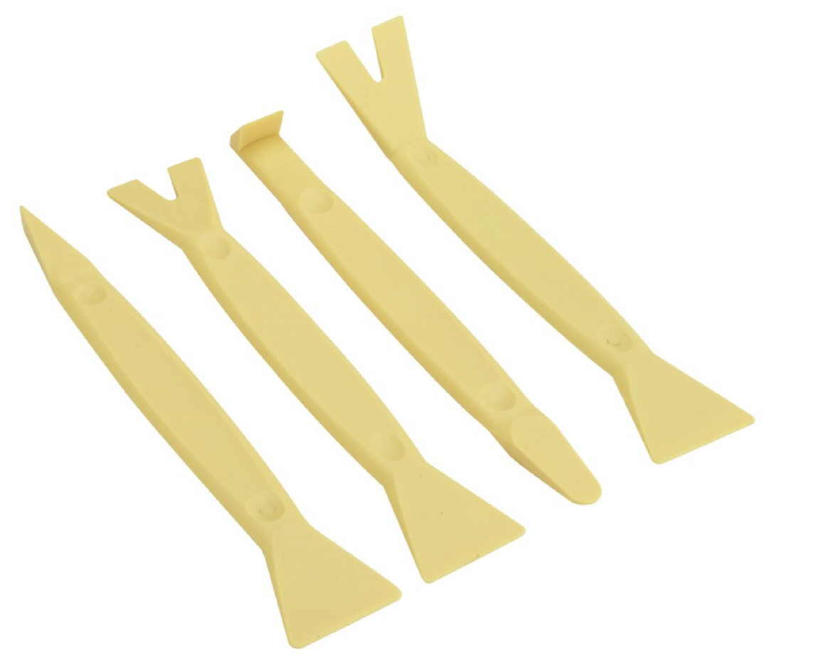

To replace the axle seal I used a 1 1/2" PVC connector too. That worked pretty well but you have to be careful to start out straight and tap it in straight to keep it straight. To remove the old seal, I used a nylon pry bar, the second one from the right in the picture below. This set was ~$5 at Harbor Freight. I also used the pry bar to straighten the new seal while I was trying to drive it in with the PVC connector.
