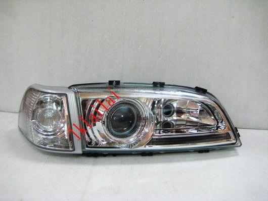

hi is this projector headlights adjusted left and right?How can I do it? thanks

With the hood open and the lights installed, there is an adjusting gear on the top of the housing. Vertical adjustment is done using a white cap/screw assembly behind the center of the light in the light/frame mounting.

Does adjustment is done here? red circle?

left and right adjustment?

yes, check out this thread
https://www.matthewsvolvosite.com/forums ... =1&t=66051
