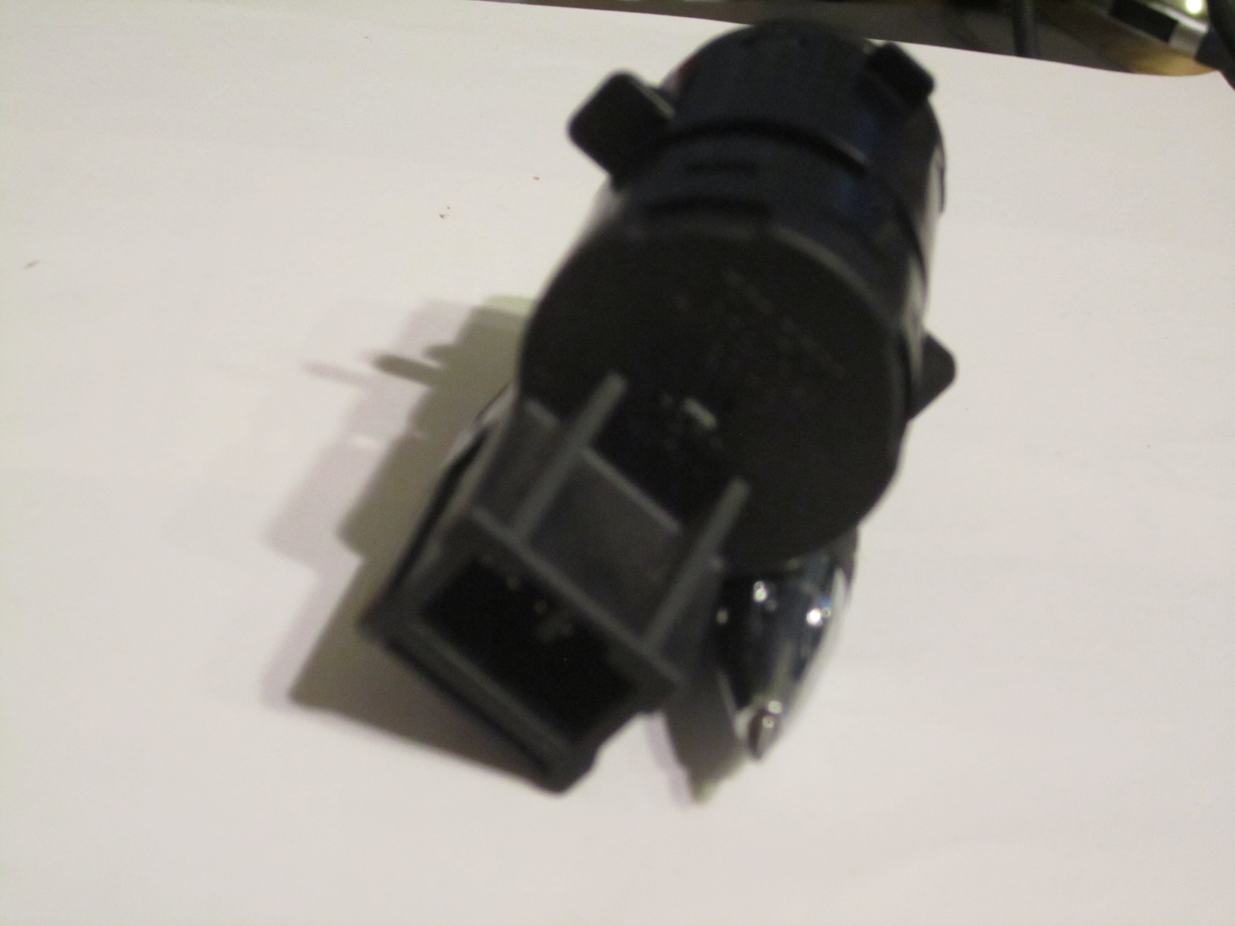

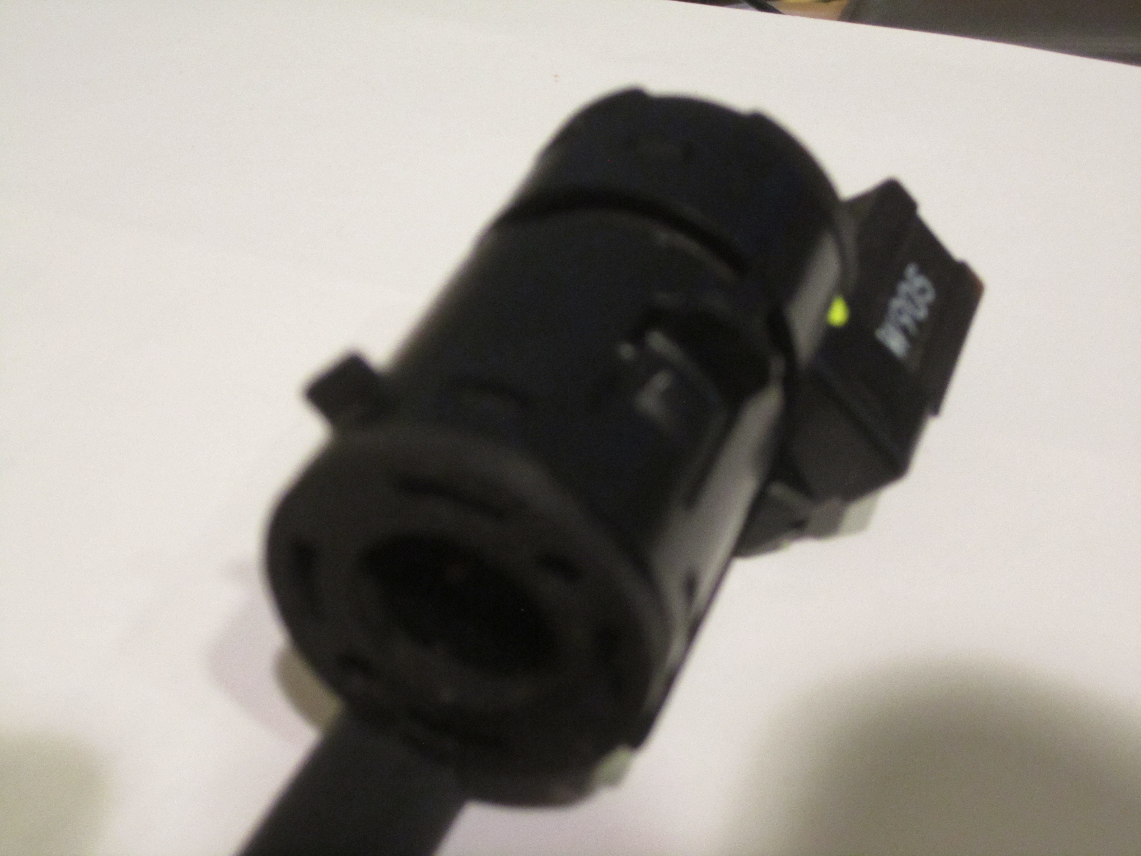

Sorry for the poor picture quality, but the cabin temp control looks like this:
Careful when removing this unit from behind the dash, as having been there for some time the rubber front cap tends to stick to the rear of the locating hole and then fall down behind the dash.
Remove the rubber cap and then you can see the fan blades and the temperature pin head on 2 wires.
Clean the unit carefully with IPA (rubbing alcohol) and cotton buds and a small artists brush. Finally squirt a little silicon oil at the base of the fan blades.
To remove from behind the dash, you need to push in the 2 'lugs/ears' on either side at the front of the unit. One is at 2pm and the other at 8pm when viewed from the front of the dash.
Neil
Neil
