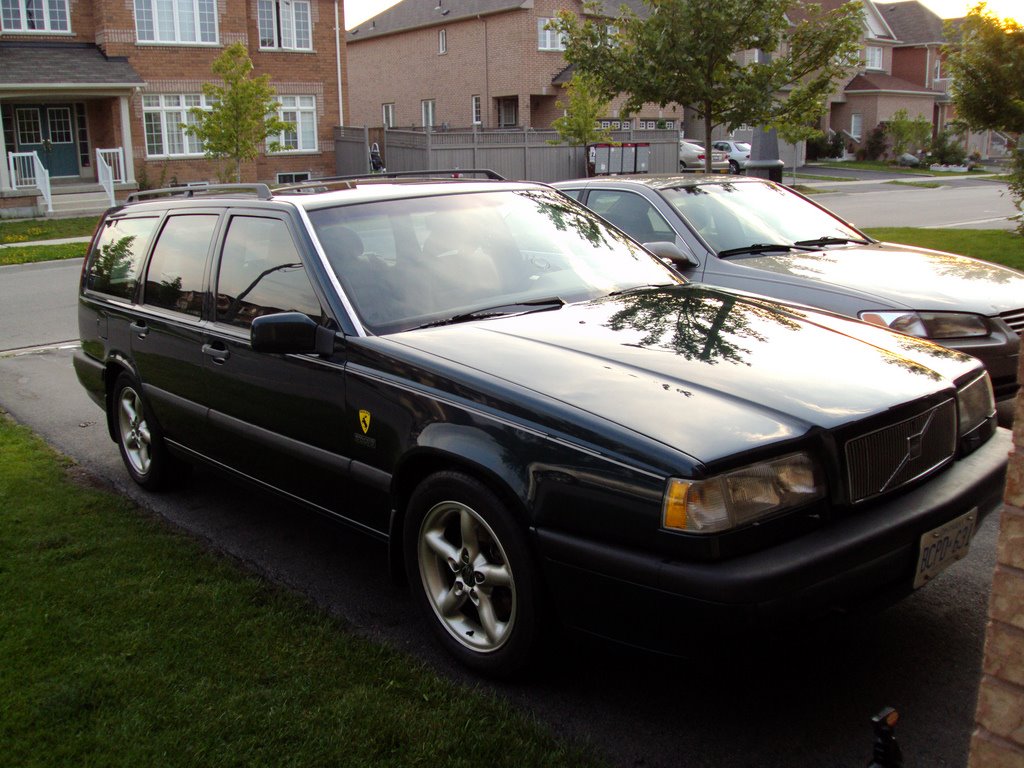

I'm thinking of swapping some cleaner 15 or 16 inch wheels out for something nicer.
Will wheels from later Volvos fit the 850?
Cost-effective suggestions?
96 850 Cost effective suggestions to update 850 wheels?
