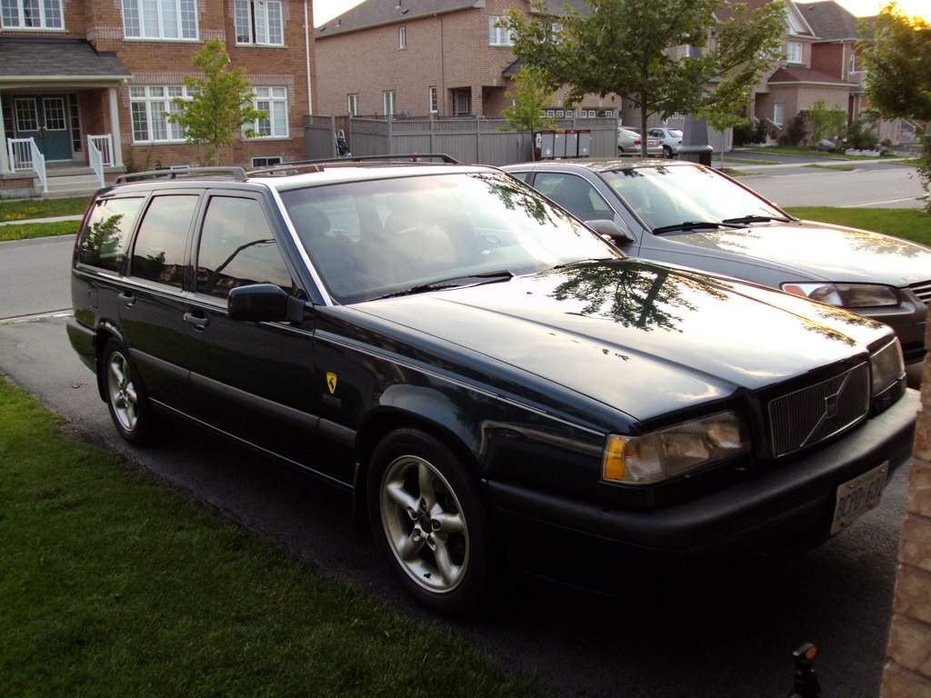

Had these wheels on my 850 turbo (best Volvo Ive owned in the past). they come on the 850 platinum edition as well as the 850 awd models
- volvo850.jpg (159.4 KiB) Viewed 3114 times
