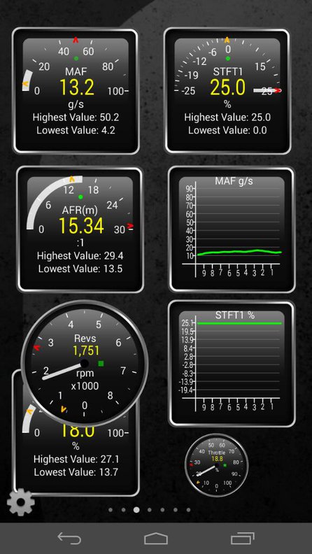

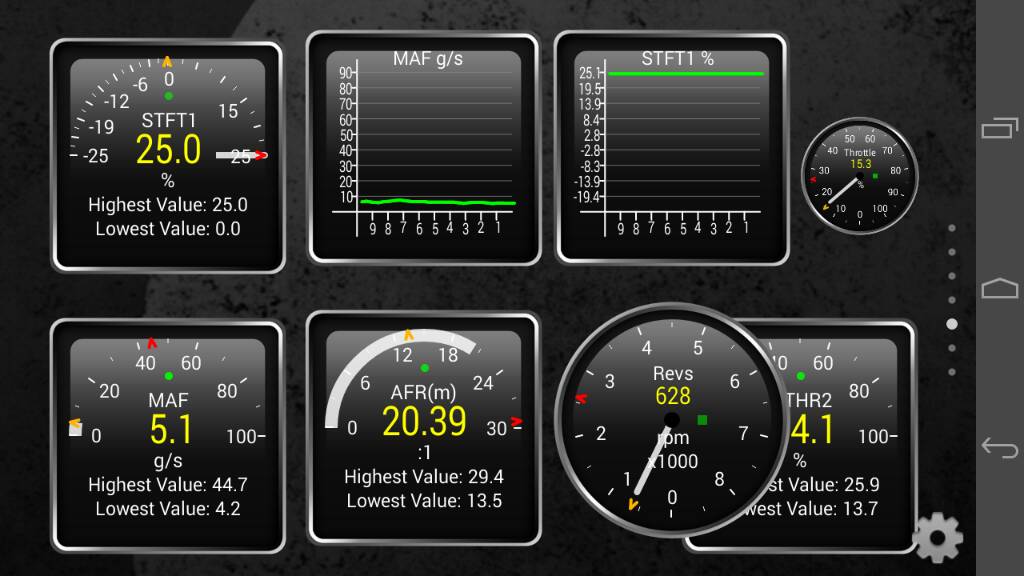

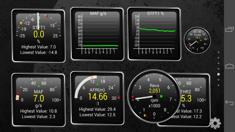

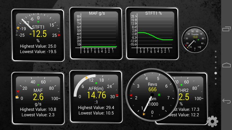

Captured these bad stft cases. It seems the ecm decided to hold stft. The car is cold. One thing i should mention is when start, engine did not idle at high speed as it normally does. Noticed this several times, each time, ECM is likely to set 0101 code.
BTW, when STFT started moving, check engine light went on. Codes are P0101 and P2188.

With engine cold the ecu will enrich the mixture if coolant sensor operates correctly. When that happens the stft will show positive like your reading. I would try cleaning the throttle body even though your car is 2007 but you may have high miles? Again, I'd also check connectors for maf and etm.
