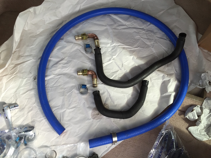

OK, I may has well post the pictures of the hoses I created.

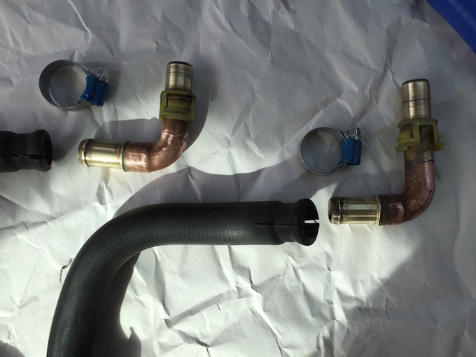

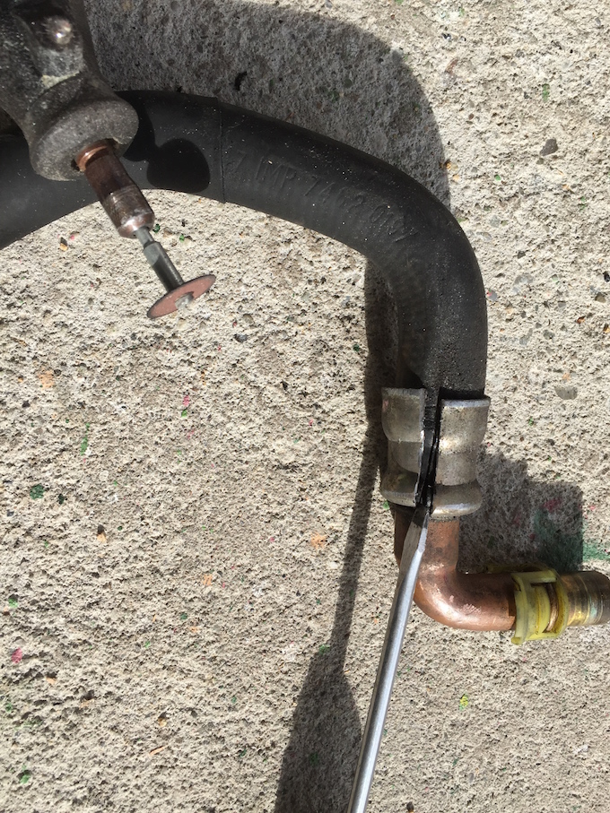

First, I took a dremel and cut a slot in the crimp from the original hose. I'm going to use the brass ends on the new hoses. After cutting a slot, I used a screwdriver to pry it apart. One of the hosed was fused onto the brass. I had to scrape it off.
After cutting off both hoses and cleaning up the ends, I approximated the silicon tube length I would need and cut the shorter one first.
Here's a close up of the ends and the new clamps I got. The clamps are blue so I thought it would be a nice complement to the hose. I cleaned up the ends with some 400 grit sandpaper.
WARNING - note that I am using the old yellow clips off my car. I order new clips from IPDUSA, but they were not the same! I tried to put them in several times at different angles and couldn't get them to fit. Finally in a fit or frustration, I put the old ones back on. It was then that I noticed that the replacements they sent me were taller than the original clips! What a pain.

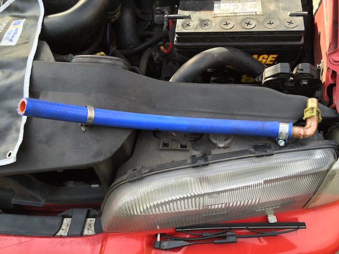

After mounting the end on the hose, here's what we have before I snake it through. Attaching the end without the brass fitting to the metal coolant line was a major PITA.

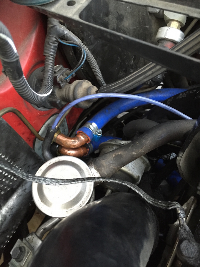

Here's what it looks like after both hoses are attached. If I recall, the factory hoses point at the 6 o'clock position whereas these new hoses point at 3 o'clock. This was due to the routing to prevent kinks.

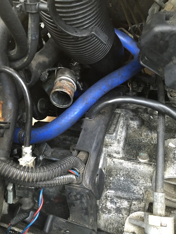

The route I used for the inlet hose (longer one) was longer than factory to prevent any kinks. The factory hose goes under the air inlet as it's got a tight molded bend. As you can see, I went around the air inlet. There was plenty of space.

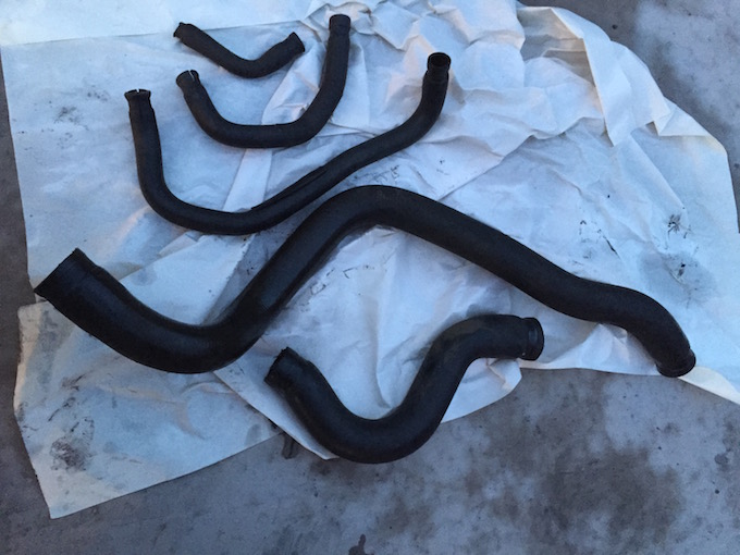

So these were the hoses I replaced today. It was interesting to note their condition in each case.
Here's a few thoughts form top to bottom.
* Turbo coolant hose - definitely was ready to go. I pulled on the hose trying to separate it from the metal coolant line and the hose just split and broke off! Although not leaking, it was not long for this world.
* Heater outlet hose - replaced with blue silicon. Attaching to metal coolant line was major PITA. The original was a bit swollen, but didn't seem to have obvious areas that were emminent for failure.
* Heater inlet hose - replaced with blue silicon. This was the hose that failed and started all this mess. This hose was bulging and the end going into the engine block had a hole that was spurting coolant when under pressure.
* Lower radiator hose - the lower portion was a pain to reconnect. It's tight in there. The original hose was probably serviceable. There was no obvious areas of stress or failure on the hose. I replaced it anyway since it's been a while.
* Upper radiator hose - Super easy to change. The original seemed in great shape. I probably didn't need to replace this one.

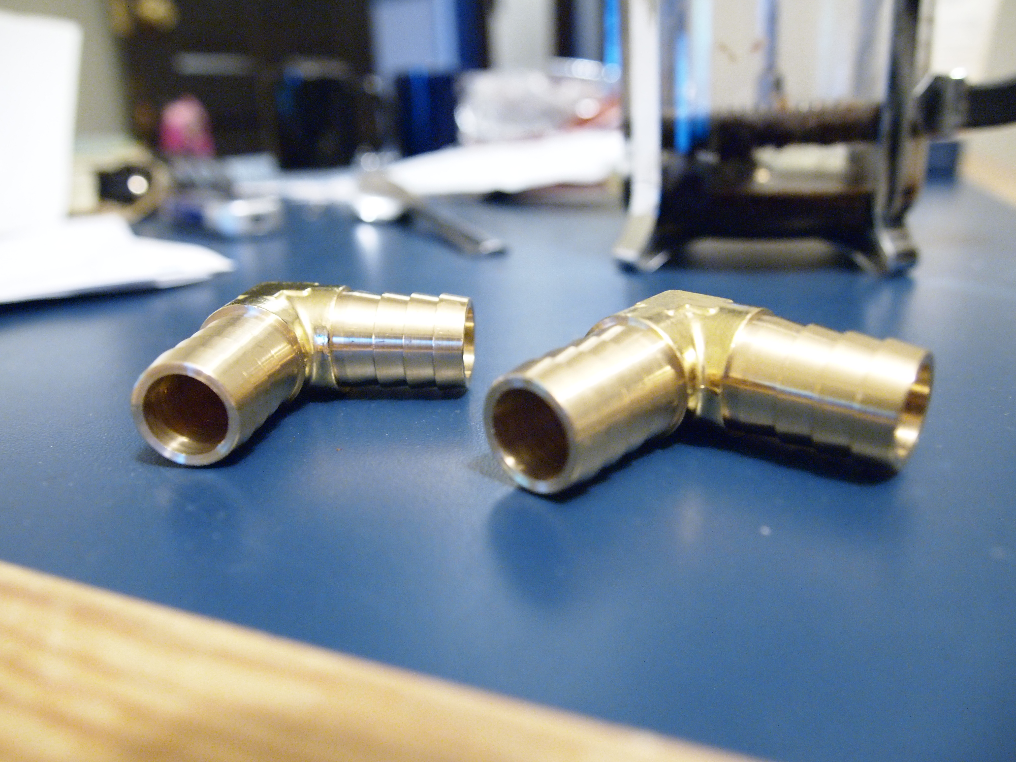

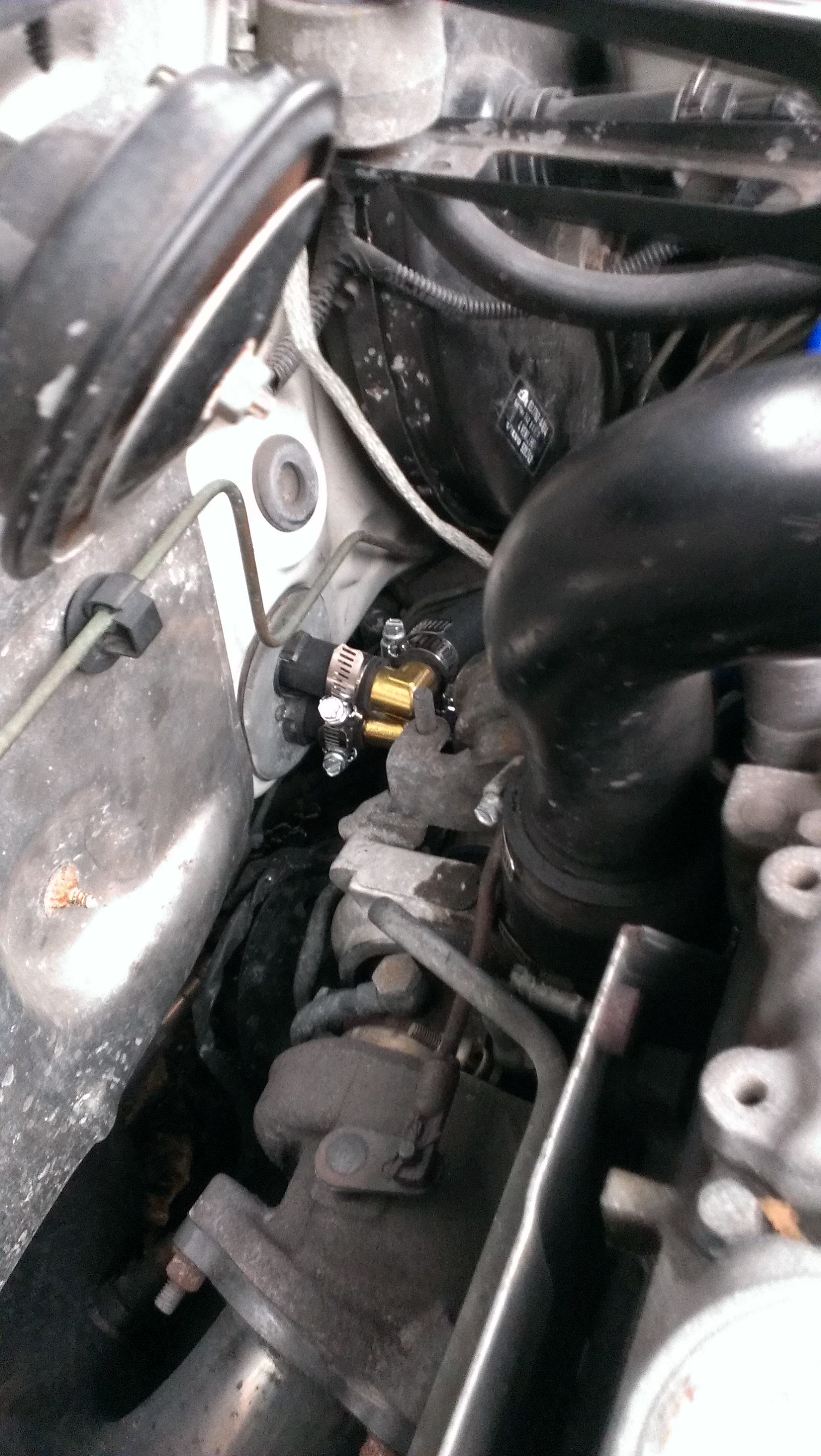

I hacksawed off the aluminum tubes to the firewall coupling and cleaned up the edge with a Dremel tool. 5/8" heater hose slipped over the pipe and was clamped in place.
I got these beauties in the mail a few days ago from McMaster-Carr (item 91355K55, 5/8" barbed hose elbows).
In the engine bay:
The system uses a total of eight hose clamps: two at the engine, four at the firewall junction, and two more at the heater core. Except for the two at the block, all are fairly easily accessible.
This is probably overkill, but I had already ordered the elbows by the time I was told the factory elbows were safely reusable, and they felt nice in my hands, which is obviously the best way to make decisions about what parts go in your cooling system.
Everything works nicely. It's nice to have heat again.
