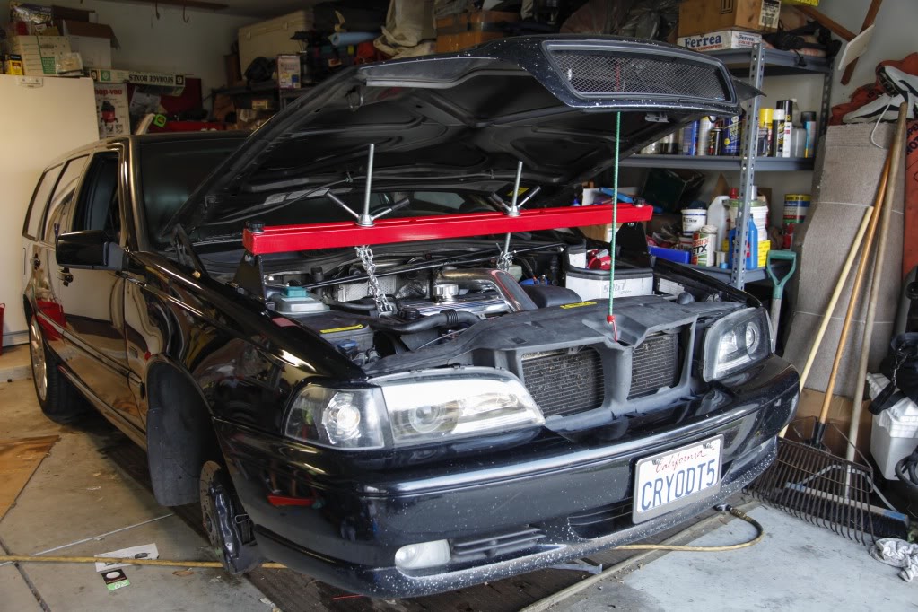

Anyone have an instructional on how to remove the subframe? It looks like 3 motor mounts, 1 transmission torque mount, 2 lower control arms & then i have to suspend the engine/tranny from up top. Am i missing anything else ?

Steering rack bolts through the subframe need to be removed unless you want to pull the steering rack off with the subframe and deal with swapping the rack later.
If you want to drop the rack this would mean tie rods need to come off the steering knuckles. Hydraulics connected to rack need to be disconnected as well as the steering shaft.
