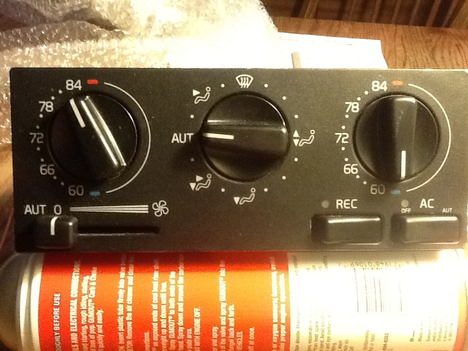

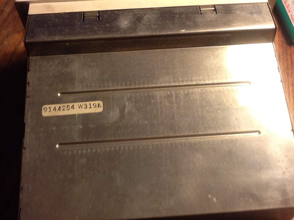

Welcome to the forum, sandytrean. These are really easy to swap out--in fact, about the easiest thing I ever did to either of our cars. I paid roughly $75 for a used one on ebay, so would not hesitate on kahl's offer.

I'd take kahl's offer if you definitely need the unit. I'm sure the part can fail, but never had one do that. The issues I've had are usually the cabin temp sensors being seized (they clog with dirt over time) and the fan motor/resistor pack failing.
