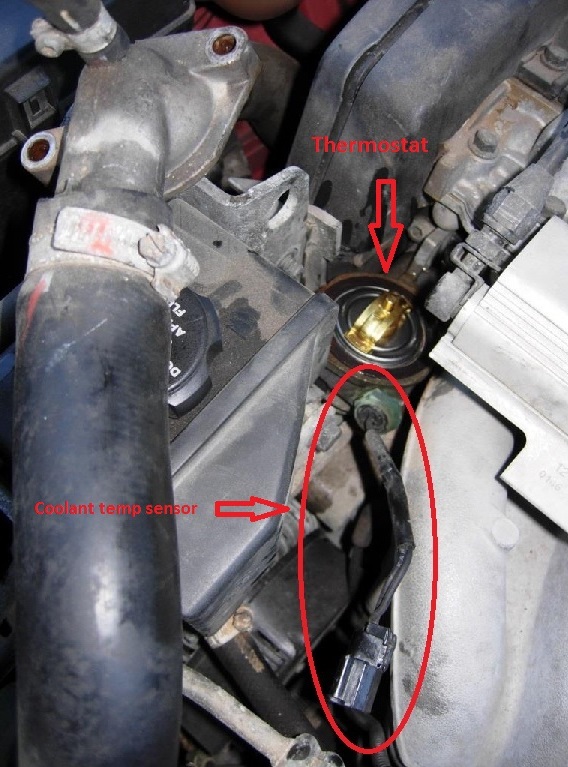

Found this pic online the entire sensor is circled in red (connector at bottom of circle):

Thanks for all the replies.
I am thinking, maybe erroneously, that the connector for the coolant temperature sensor itself is fine. My reasoning is that the car runs fine even if the coolant temperature gauge reads below the scale. i.e. I am thinking that the sensor sends the correct resistance amount to the ECU but it is a signal coming out of the ECU is only reaching the gauge intermittently.
If the coolant temperature sensor goes directly to the gauge, then it would have to send a separate signal to the ECU or am I misunderstanding what happens. i.e. would the car run fine, once warmed up, if the coolant sensor were sending a faulty or no signal to the ECU?
I have uploaded a photo where I labeled a couple of 'connectors'/wires which I believe feed into and possibly out of the ECU.
I have labeled them A and B. My thoughts are that the one labeled A is the one which is possibly corroded.
If so, is it possible to open it up and clean it with contact cleaner? Can it be opened up with the ECU 'box' in place? i.e. it looks like there is very little room to move the connector towards the front of the car when unplugged
I have not yet tried cleaning the connector which was circled in the photo which gmh uploaded. If my reasoning is wrong, then I should go ahead and do that. Either way it shouldn't hurt.
