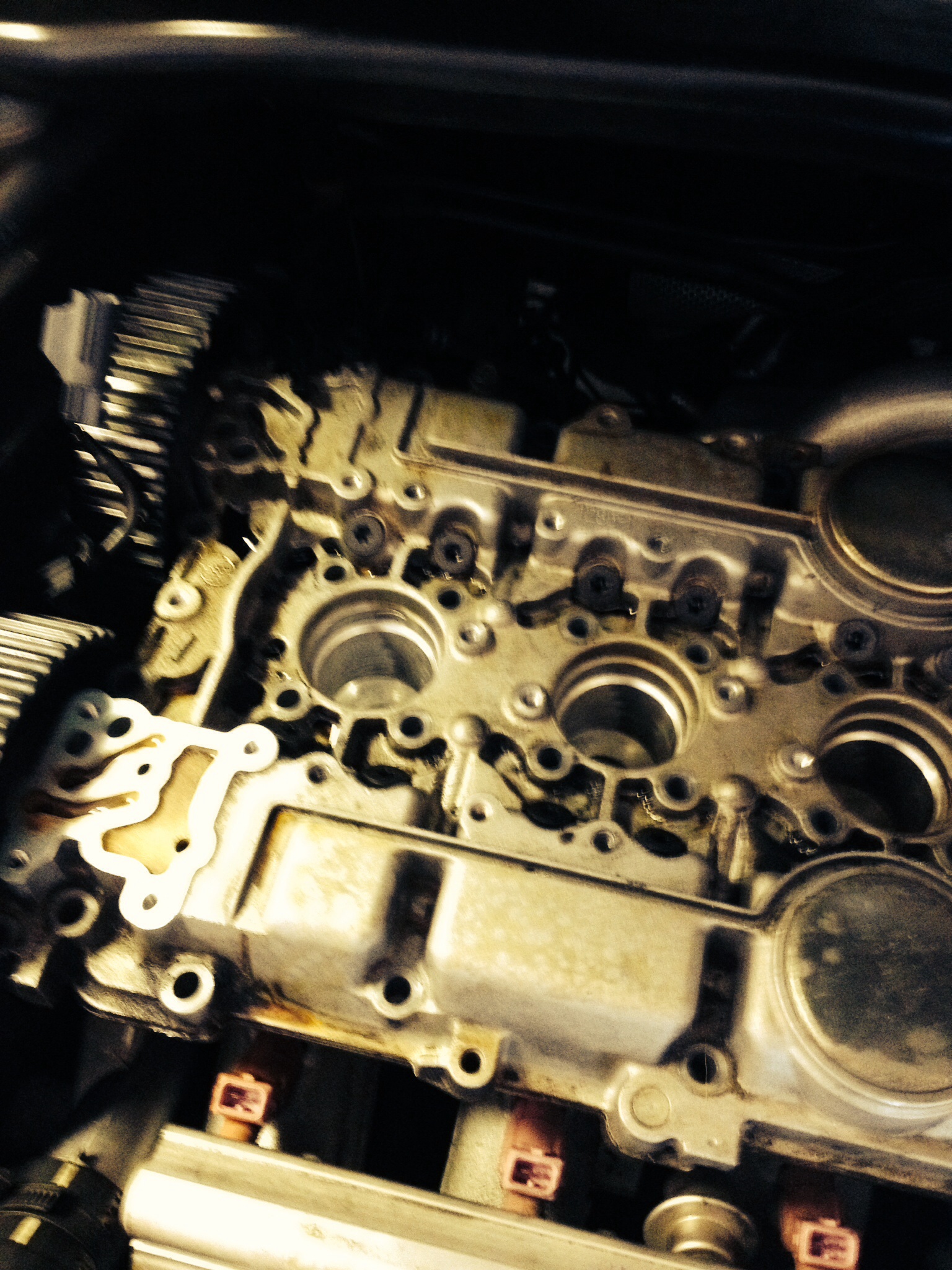

Hey everybody. New guy to Volvo here. I purchased a 2000 S80 with blown head gasket. Started working on it this morning. There is coolant in No. 4 cylinder.
I've removed all valve cover bolts except the star bolts. Do I have to remove them to get the cover off? I'm not sure it there holding the cams in place. Is there a preferred method for removing cover or should I just pry it off? I don't want to bend or break anything. Thanks for the help. This is a great site.

The "star bolts" are torx bolts that hold in the adjusting shims for the tappets. Don't disturb them.
The 46 10mm bolts will separate the two halves and expose the head bolts.
Prying, hitting with a hammer on the prying lugs and mostly cursing will get it off.
