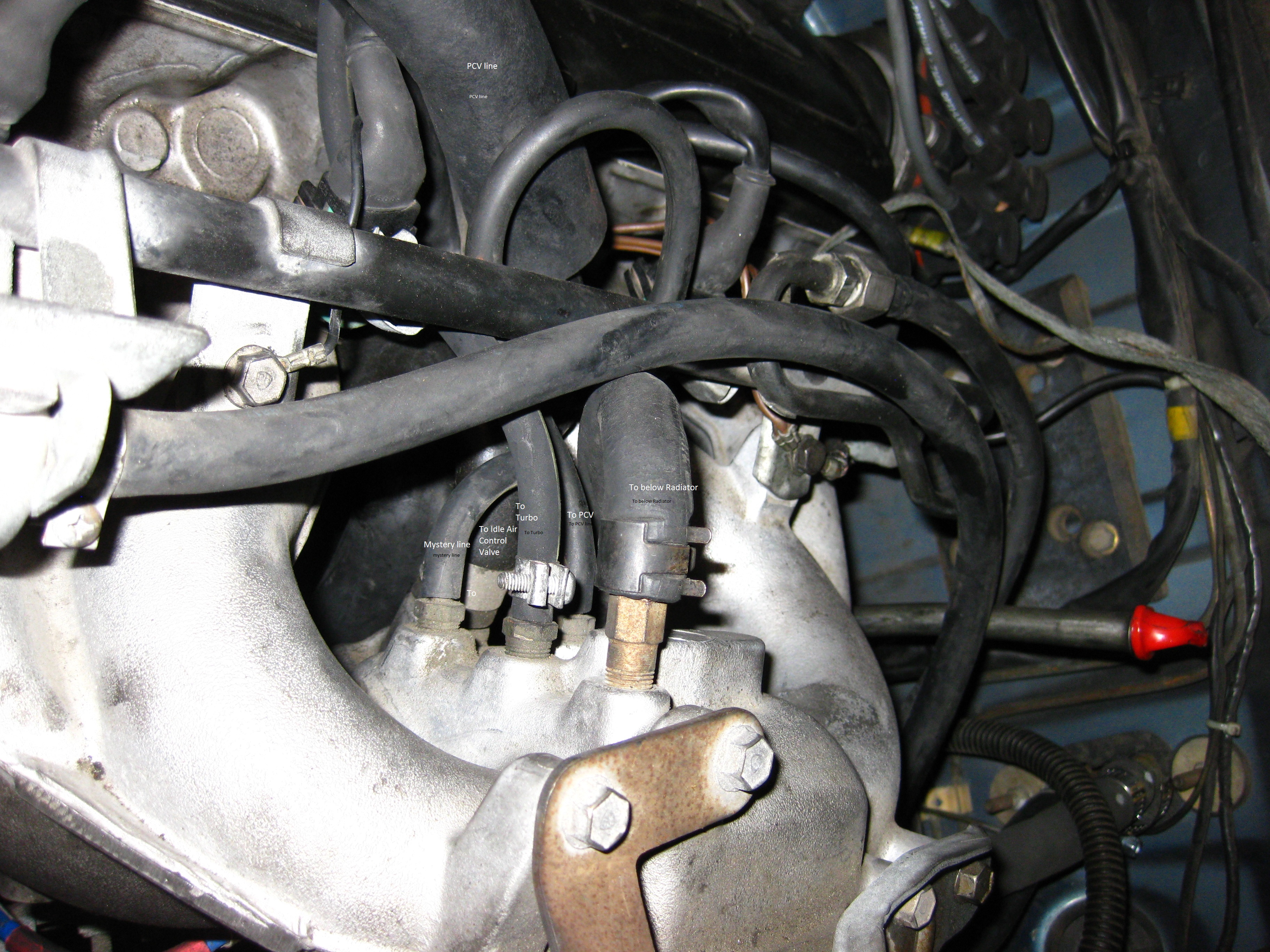

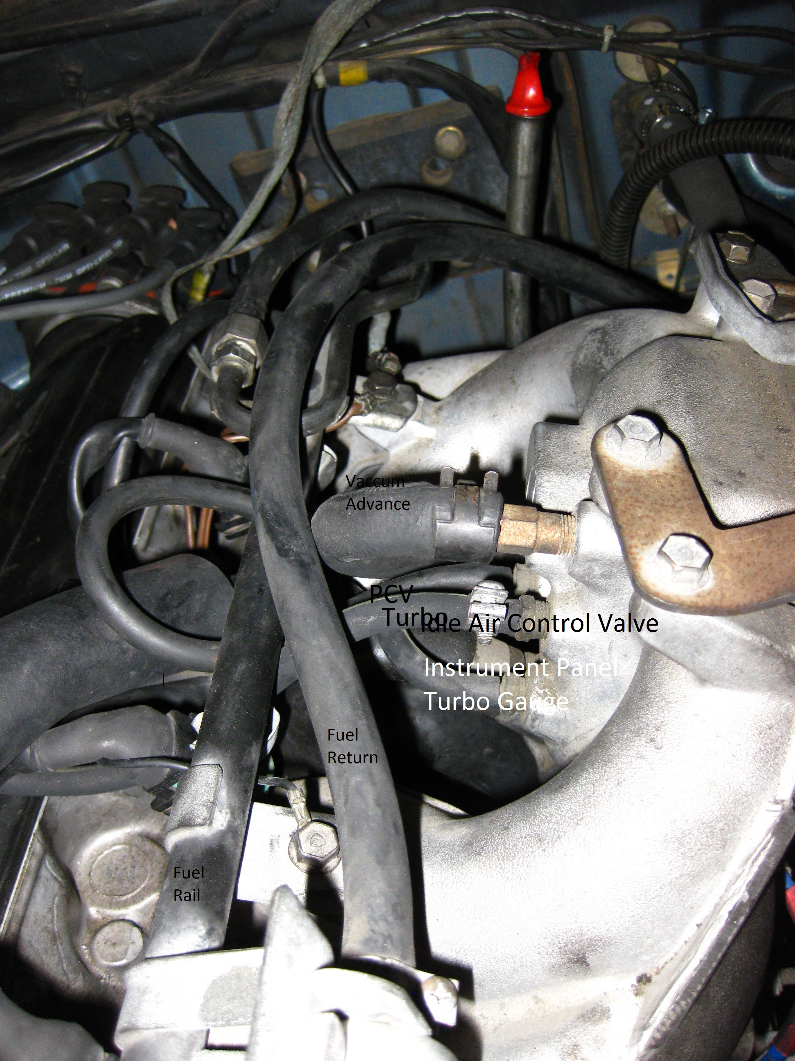

Would anyone know of a vaccum hose routing diagram for the 740 Turbo with B230FT, 4 cylinder engine?
After removing and rebuilding the engine, I am not sure whether the two hoses that come out of the firewall on the driver's side of the engine compartment connect to the manifold or the vacum pump. There is also a 4mm vaccum line comming off the intake manifold between the engine and throttle body with no obvious place to go.
The other 3 lines comming off the throttle body go to the Turbo, PCV and a large diameter line running under the radiator.[740 Int Man Vaccum lines.jpg]

Great link for hose sizing. Unfortunately, my hoses seem good, they just need to be connected or capped off because the resulting vaccum leak keeps the engine from starting.
