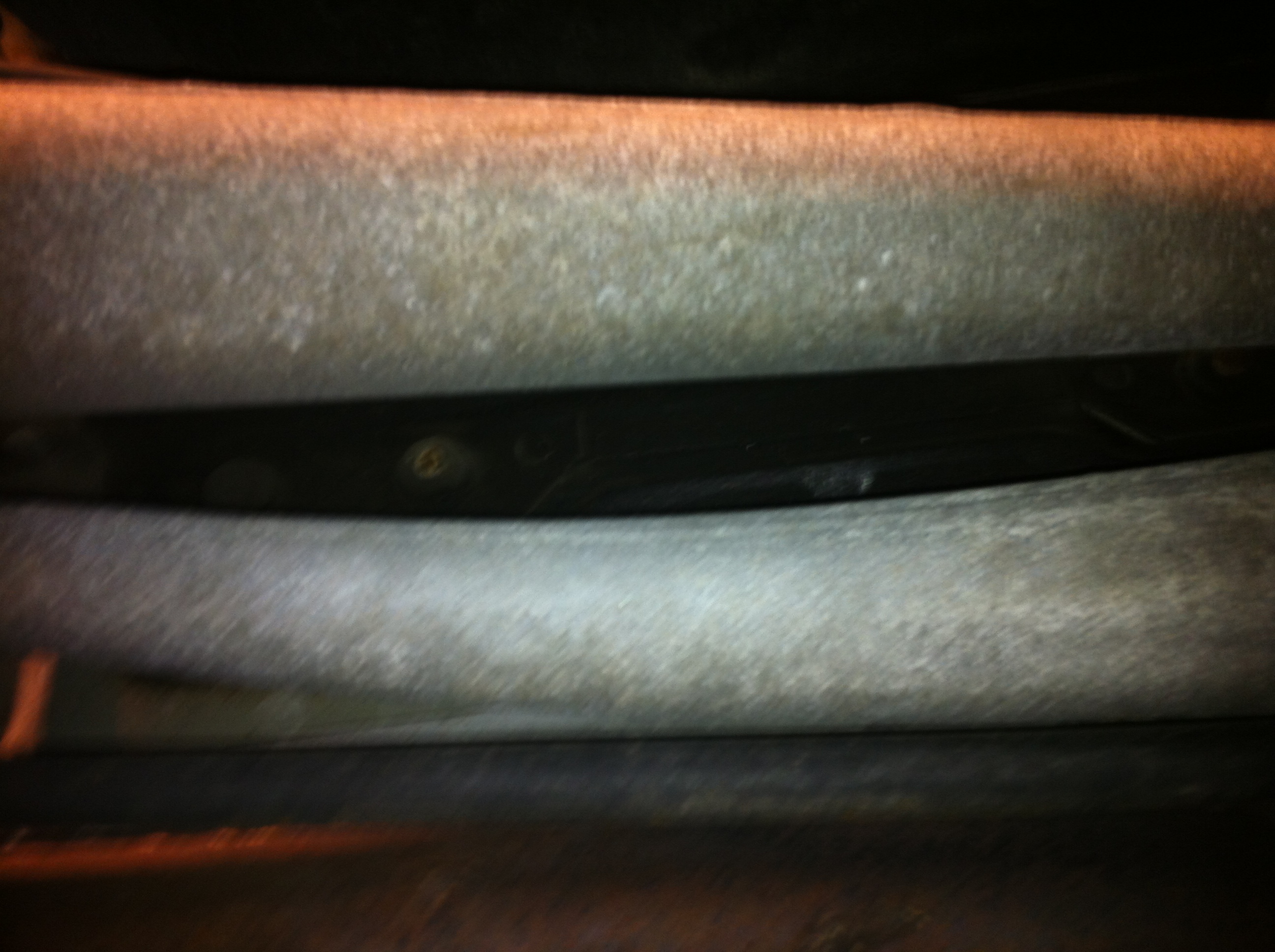

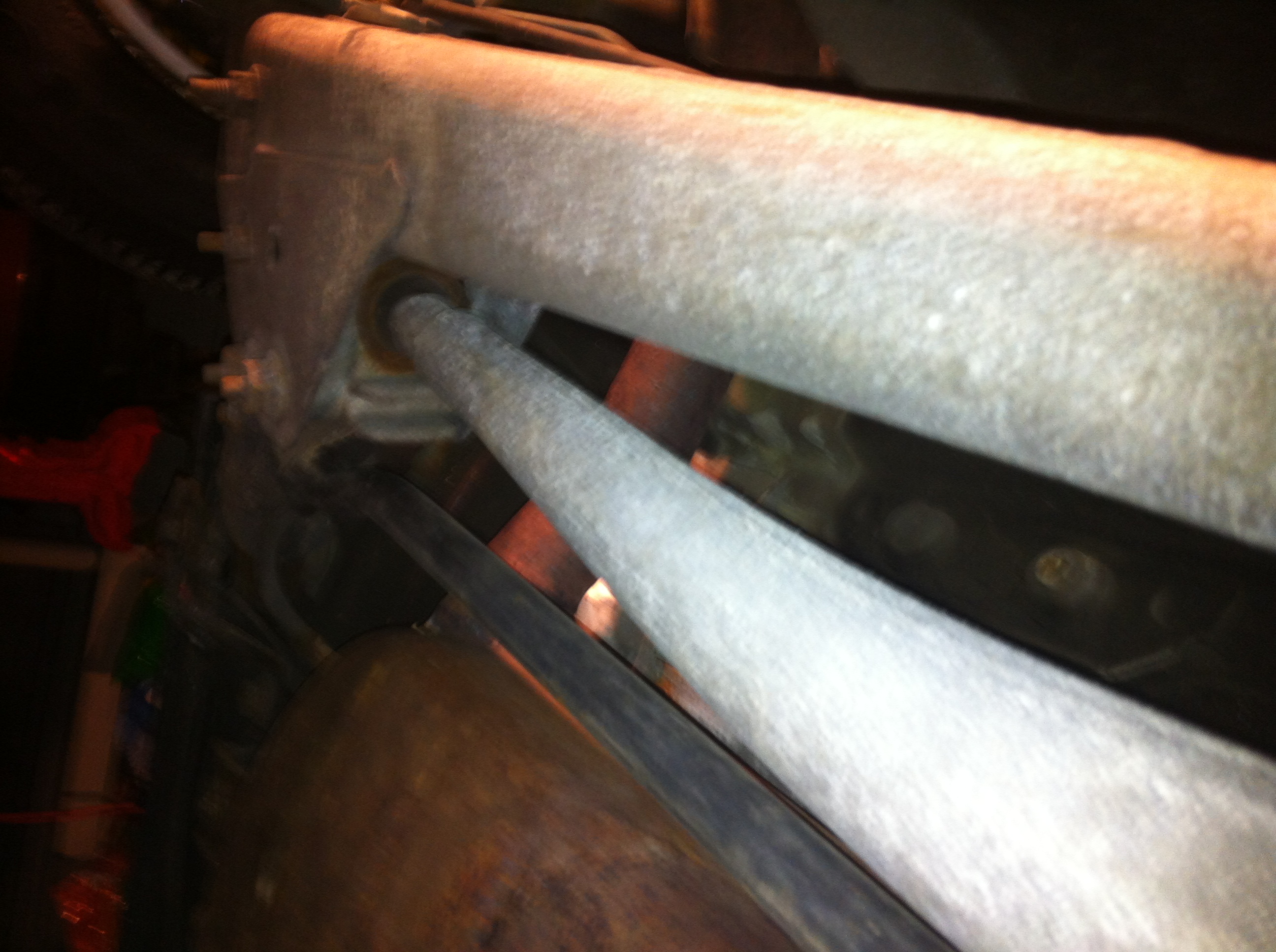

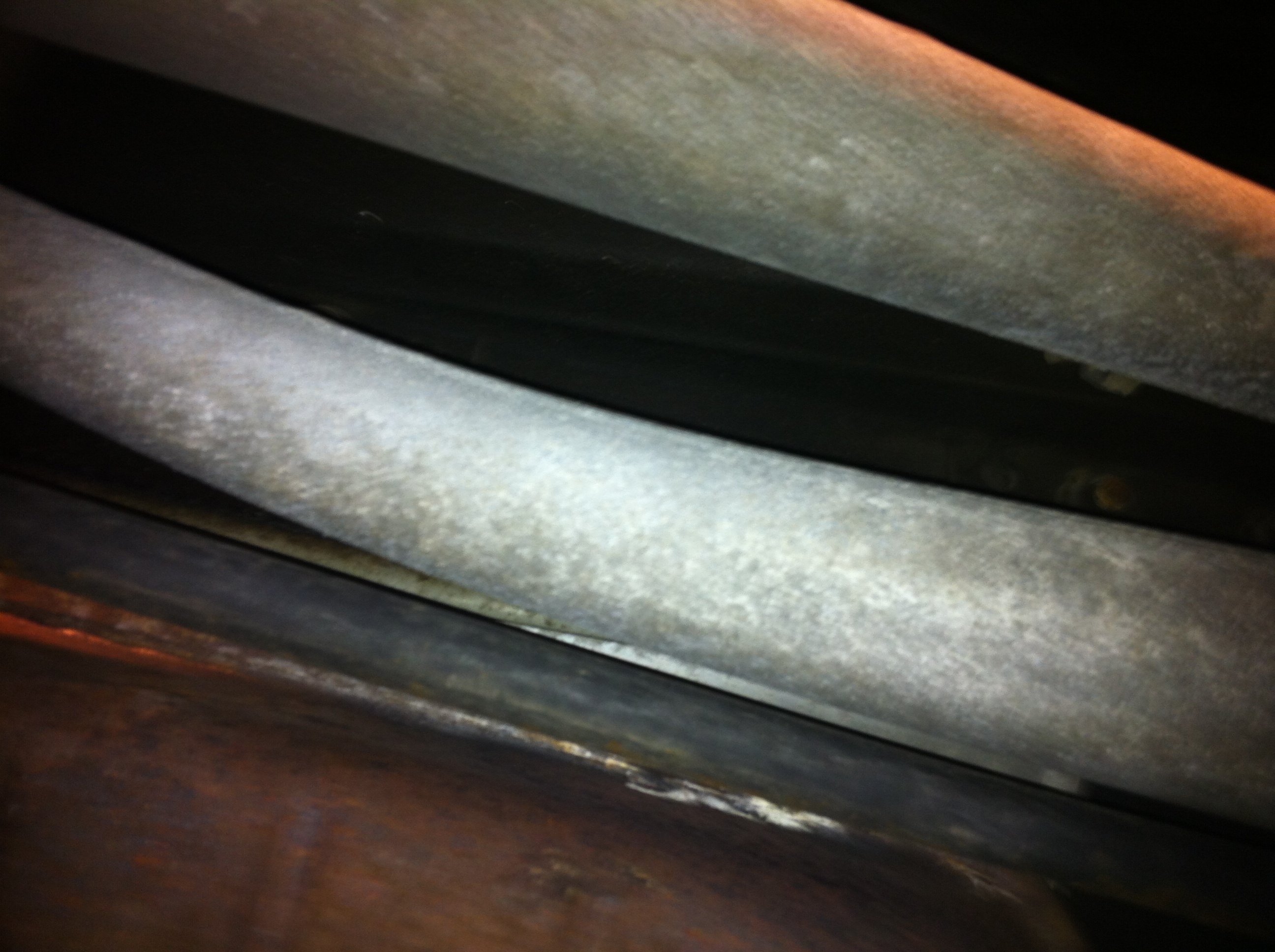

The passenger side delta link bushing (the one with the 3 bolts) is certainly broken with the cylindrical part shoved at least an inch past where should mate with the part with the vertical bolts.
I also looks to me like the passenger side arm is bent. I'm going to take some pictures once my phone charges.

I can't really tell for sure from the pictures but my first reaction is that the arm is indeed bent. They are tapered so it can be an illusion.
I think they are fairly cheap at a junk yard since there isn't much demand for them. When you get done you will need a 4 wheel alignment to get the rear toe set but alignments cost so stinking much that I would want to at least have a reasonable chance that it will align properly before I even took it in.
