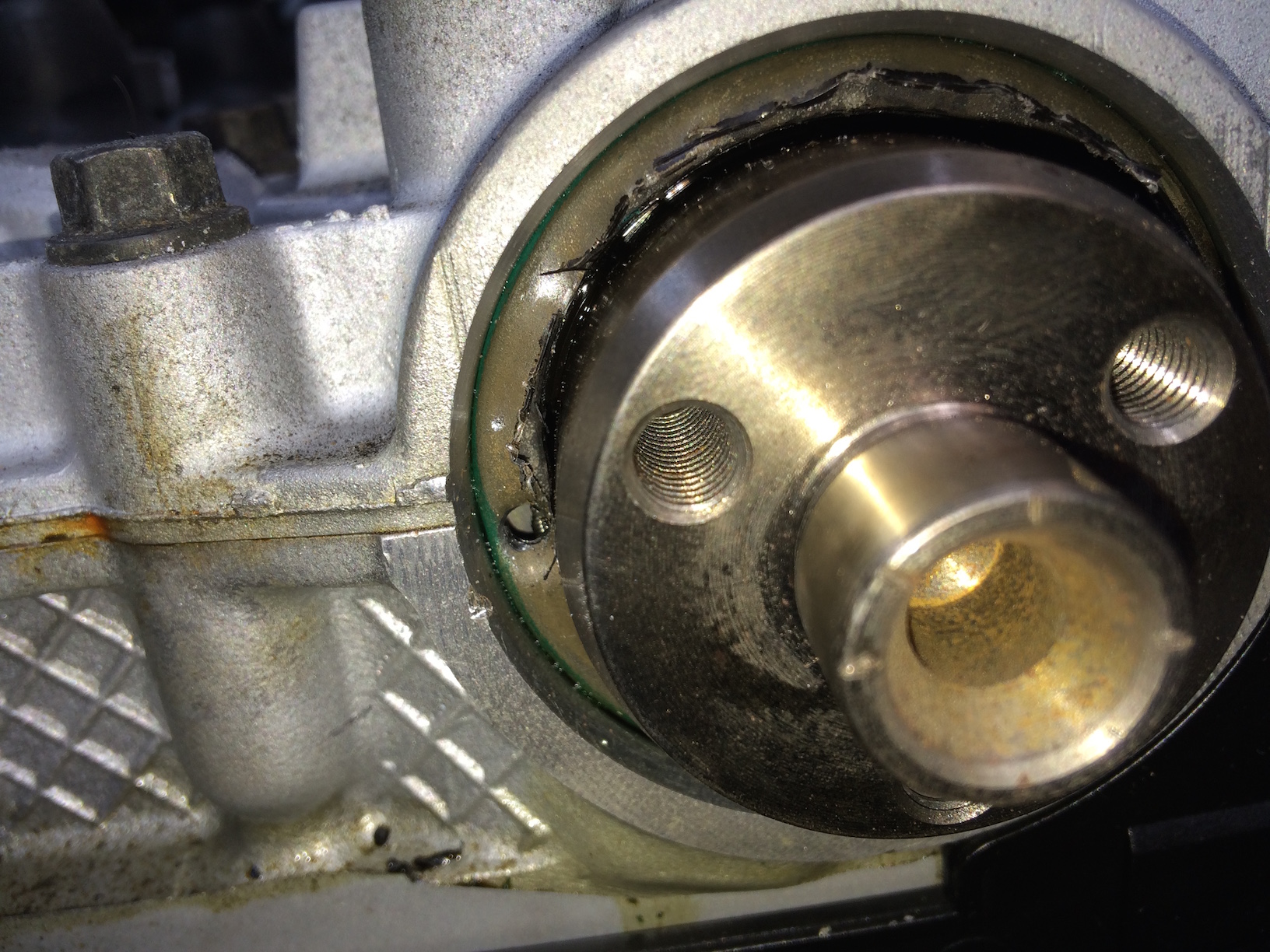

I have tried both the machine screw and the paint can opener method. I went for screw first, but couldn't get it to bite into it. So I tried paint can opener (which had worked for me with much older seals in the past). That mangled the seal pretty good. It seemed to hook in, separating the steel part of the seal from the rubber. The steal portion is peeled away and out, but the rubber portion is still visible in place. So I went back to the screw method. This time I used a small hammer to get it initially biting, then switch to a fresh screw, and that got it in. Grabbed it with locking pliers and yanked awhile. Eventually, the screw popped out, but no movement on the seal.
I guess the worst case scenario, backup plan is pull the cam cover...

As for this one, I just got the intake seal out and it's not pretty. I don't think any sealing surface was damaged, but the screw did bite into the block. Luckily, it just missed the sealing seam where the block meets cam cover (seems like that would be worse than what happened). I think the screw bottomed out, and pushed the seal out.
Now I'm debating if I should even bother with the exhaust seal. It is leaking, though I think the intake was worse. I just don't want to be in a worse position. There's a lot of oil in the timing belt cover area. I think it is coming from intake seal, and working its way back and behind, then out around water pump.
Not wanting to do this for a third time, I bought OE Volvo Seals and the Volvo Drift 9995449:
Though I don't think it's idiot proof. It seems if allowed to bottom out, it would push the seal in too far.

Again, don't stress out about going in too far especially with that tool, a bit too far is not going to ruin things. Straight is important, whereas how far is largely a matter of opinion. But cn90's point is sometimes true, that a new seal installed in exactly the same place can leak if the shaft inside happens to be grooved there.
That screw nick is inconsequential, don't worry about it. You definitely need to install a seal on the exhaust cam, if you skip that then it will leak oil badly.
