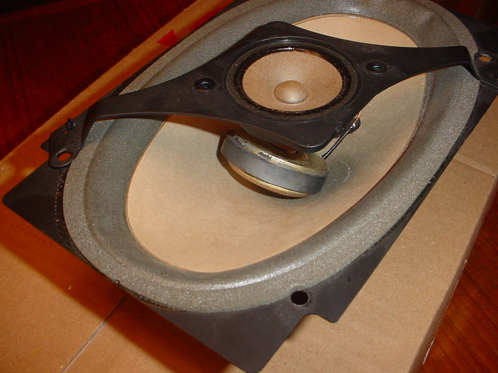

For the first time since I bought my car, I had passengers sitting in the back and they said that they could hardly hear the music so I checked to see if I had faded the sound of the speakers to the front but it wasn't. When I then faded all the sound to the rear speakers, there was no sound at all in the car. How can I got about troubleshooting this problem and has anyone ever experienced something similar?

Chances are the magnets on the tweeter fell off and have pretty well crushed the larger cone. It happens to all of them but at least the glue is environmentally friendly.

The actual factory replacements, if you can even get them these days, are really expensive and they are an oddball size and mounting configuration.
I used some aftermarket 5 x 7 speakers but I had to chop up the old speakers to use as a mounting plate.
Details are in this thread:
https://www.matthewsvolvosite.com/forums ... php?t=8402
After replacing everything they sound great except for the God awful 6+db bump at around 100 Hz on the factory head units. One of these days I will scare up a SC901 that I can actually set to a flat frequency response.
