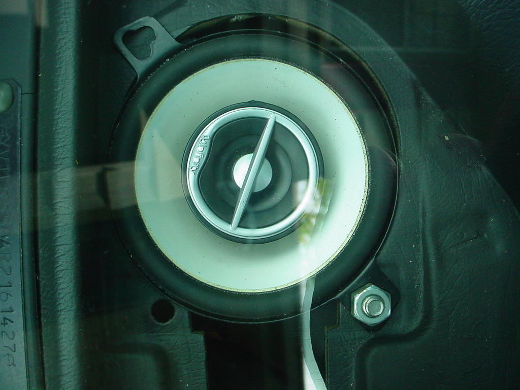

I replaced the dash speakers with a pair of Infinity 3012CF speakers. They are 3 1/2" coaxials but I think just about any 3 1/2" aftermarket speakers will work since the mounting tabs in the aftermarket world tend to be more or less standard.
I unsoldered the factory wiring harness from the old speakers, noting the polarity, and then soldered the harness wires onto the new speakers.
I looked at modifying the factory Volvo mounting plate to accept the new speakers but it looked to it would be a real pain. In my case I just took a single 1/4" bolt that was about, I think, about 1/2" long and secured one tab of the replacement speaker into the hole where the original Volvo "pushpin" plastic holder went through. In my case I didn't have any rattles, either with audio or when hitting bumps in the road, so I called it good enough.
I had to take the picture through the window so it isn't real great but this is how I mounted them.
Hope it helps,
...Lee
