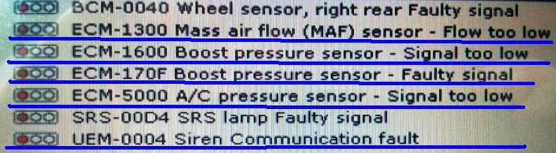

As you can see it's been a long time I started this thread.
With this as result of fault reading; Now the rest of the story:
