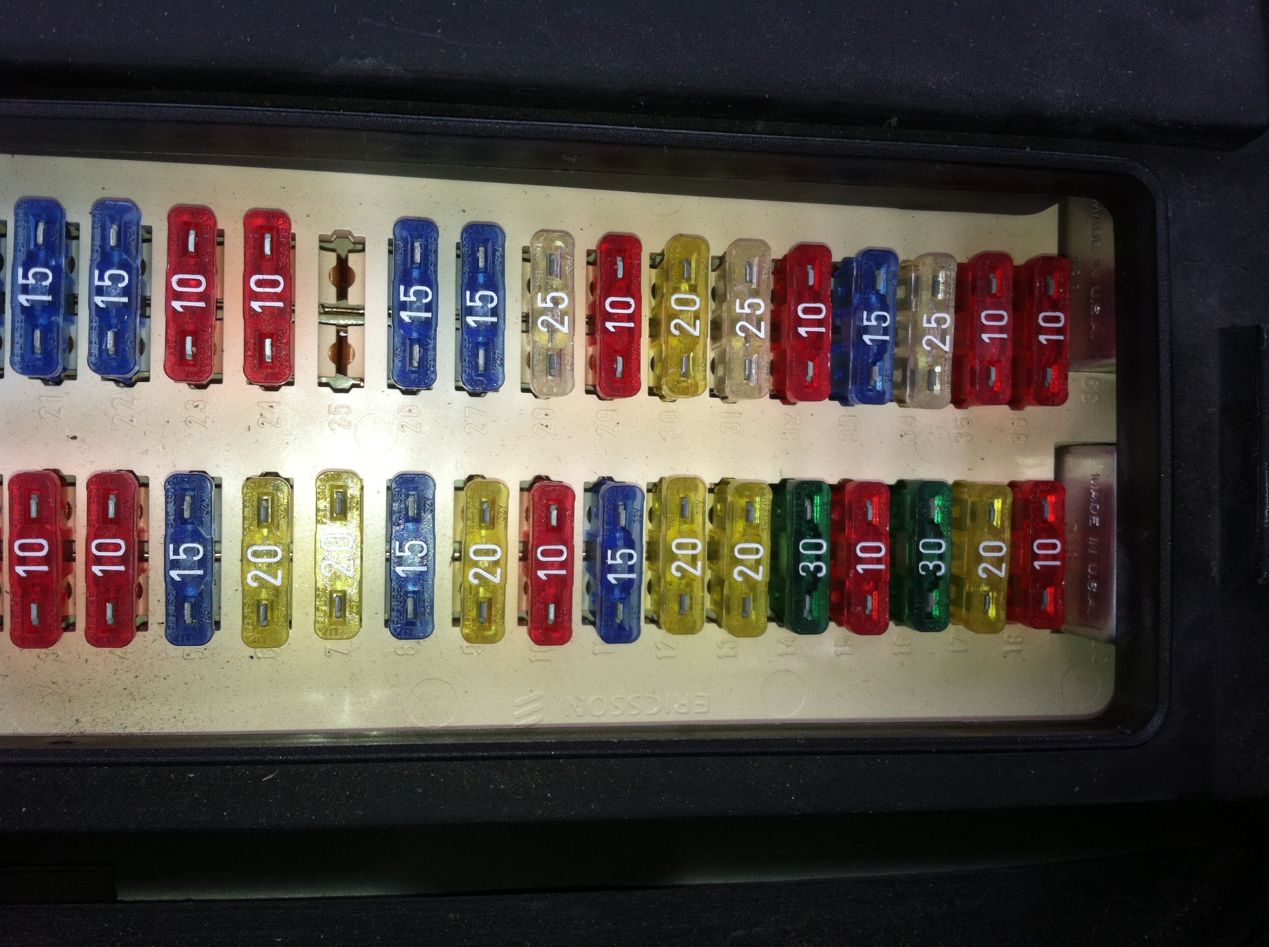

Here are the pictures of what I have. Don't see the part you are talking
about. The fuse for seats may be #35.

On the top photo just visible to the extreme right edge are two silver rectangles just a bit larger than the fuses themselves. I believe these are the auto resetting circuit breakers. Pull one or both then try the power driver's seat and see if you get anywhere trying to move it.

See them. Thanks. That will take a torque drive to get to, so I will do after work and see what happens.
