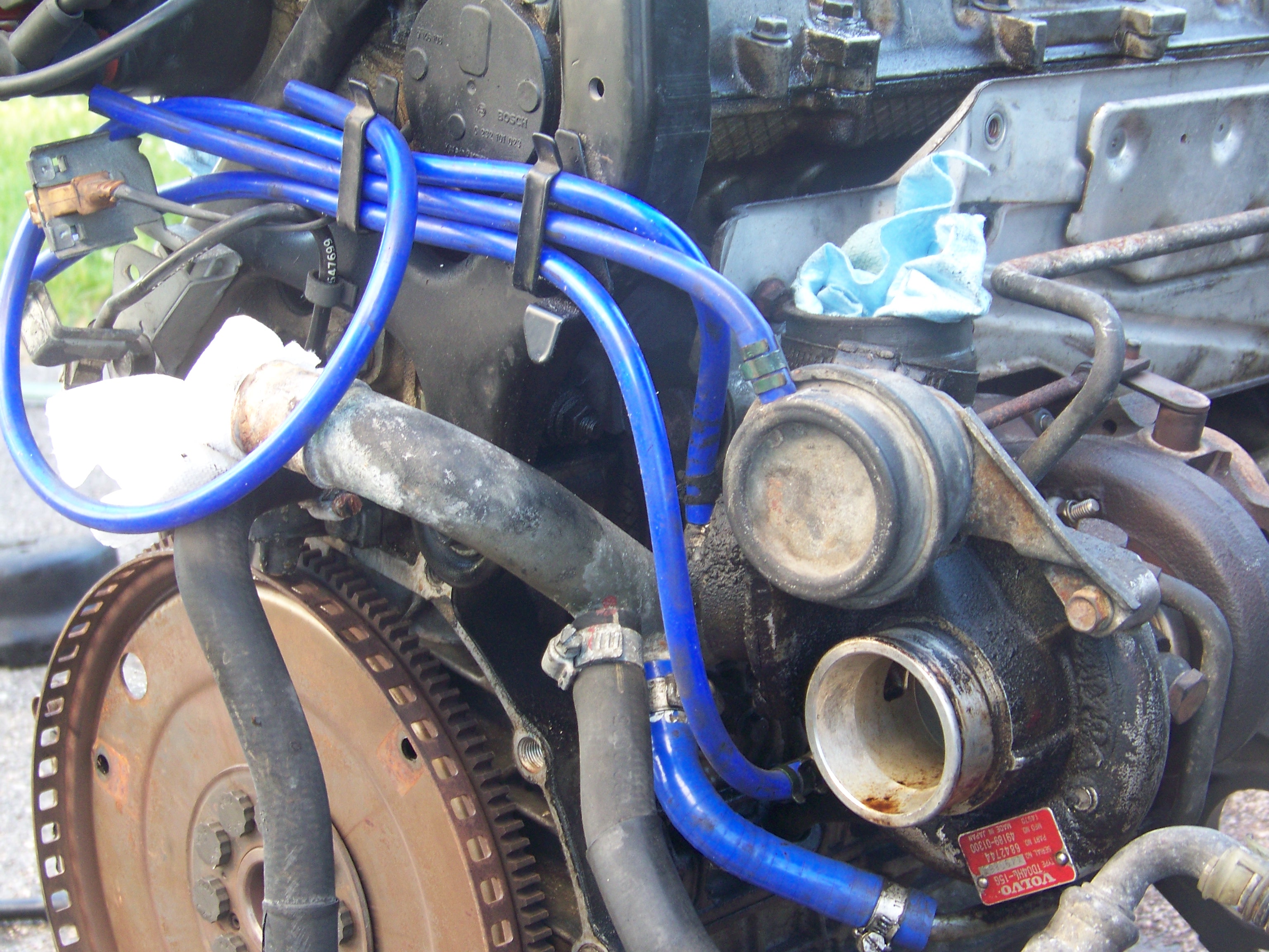

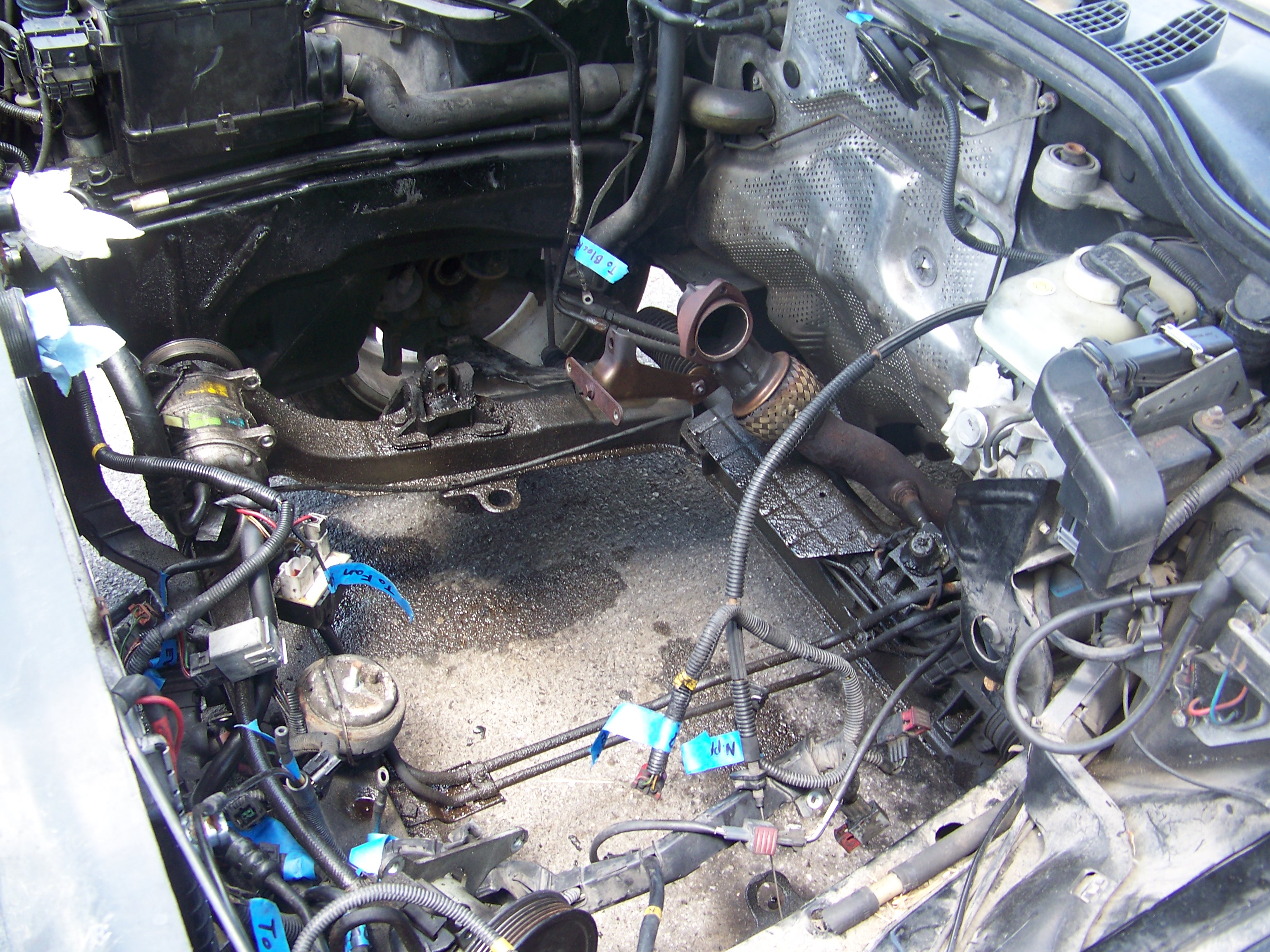

I followed wheelsup's fantastic write up for removing the engine. As electrical connecotrs and vacuum hoses are disconnected I highly recommend you mark them with tape to remember where each one goes. Also pay attention to the wiring for the oxygen sensors and mark which plug goes to which sensor.
https://www.matthewsvolvosite.com/forums ... =1&t=28973

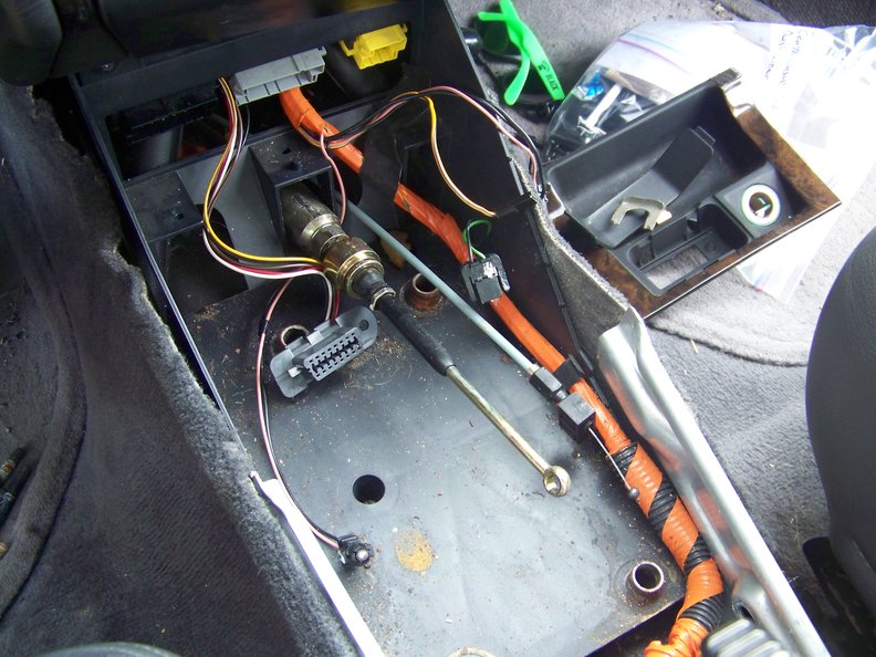

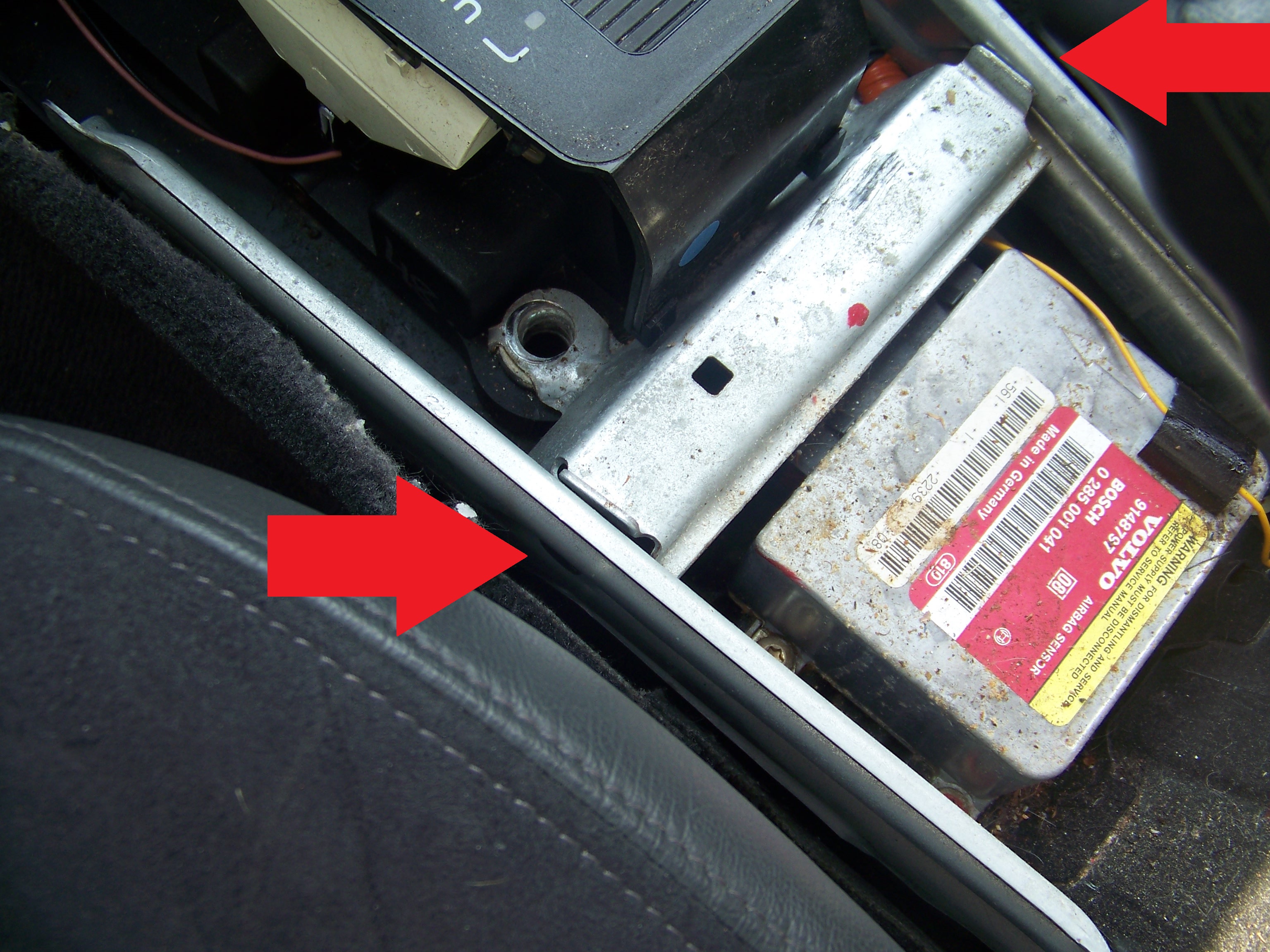

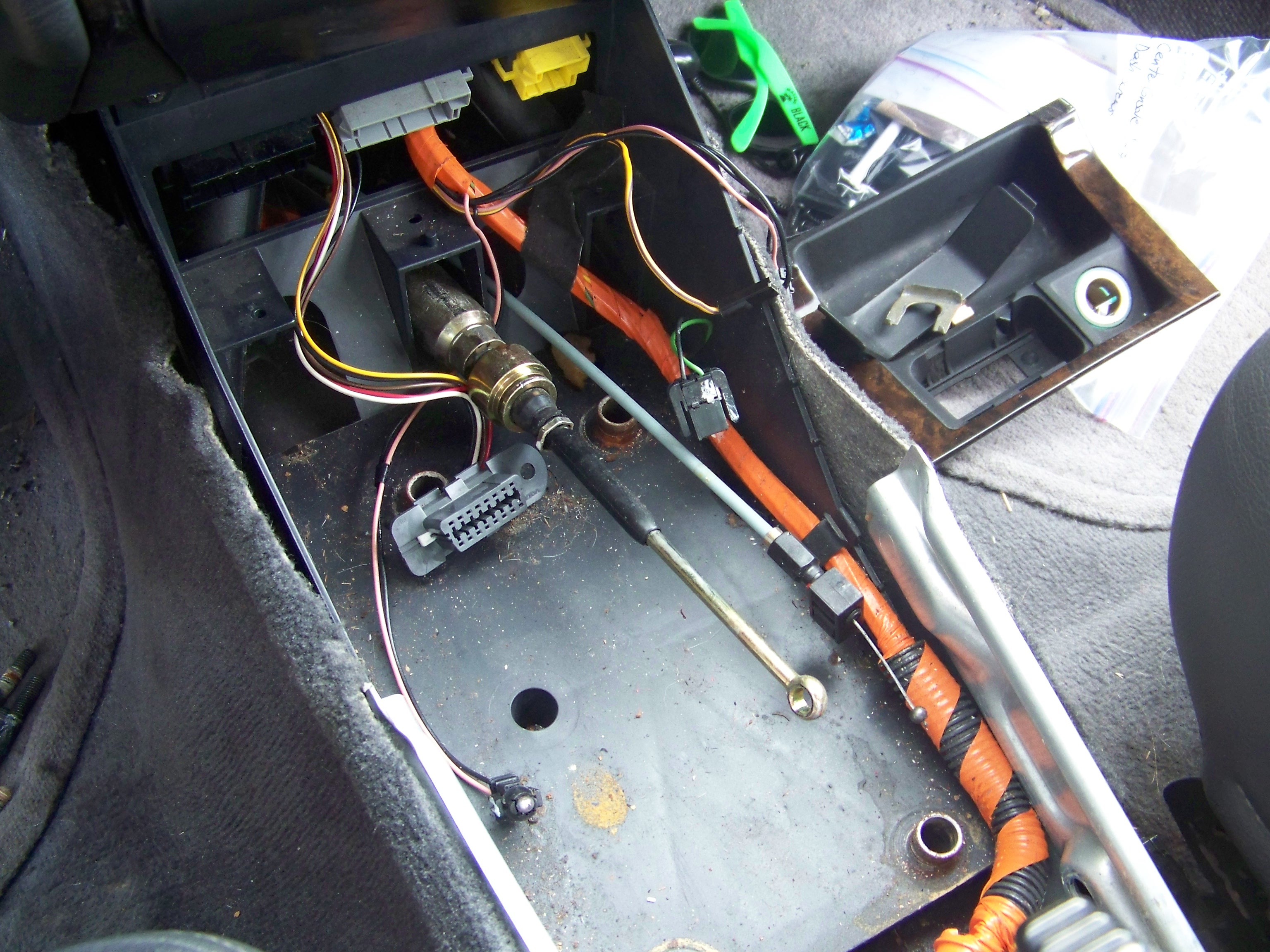

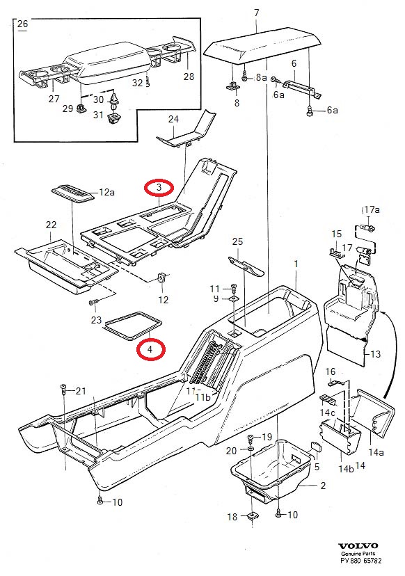

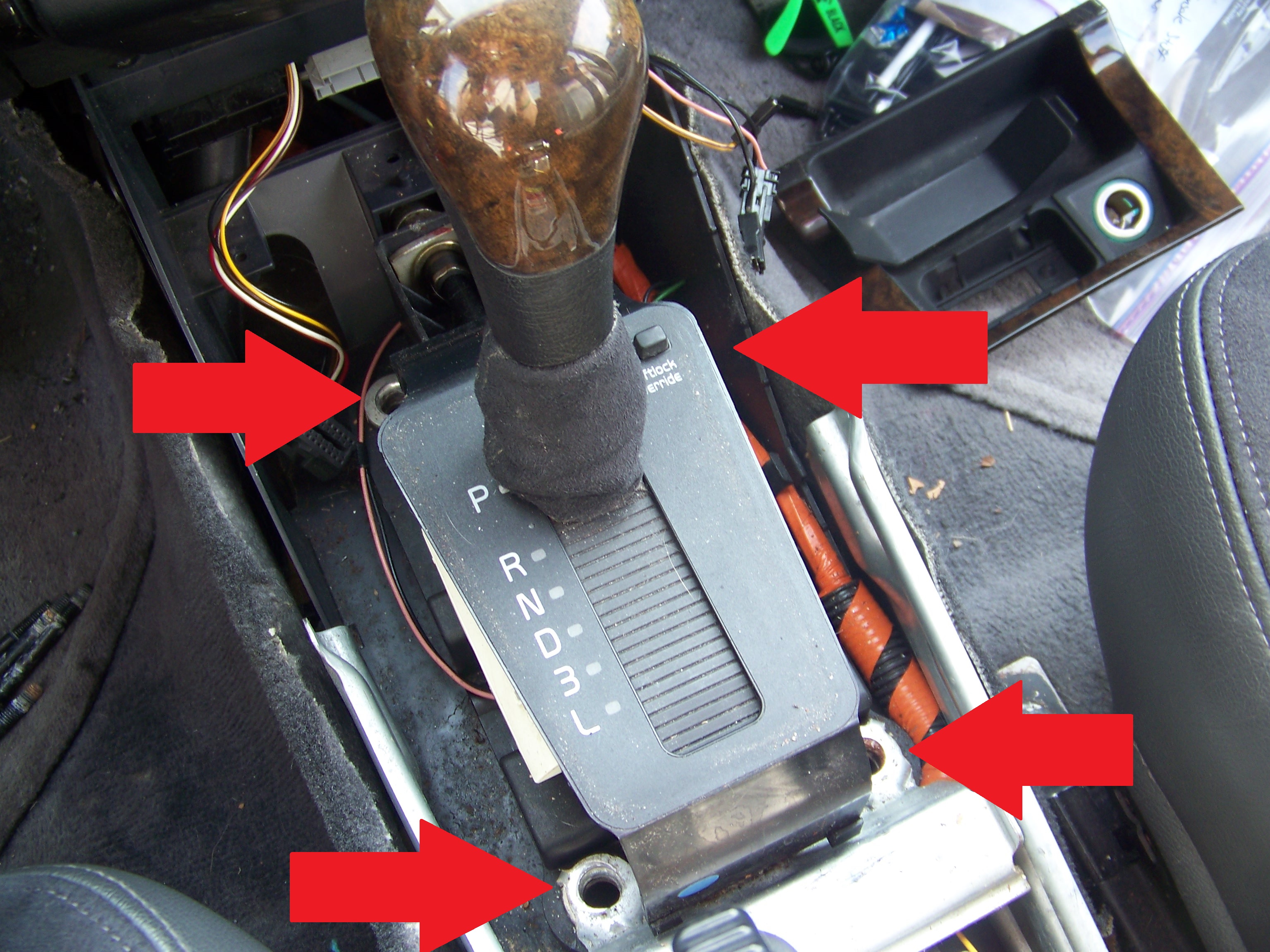

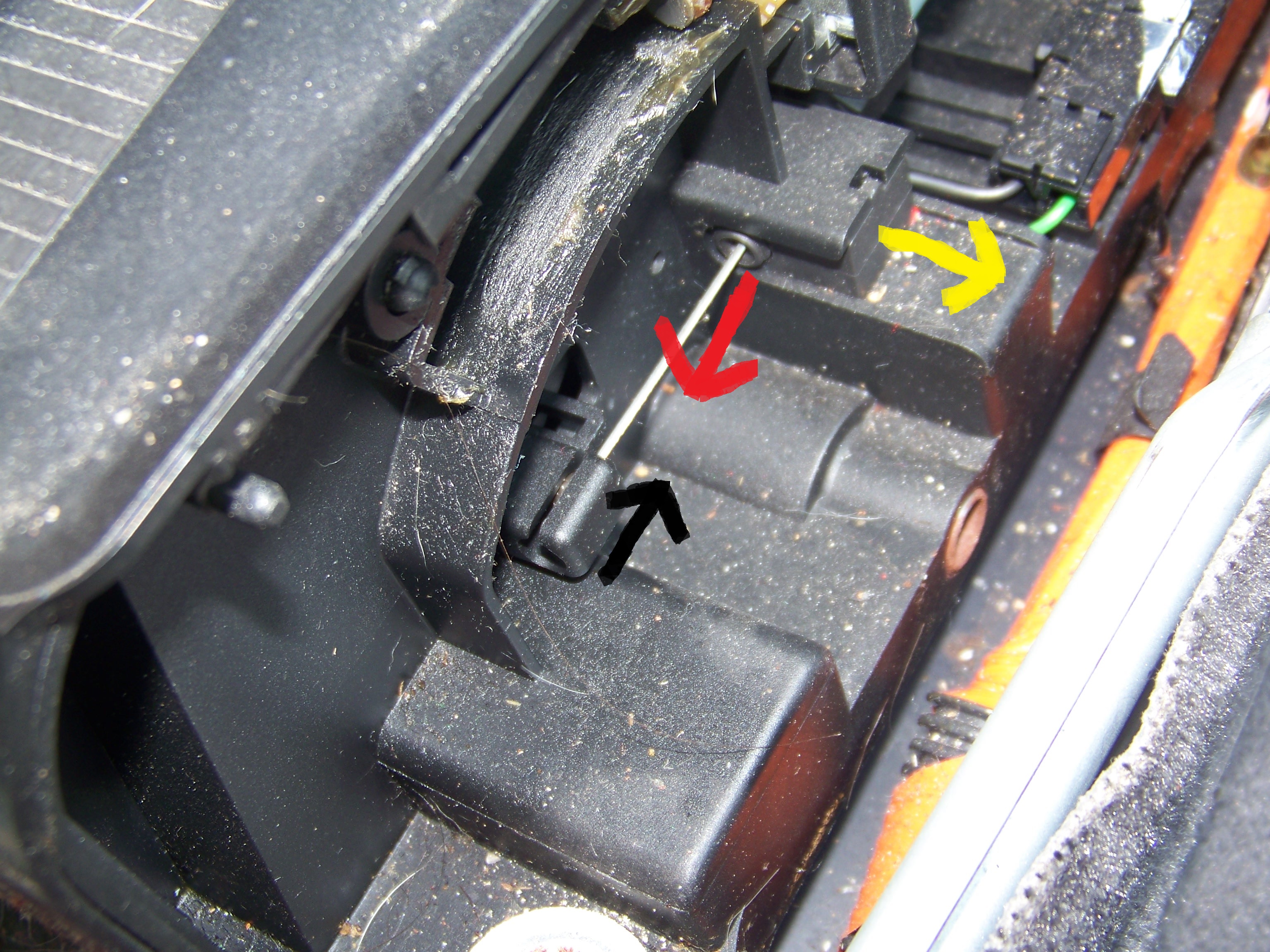

Begin by removing the center console:

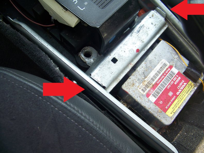

With the center console removed you now have access to the 4 bolts securing the shifter.
Next remove the 2 bolts securing the metal plate covering the back of the shifter. An offset box wrench makes it much easier to access these.

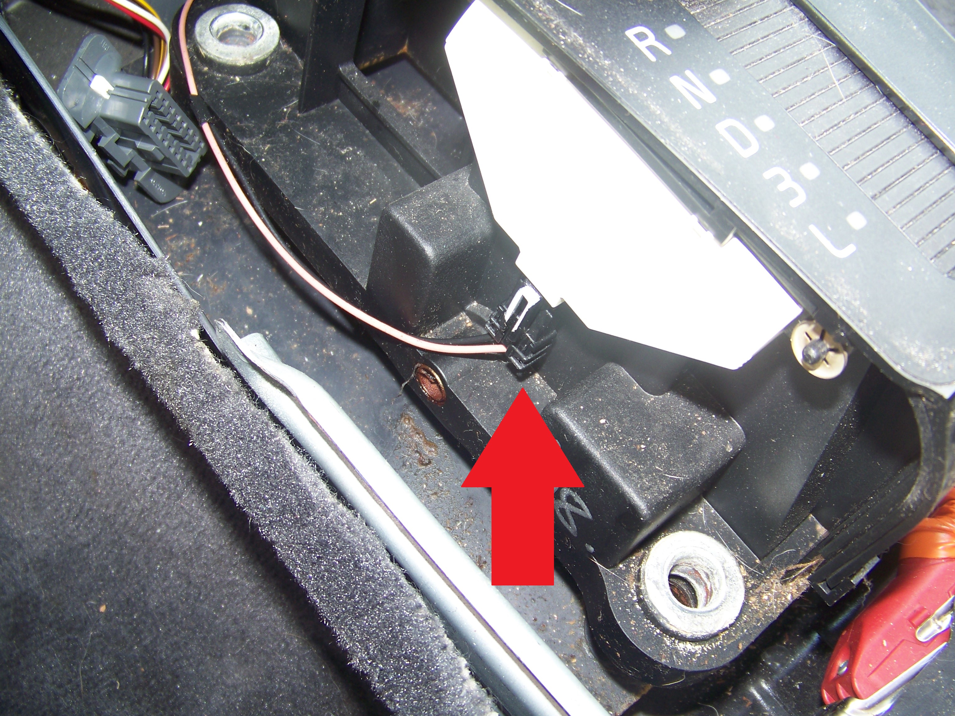

Disconnect the shifter light on the left side.

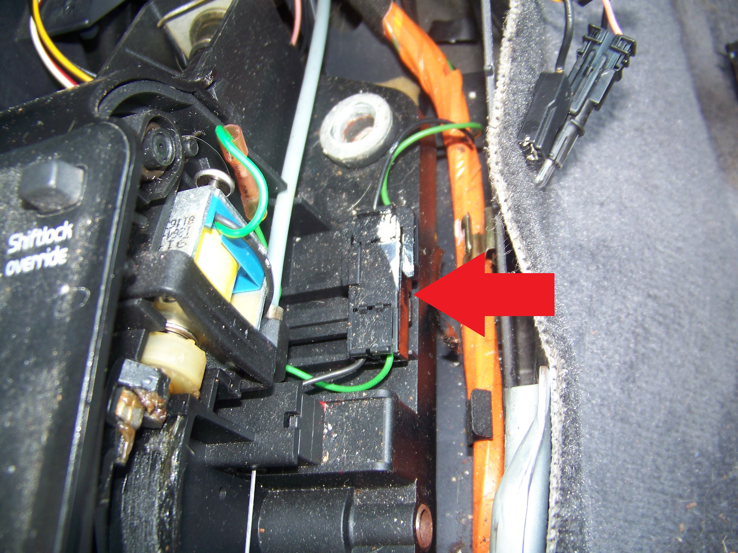

Disconnect the electrical connector or the right side of the shifter.

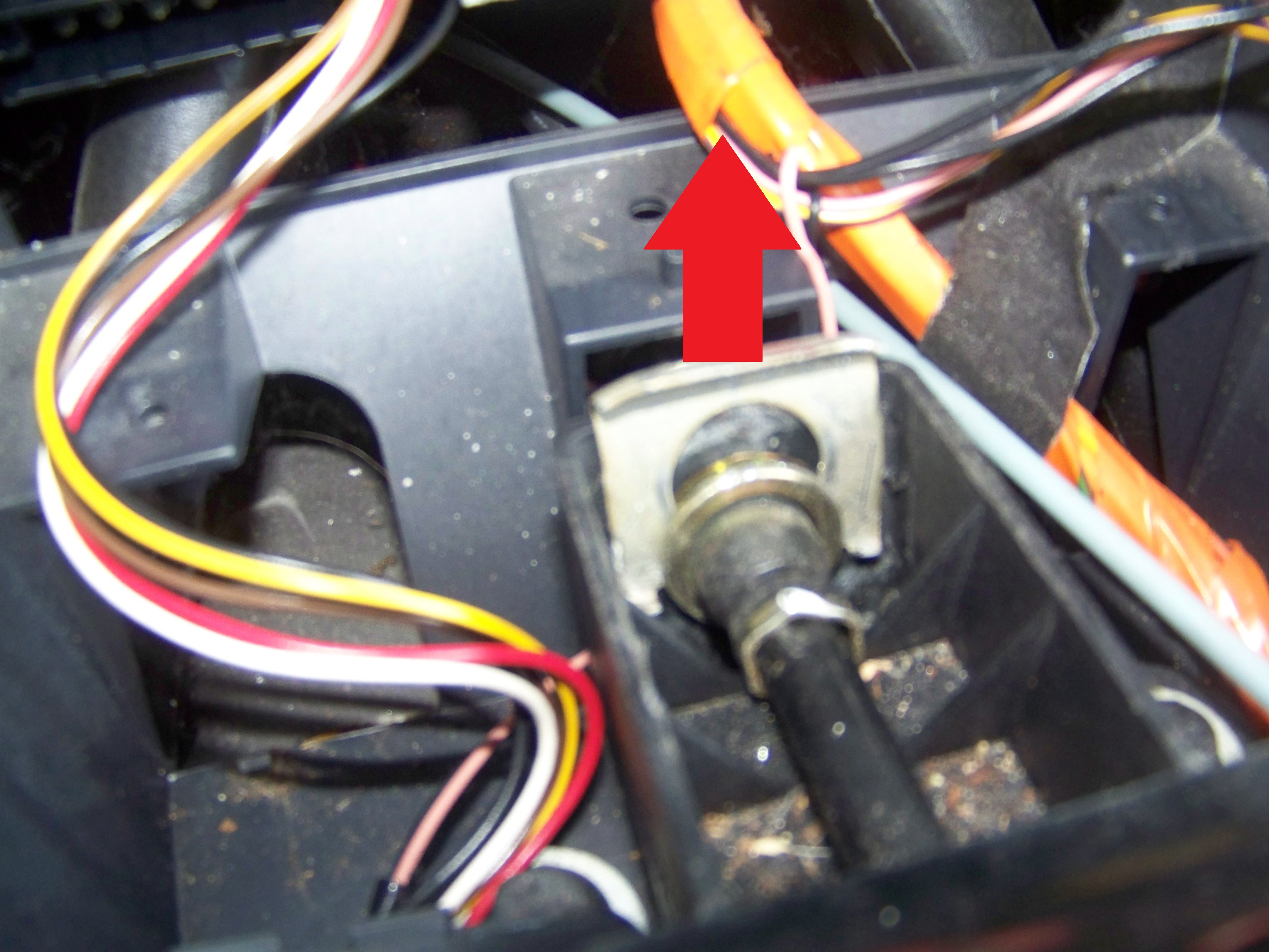

Next release the outer cable on the right side of the shifter. Using pliers pull the cable towards the back of the car while pushing the plastic slide towards the front of the car. I found this is easiest to do with a second pair of hands. Once the metal ball clears the plastic you can remove the cable entirely from the shifter assembly by sliding the plastic box marked with the yellow arrow off of the shifter.
Next slide the metal collar up and off the center shift cable. This collar was extremely difficult to remove on my car and took a significant amount of time. Once removed set it aside. You can reuse this metal clip to secure the manual shift cables or keep it as an extra if you already have new replacement clips. Part number 3502507.

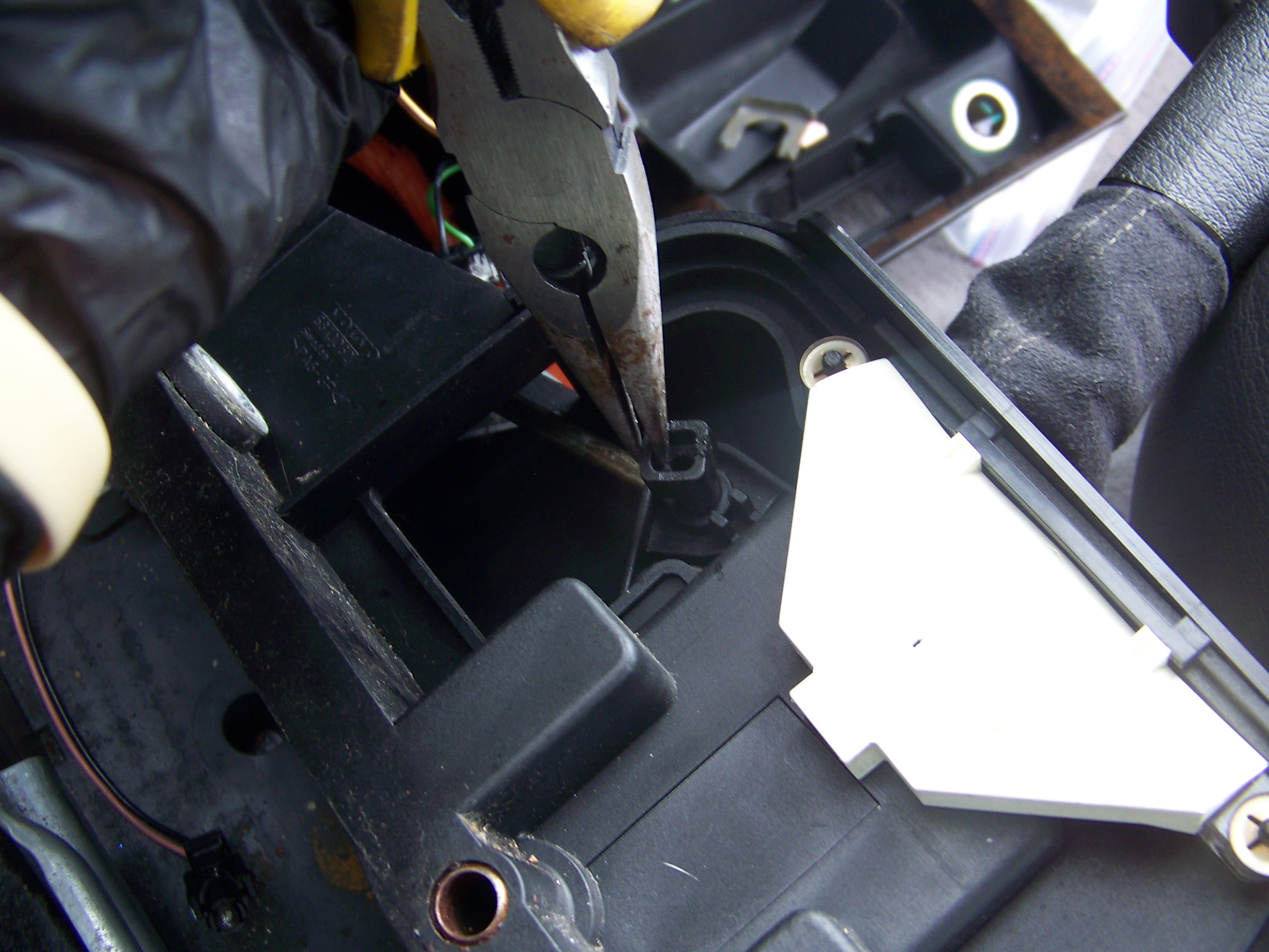

At this point only one thing is holding the shifter down. A plastic pin connects the shift cable to the shifter. Using a pair of pliers, pull up on the pin and remove it. You can now remove the shifter from the car.

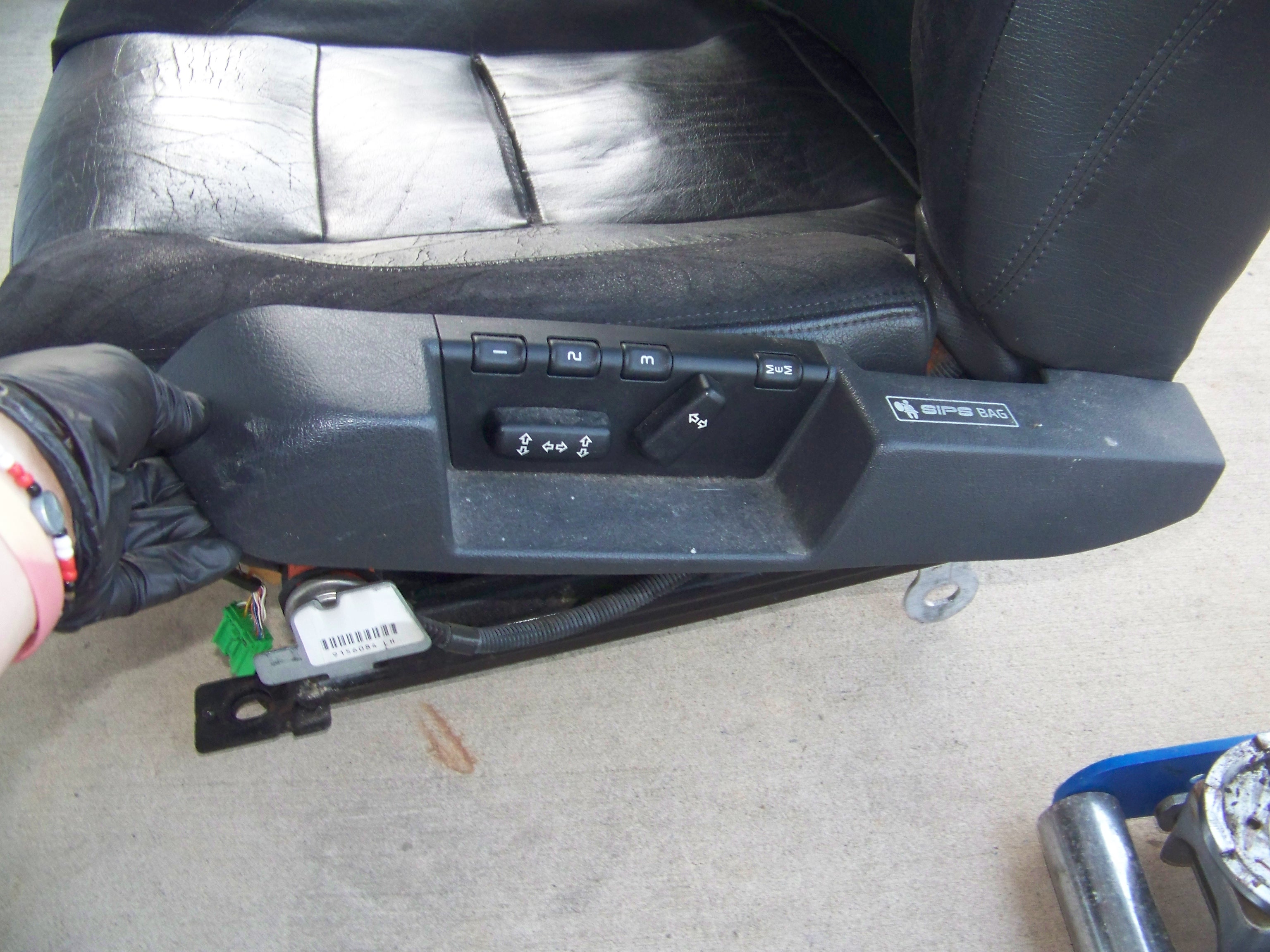

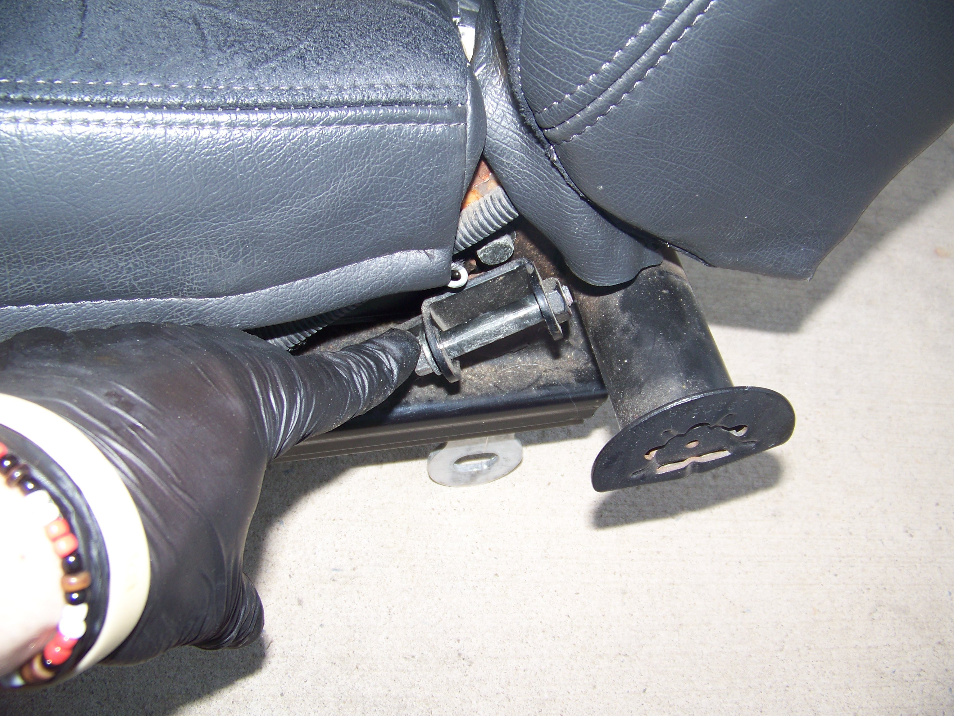

With the center console completely disassembled we can now turn to the rest of the interior. Remove the driver's front seat by removing the 4 bolts securing it to the floor. Tilt the seat back and disconnect the wiring harness beneath the seat. Slide the seat control panel up and back to release it from the seat and then unplug it. With the control panel off you can install the SIPS guard and remove the bolt for the seat belt. Haynes has you replace this with a new bolt when installing the seat back in the car. Once the seat is free remove it carefully from the car.

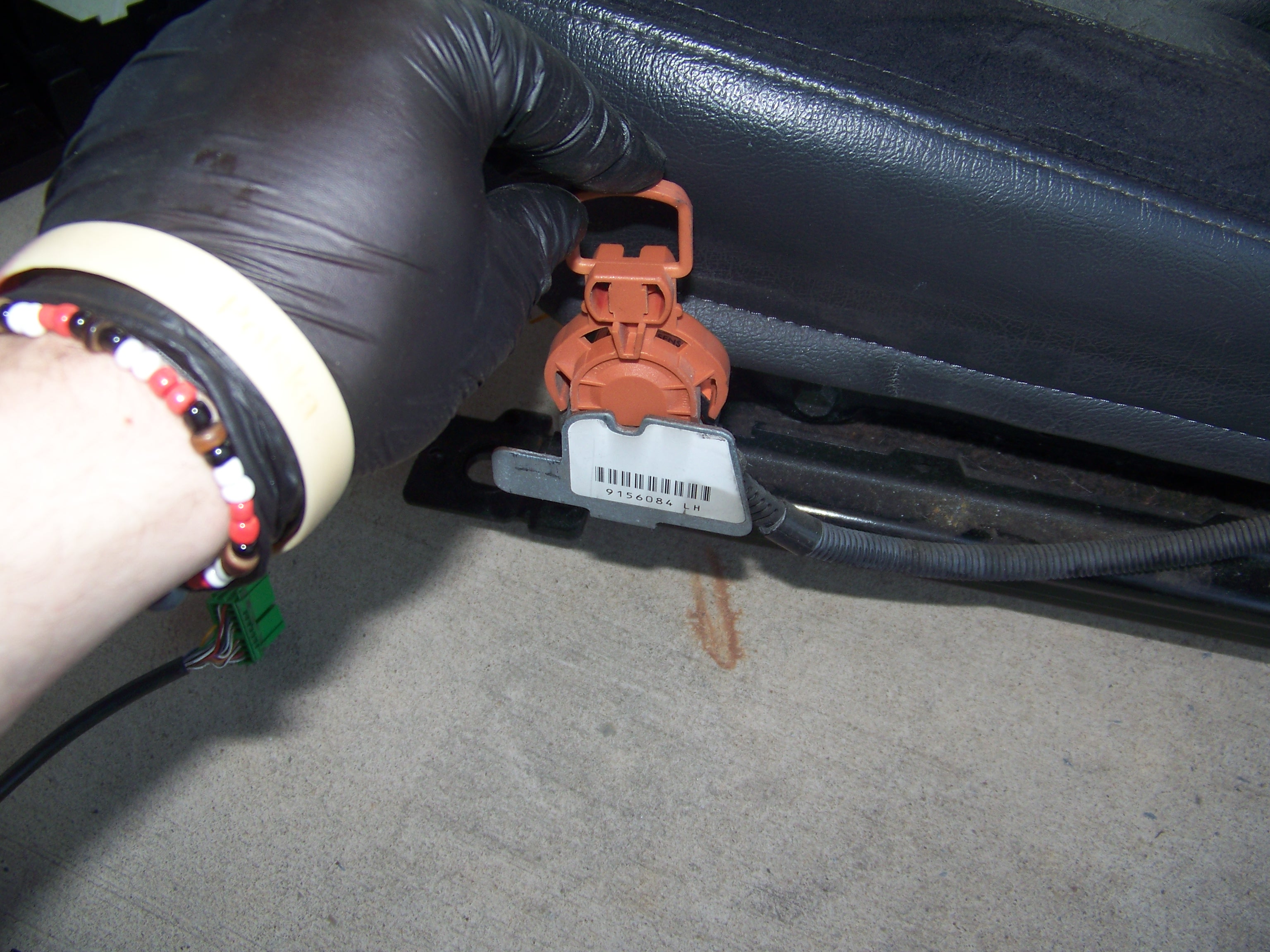

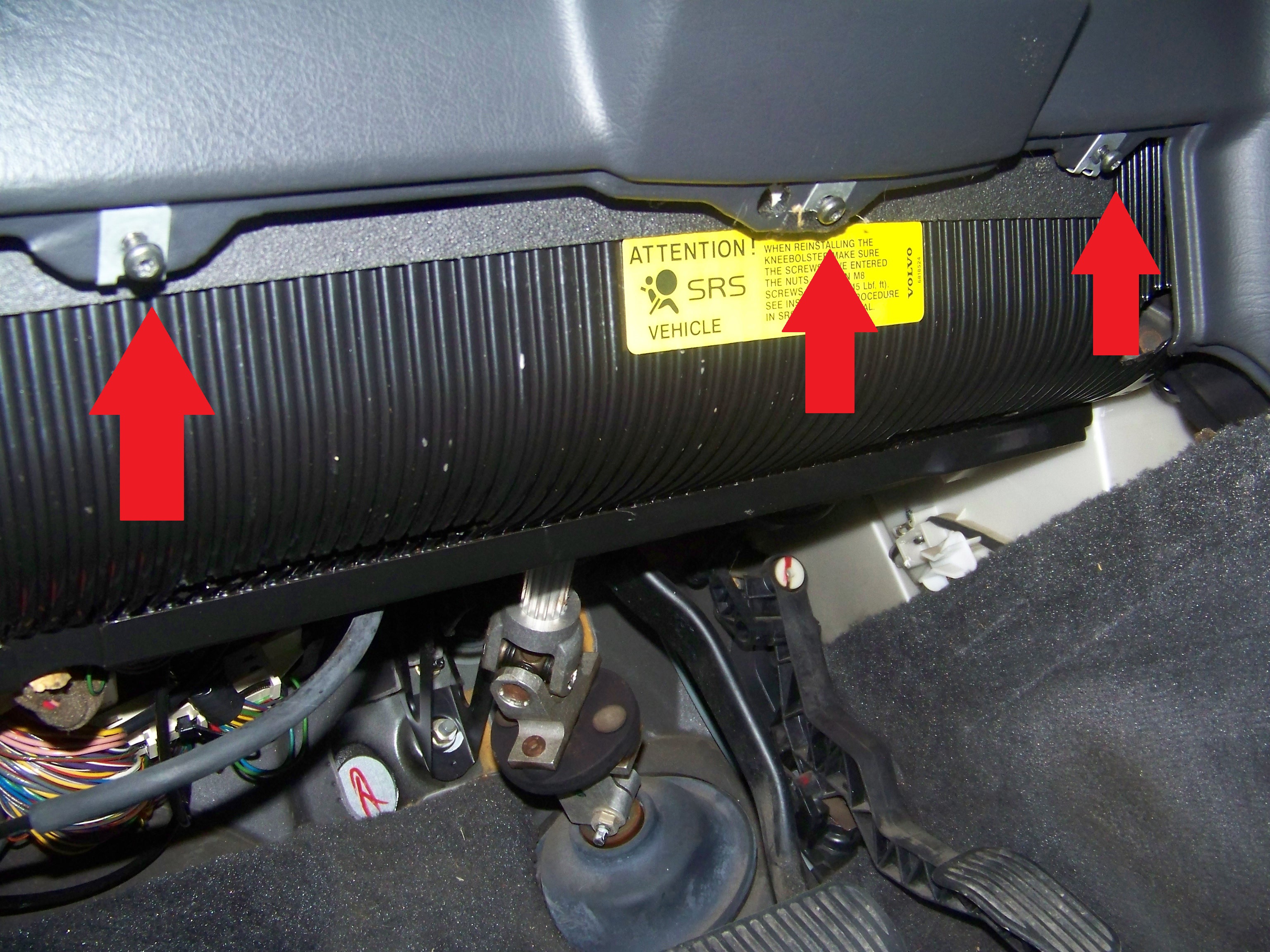

Once the seat is out remove the knee bolster beneath the dash on the driver's side. Three T25 screws hold it in place.
Carefully pull the carpet back in the footwell on the driver's side and remove the plastic carpet support panel. This will reveal the grommet for the automatic shift cable. Remove the two 10mm bolts and pull the grommet inward. Once you've loosened the grommet it will help to pull the other end of the cable (the end that was once attached to the shifter) under and out of the center console. At this point you can pull the cable through the firewall and remove it from the car.

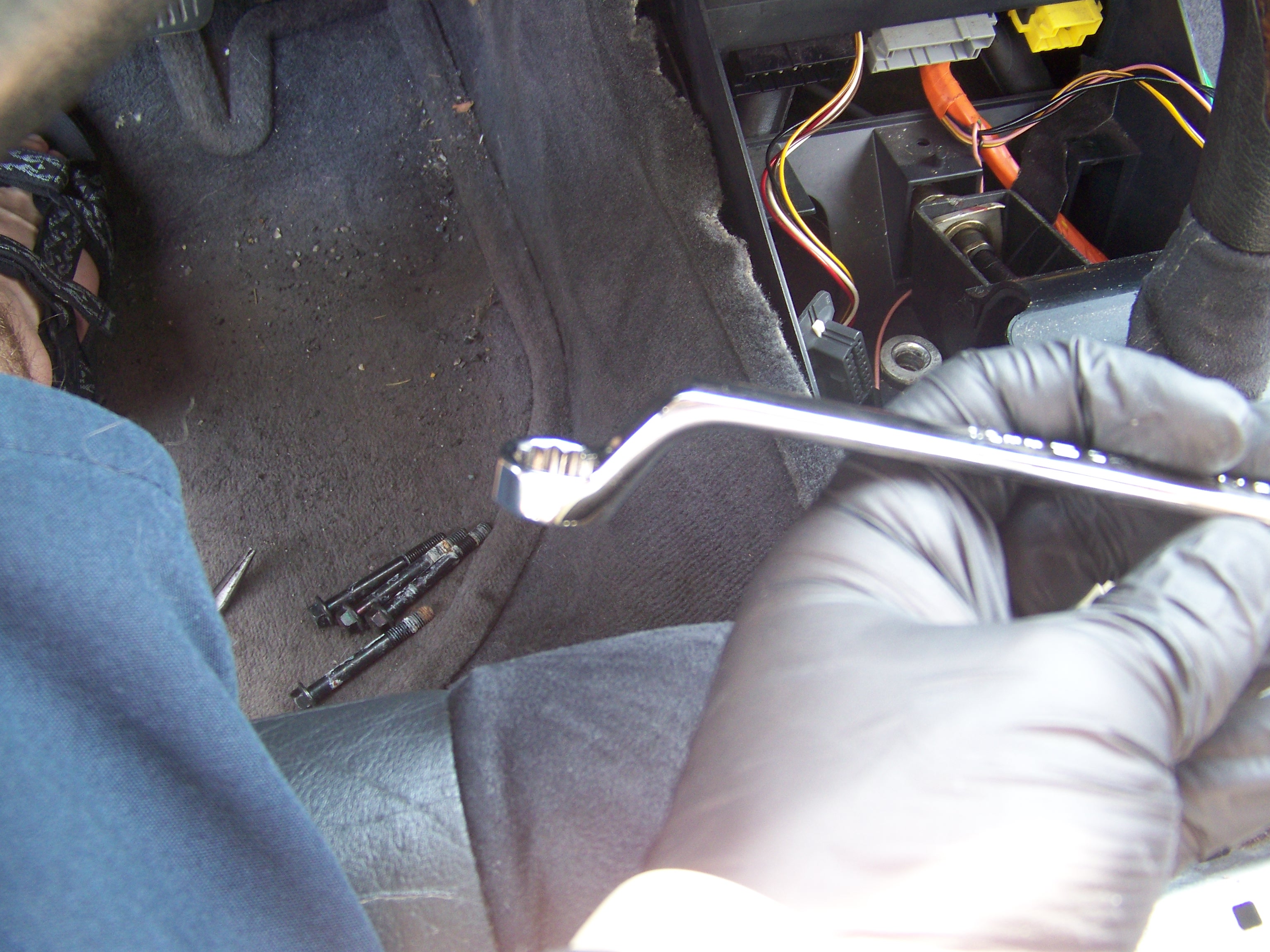

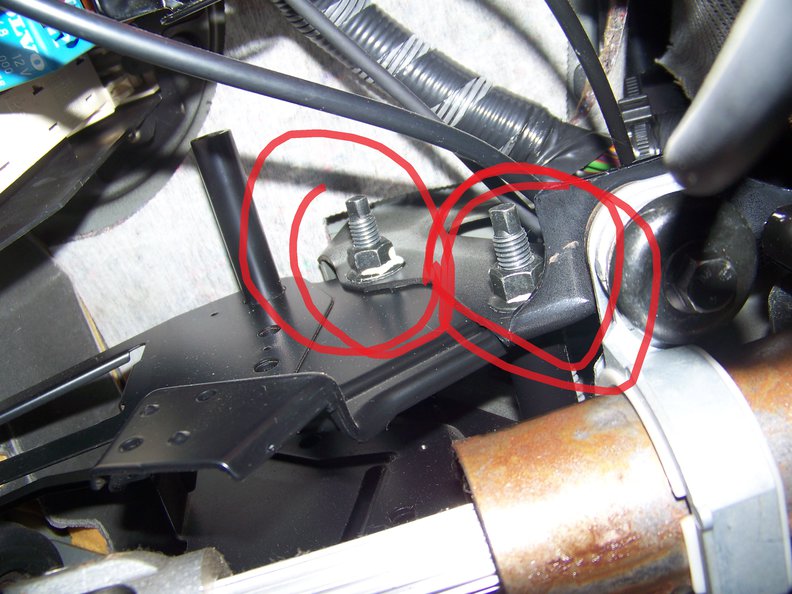

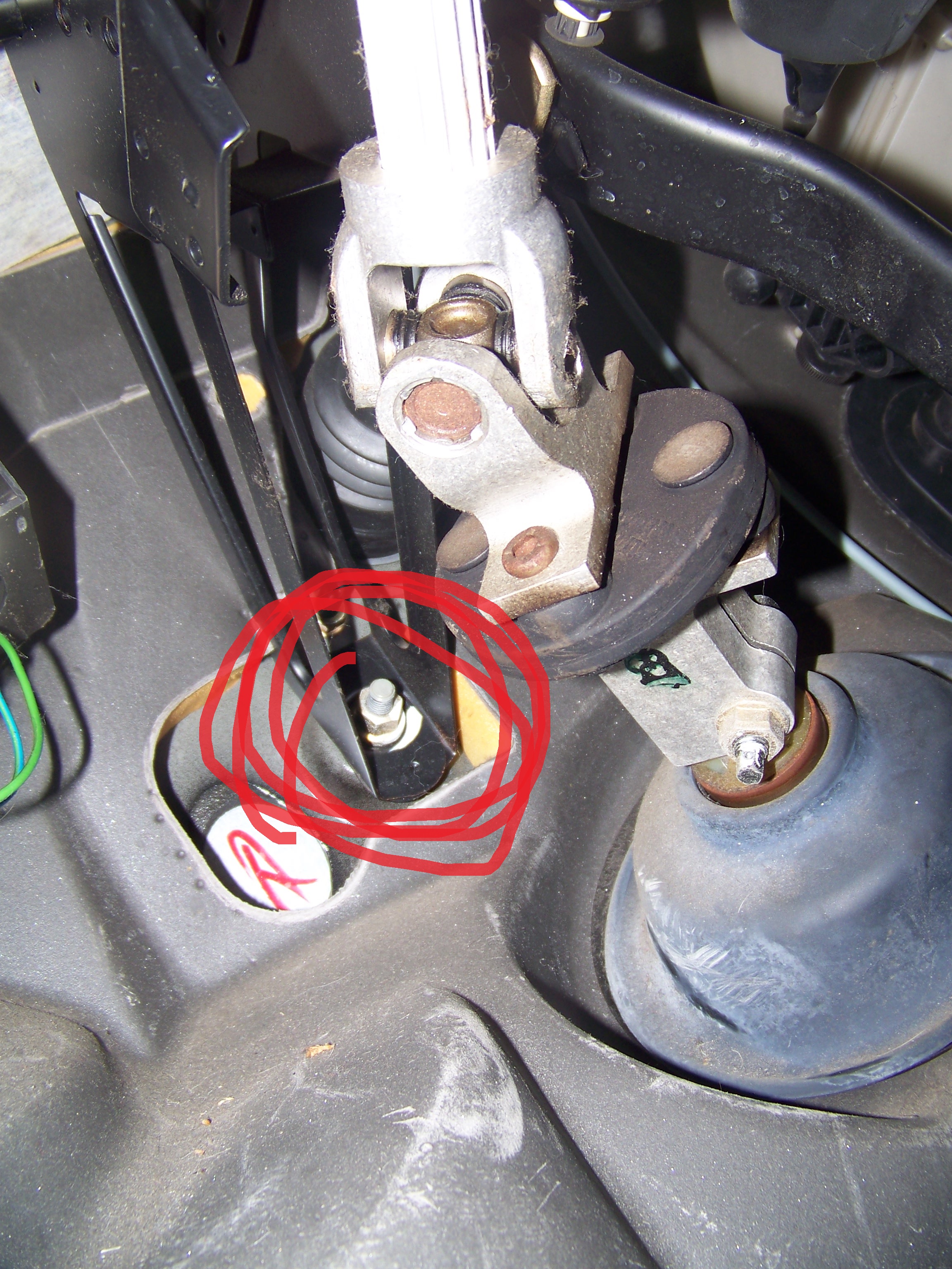

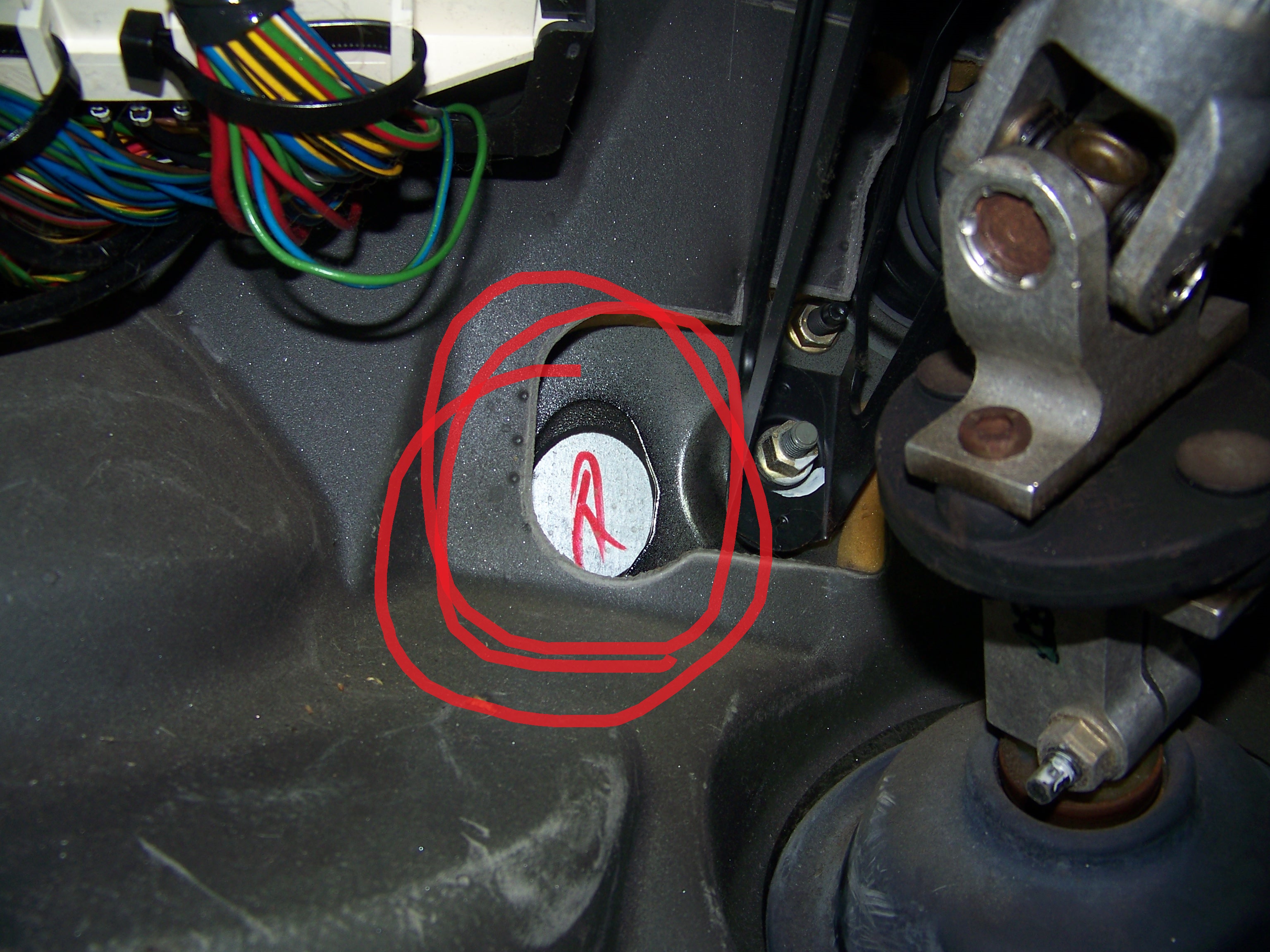

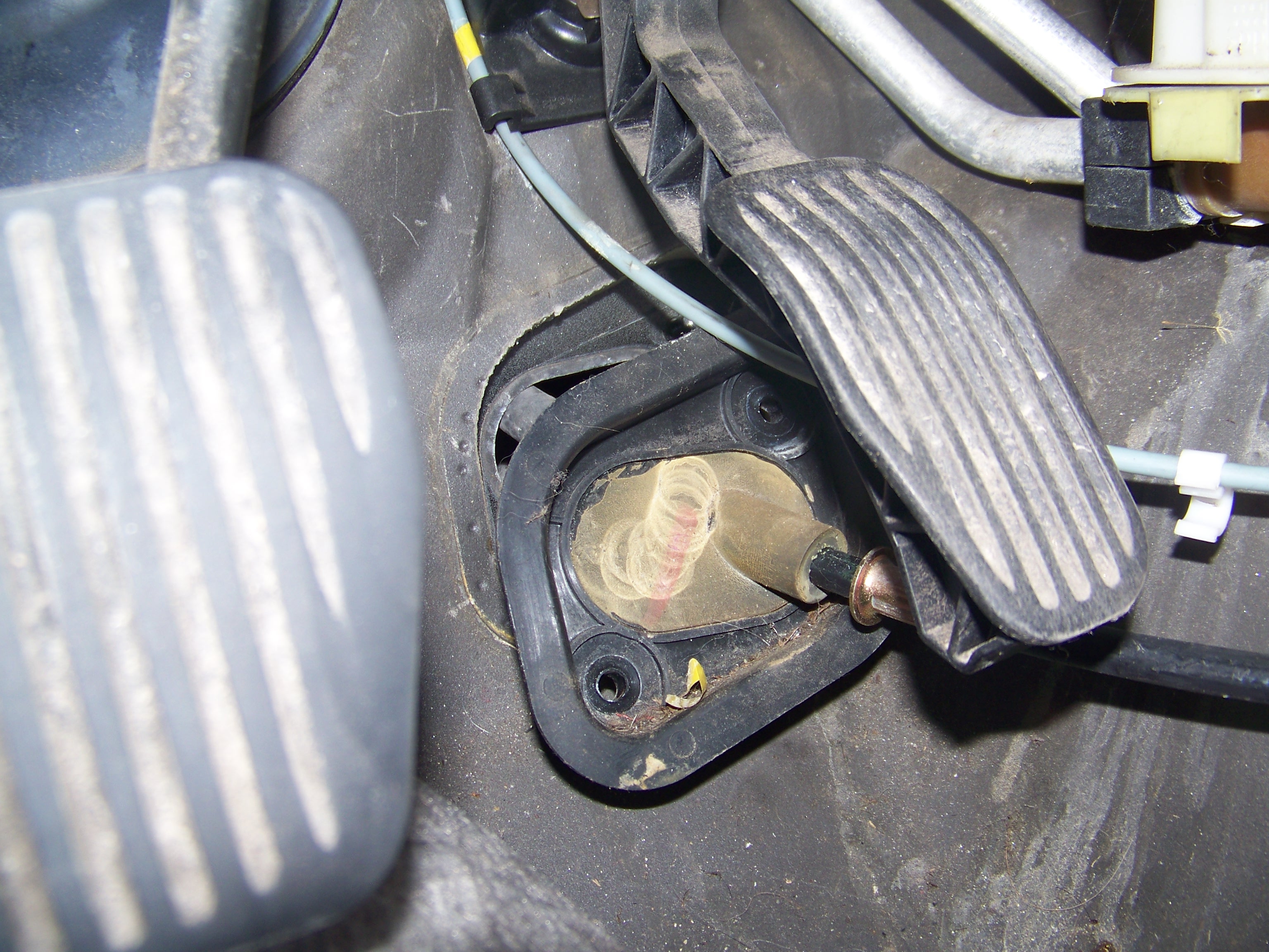

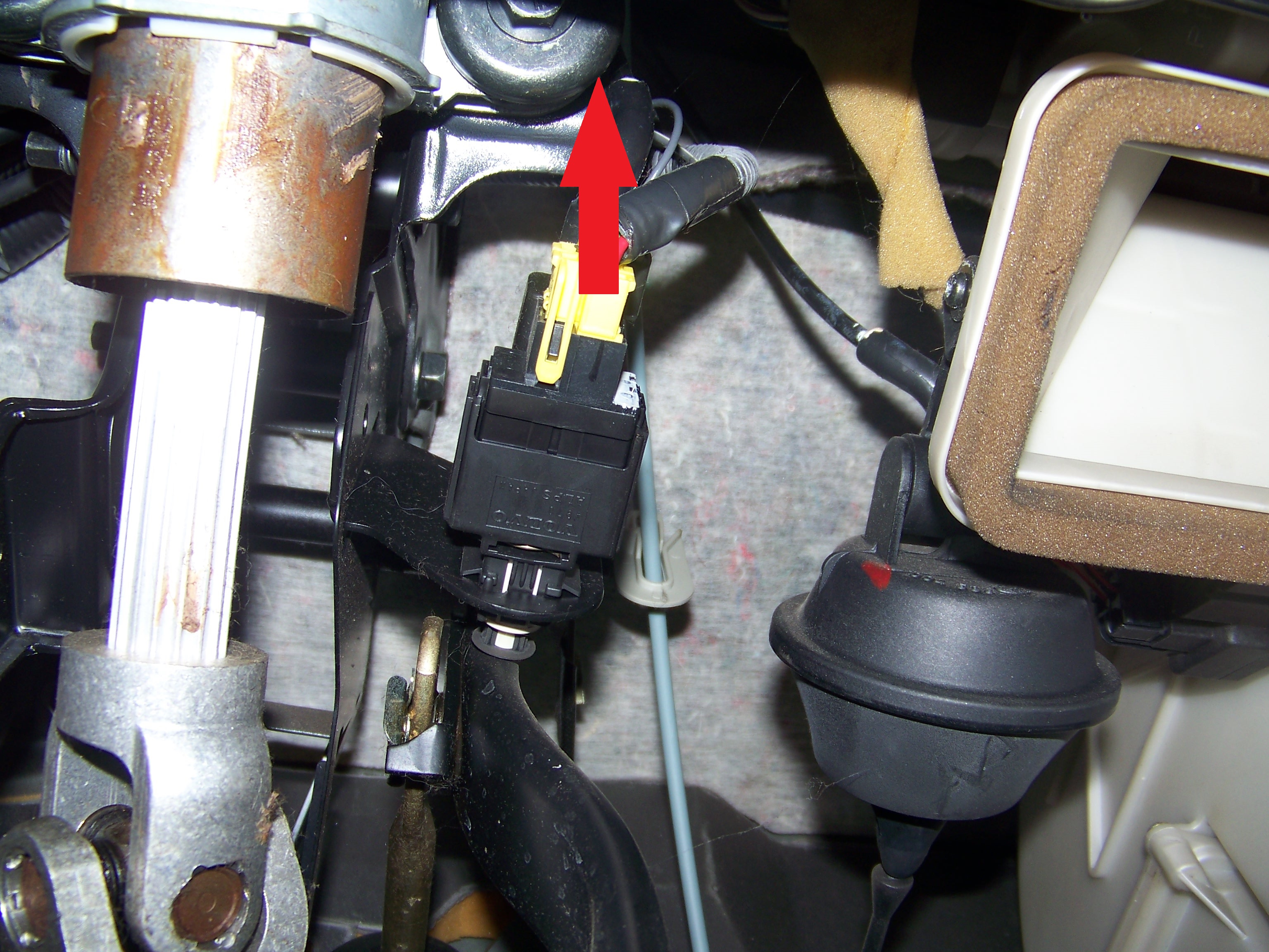

Removing the pedal assembly is one of the trickier parts of the swap. Lying on your back you’ll want to look up and study the pedal assembly. There are two large bolts that run through the pedal assembly and two nuts that secure the entire assembly to the firewall. Before removing the bolts I recommend removing the brake light switch and the cruise control switch or at least unplugging the wiring for them. The large bolts have nuts on the ends. You’ll need to hold those still while you loosen the bolts. Extensions and u-joint or swivel sockets will make the firewall bolts easier to remove. I bought a 3/8 drive adapter chuck for my drill which made removing the firewall bolts a bit easier once I had broken them loose.
With the bolts removed I tried sliding the pedal assembly out. The only way I could do it was to remove the brake pedal itself from the rest of the assembly. Using a flat head screw driver I pried the retaining clip (Item 11 in the diagram below) off and slid the brake pedal off of the rod. With the pedal off it was pretty easy to get the rest of the brake pedal assembly out although I did need a small pry bar to slide the assembly off the mounting stud on the fire wall. Once the assembly is out of the car you’ll want to remove the brake light and cruise cancel switches if you haven’t already done so. For the brake light switch, pull the plunger as far out as it will go and pull the plastic collar up. You can then depress the two tabs and slide the switch out of the bracket. The Haynes manual also explains how to remove the brake light switch.
With the old pedal assembly out of the way remove the two fasteners securing the cover plate for the clutch master cylinder. You'll need to move or cut some of the sound deadening material to access these fasteners.

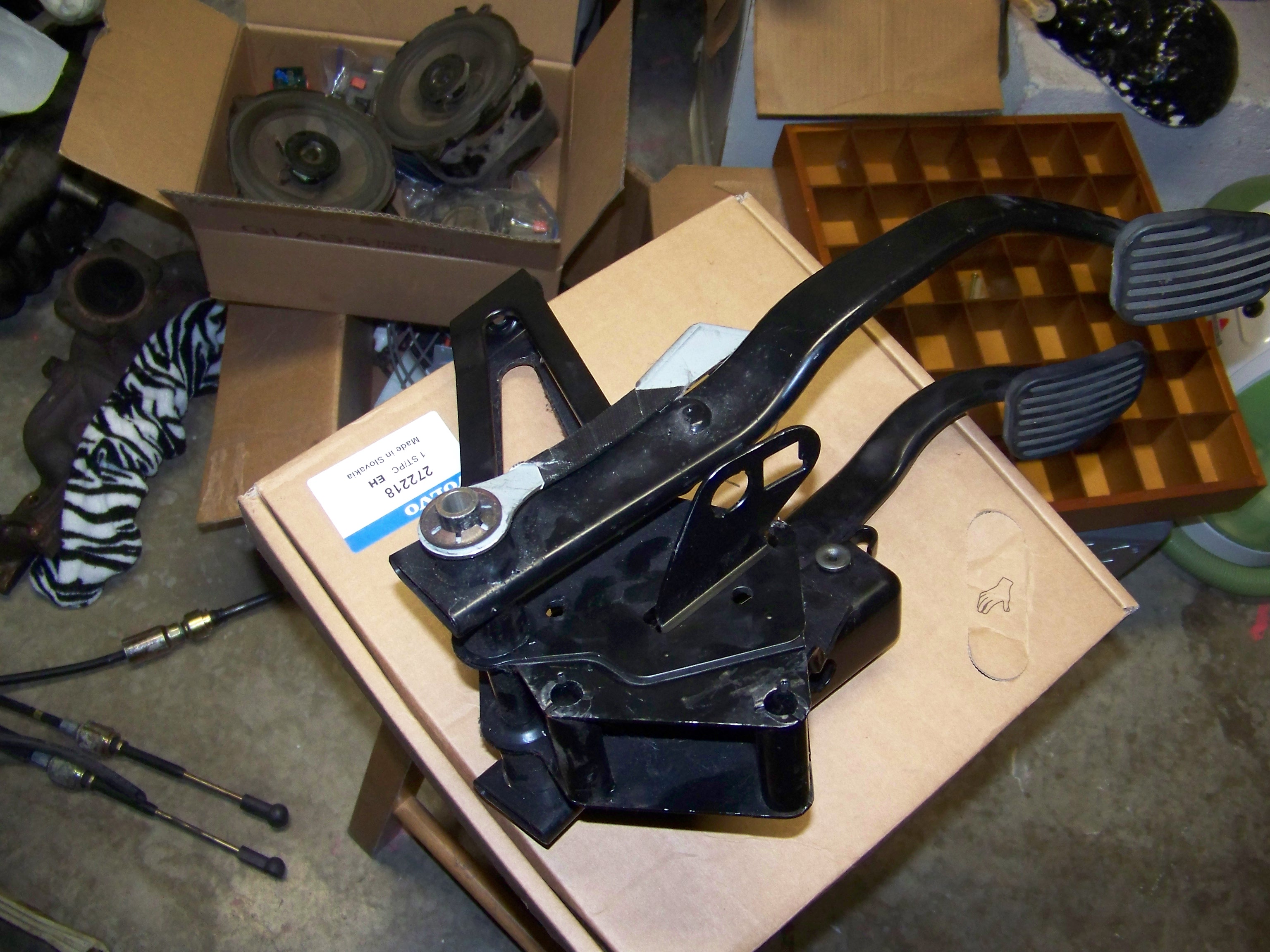

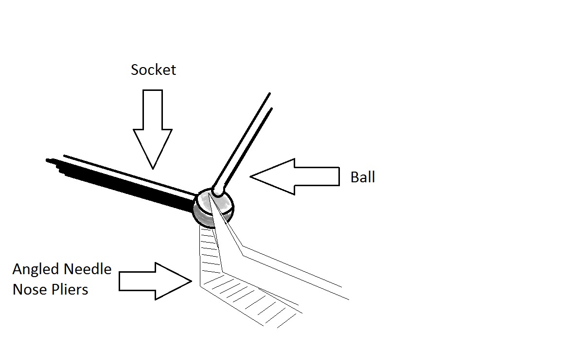

I used the same method as before to install the new clutch/brake pedal assembly. I removed both the brake and clutch pedals from the pedal assembly. With the pedals off I maneuvered the assembly around the steering column and into place, remember to get it onto the stud coming out of the firewall. Once in place I installed the two large bolts and nuts. Don’t tighten these down all the way, you’ll want the assembly to have a little play in it to make attaching it to the firewall a bit easier. Thread the fastener onto the firewall stud, slide the brake pedal onto the rod, and install the bracket that mounts to the firewall. Install a new end clip to keep the bracket and pedal from sliding off the rod. At this point start tightening down the fasteners on the firewall followed by the two large bolts and nuts. Install the brake light switch and the cruise control cancel switch. Follow the Haynes procedure for adjusting the brake light switch.

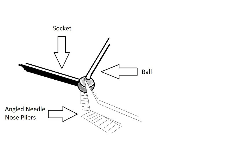

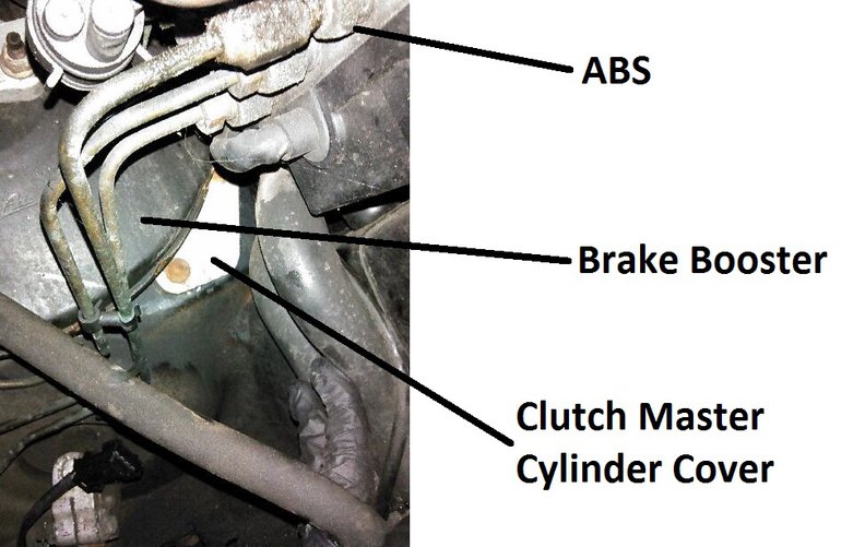

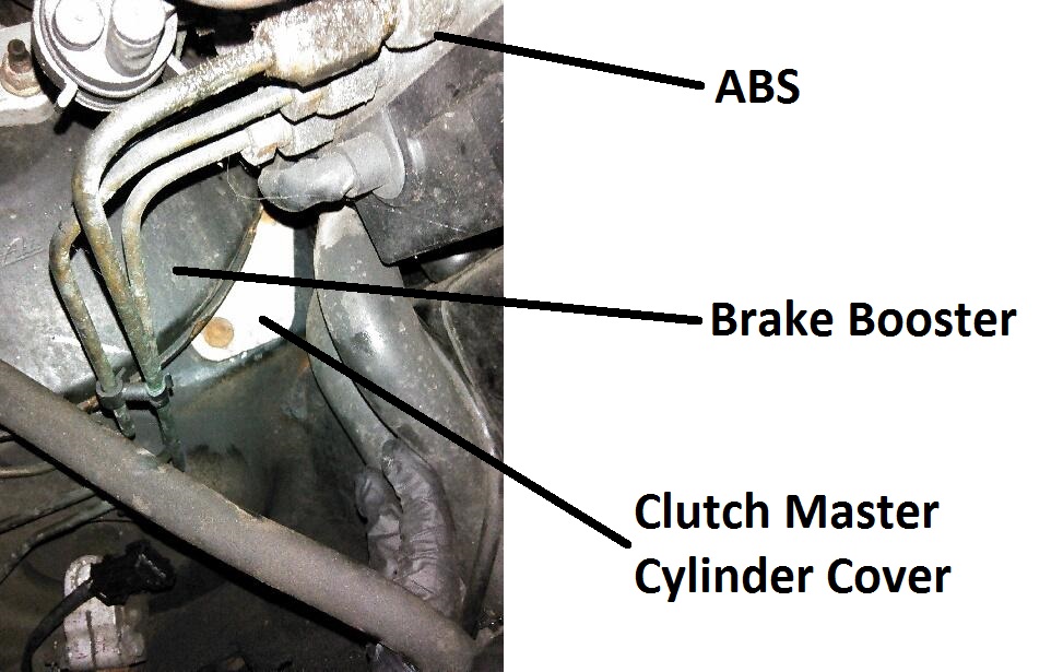

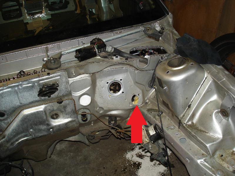

In the engine bay on the driver’s side of the brake booster you’ll just barely be able to make out the cover for the clutch master cylinder. With the fasteners removed from the inside, pull/pry the cover to reveal the opening. There are two drain hoses to the right along the inside of the frame. Removing the zip tie that secures them to the inner chassis will give you a bit more access to the opening.
It seems a lot of people struggled with this part which is funny because for me it was one of the easier steps. I had a helper inside the car and it made things a bit easier. From the engine side of the firewall maneuver the clutch master cylinder into the opening. You’ll have to get around the ABS equipment and get around the brake booster. I have read that at least one person used a pry bar to push the booster out of the way. I have no personal experience doing it that way but it may be worth a try. From the inside have your helper pull and aim the incoming clutch master cylinder rod. Once it is in place secure the two fasteners. One should be a nut the other is a bolt.
With the clutch master cylinder installed, slide the clutch pedal onto the rod and, using a clip (PN: 989037), secure it to the lever for the clutch master cylinder. This is easiest done before you have fluid and pressure in the clutch system so I recommend doing it now. It wasn’t fun trying to fight the hydraulic pressure in the system and attaching that clip. Slide a new clip (PN: 977100) over the end of the rod that the clutch pedal sits on and secure it to the pedal assembly. You'll want to also install the clutch return spring. One end attaches to the pedal assembly and the other clips onto the clutch pedal itself. If you're missing any part of the return spring assembly you'll need to buy an entire spring kit. Tasca has them for $30. Part number is 271805.

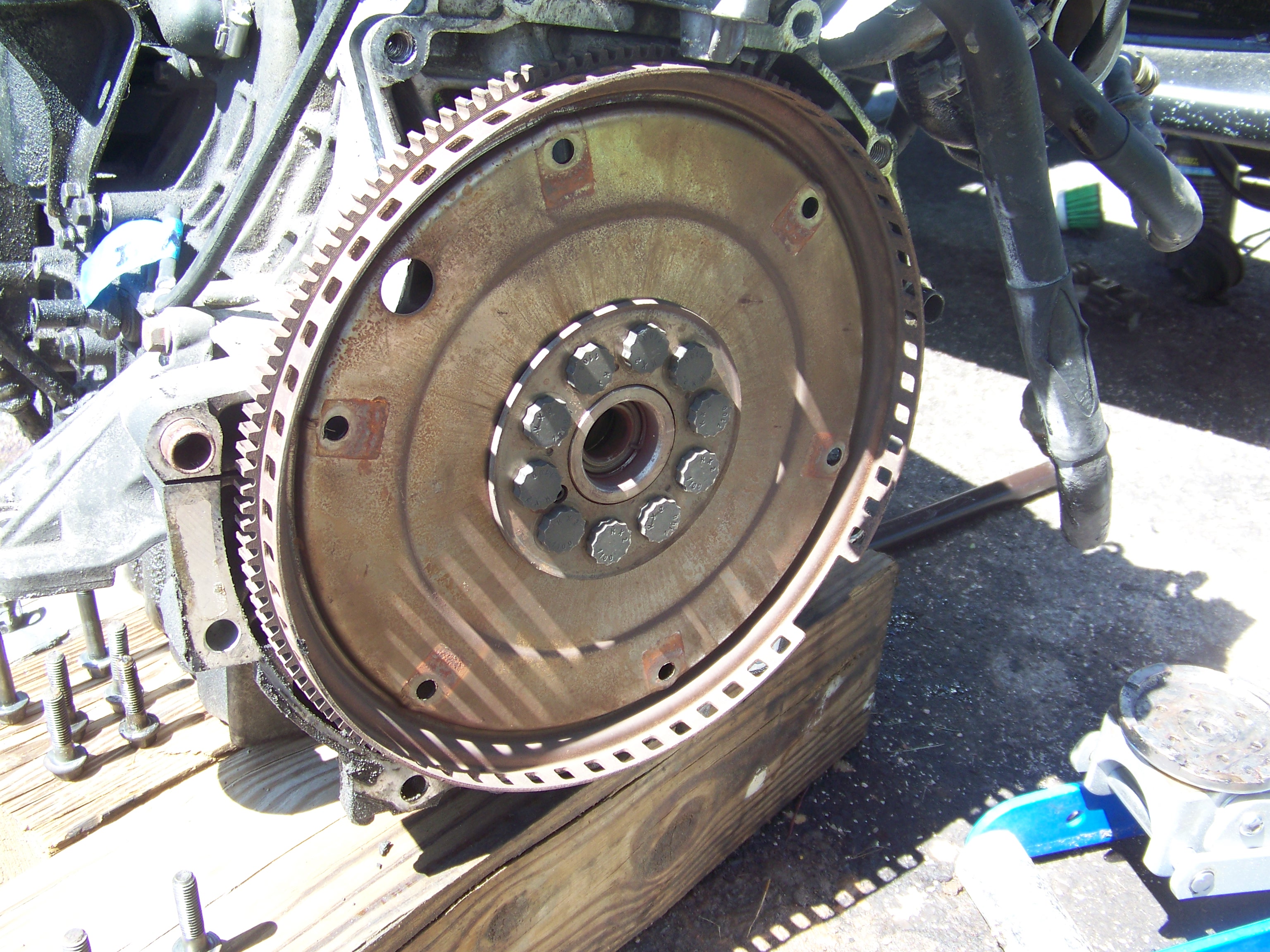

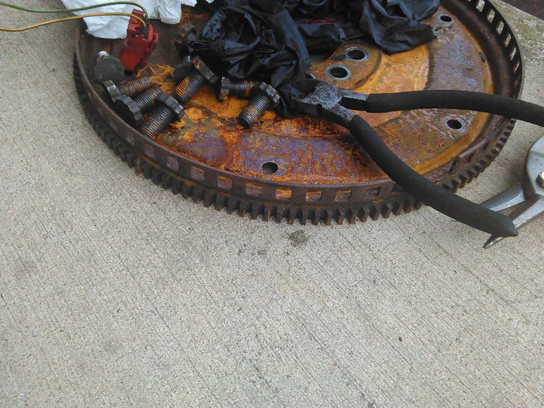

Using whatever method you prefer rotate the crank until the six flex plate bolts come into view. You can access them through the starter opening or the opening near the differential. These should be T50. Next remove the bell housing bolts that connect the transmission to the engine and pay attention where each bolt goes. There are 2 different lengths and you’ll want to make sure they all go back where they belong. Finally, separate the engine and transmission.
With the engine separated remove the flex plate to crank bolts. These were 12 sided 12mm bolts on my car. With the bolts removed, remove the flex plate and set it aside. Use a shop vac to vacuum out any left over thread locker that remained on the threads.
If you’re going to replace the rear main seal now is the time to do it. Using a small drill bit drill a pilot hole through the seal. Find a small screw and a drill bit with a diameter close to but just smaller than the diameter of the screw. Using the second drill bit drill a larger hole through your pilot hole. Start the screw in your drill hole and watch the RMS walk right off. Be very careful not to the mar the crank surface as even small defects here can cause an RMS leak. I drilled at least half a dozen holes before getting this technique to work.
Using motor oil I lubricated the new RMS and installed it onto the crank. I used the old seal and lightly tapped the new one into place.
With the RMS installed and the crank bolt holes cleaned, install your resurfaced flywheel. I have read that some people install a new pilot bearing in the flywheel. As far as I know it isn’t necessary and in no way supports the input shaft of the transmission. This thread convinced me not to worry about it:
http://volvospeed.com/vs_forum/topic/16 ... t-bearing/
Use the locating dowel and install the new flywheel bolts being careful not to cross thread. My bolts already had thread lock on them but if yours don’t you should apply some before installation. I used a stubby screw driver to block the flywheel from spinning as I ran these bolts down lightly with my impact. Tighten the flywheel bolts down in a diagonal pattern to the required torque which I believe was 33ft lbs + 60 degrees. I’m not sure if these bolts changed year to year but on my 95 I used the triple square 12mm bolts. FCP’s triple square socket set came in handy for this; part number CTA-8510.

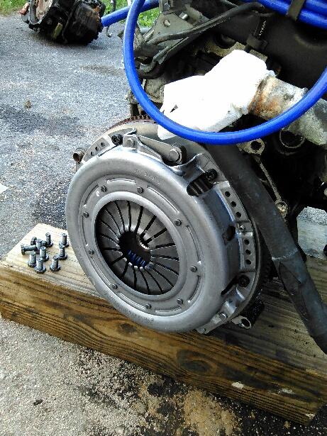

With the fly wheel installed attach the clutch disc and pressure plate next. This part is a little tricky since you have to hold these two plates onto the flywheel with one hand while you work a couple of pressure plate bolts in with your other hand. Once you get a couple bolts started start the rest and snug them down just enough to lightly hold the clutch disc in place. You’ll now have to align the clutch disc by eye unless you happen to have a clutch alignment tool. I don’t have much advice to give here. I just kind of moved the clutch disc around until I thought it was reasonably centered. At that point tighten down the 6 pressure plate bolts to the correct torque which I think was 18ft lbs.

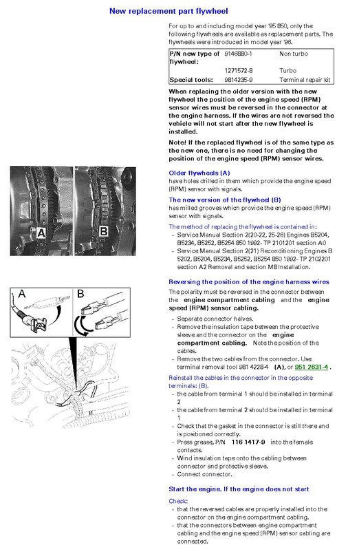

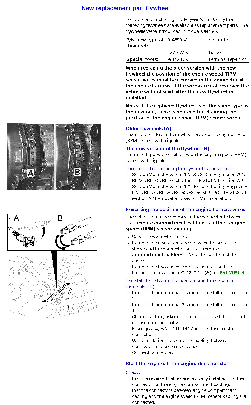

A quick note on flywheels. Depending on which flywheel is used the crank sensor wiring may need to be reversed. Read more here: http://volvospeed.com/vs_forum/topic/16 ... nual-swap/

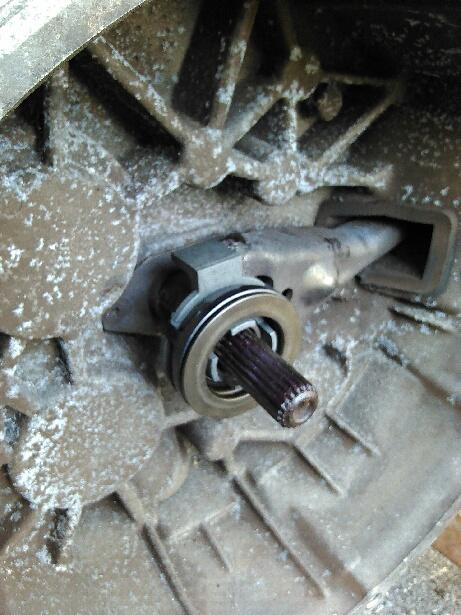

With everything cleaned up and lubed I installed the new throwout bearing and seated it onto the release fork and began lining up the transmission and engine block. This was difficult to do by myself as a result of limited room in my driveway and the rough surface of the black top made it difficult to position the engine hoist correctly. Be careful not to damage the crank sensor when you’re swinging the transmission around. Once you get it lined up, start threading bolts through and make adjustments as necessary. When completely seated, torque the bell housing bolts down correctly. You can reinstall the starter now or wait until later.

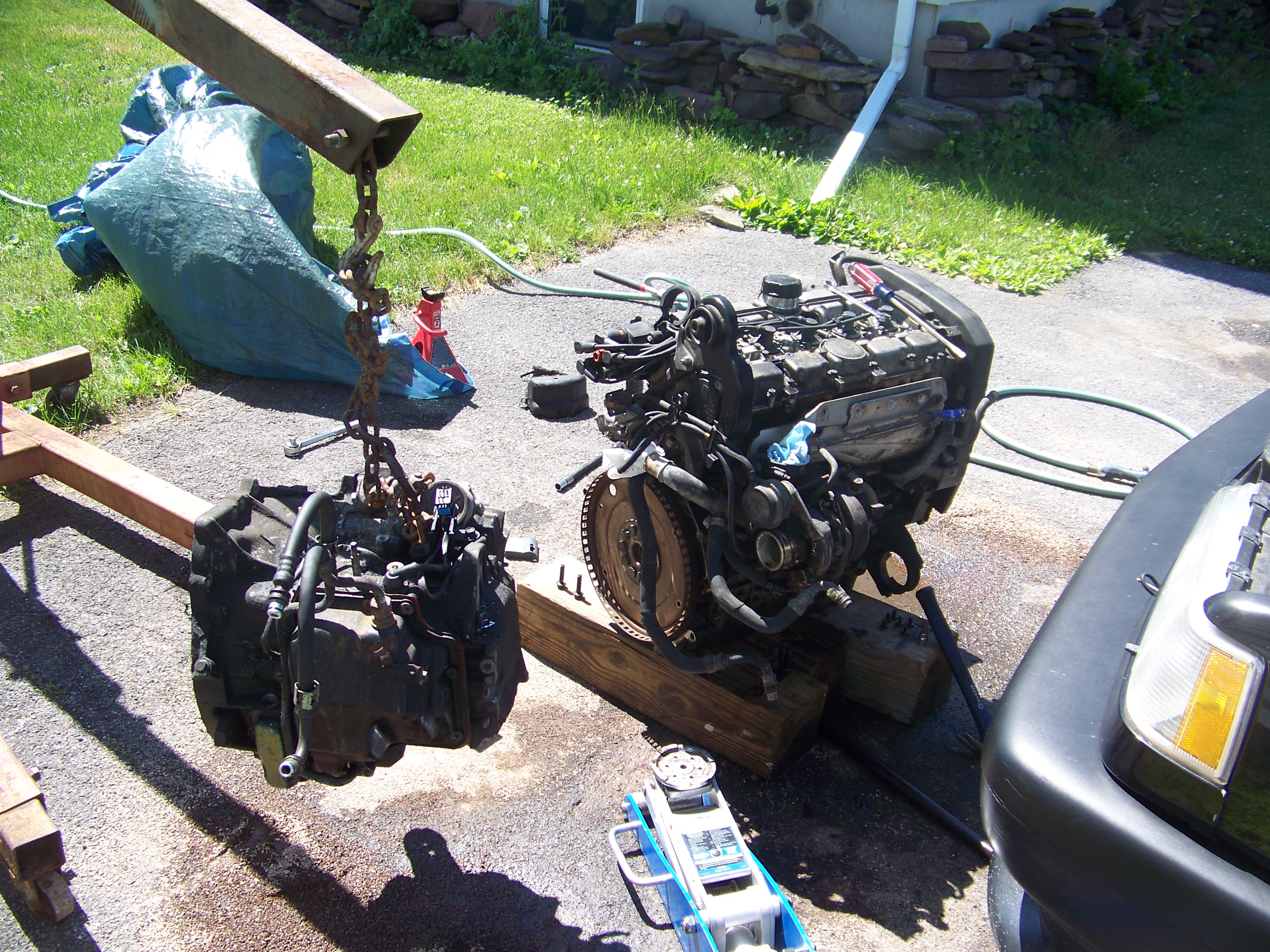

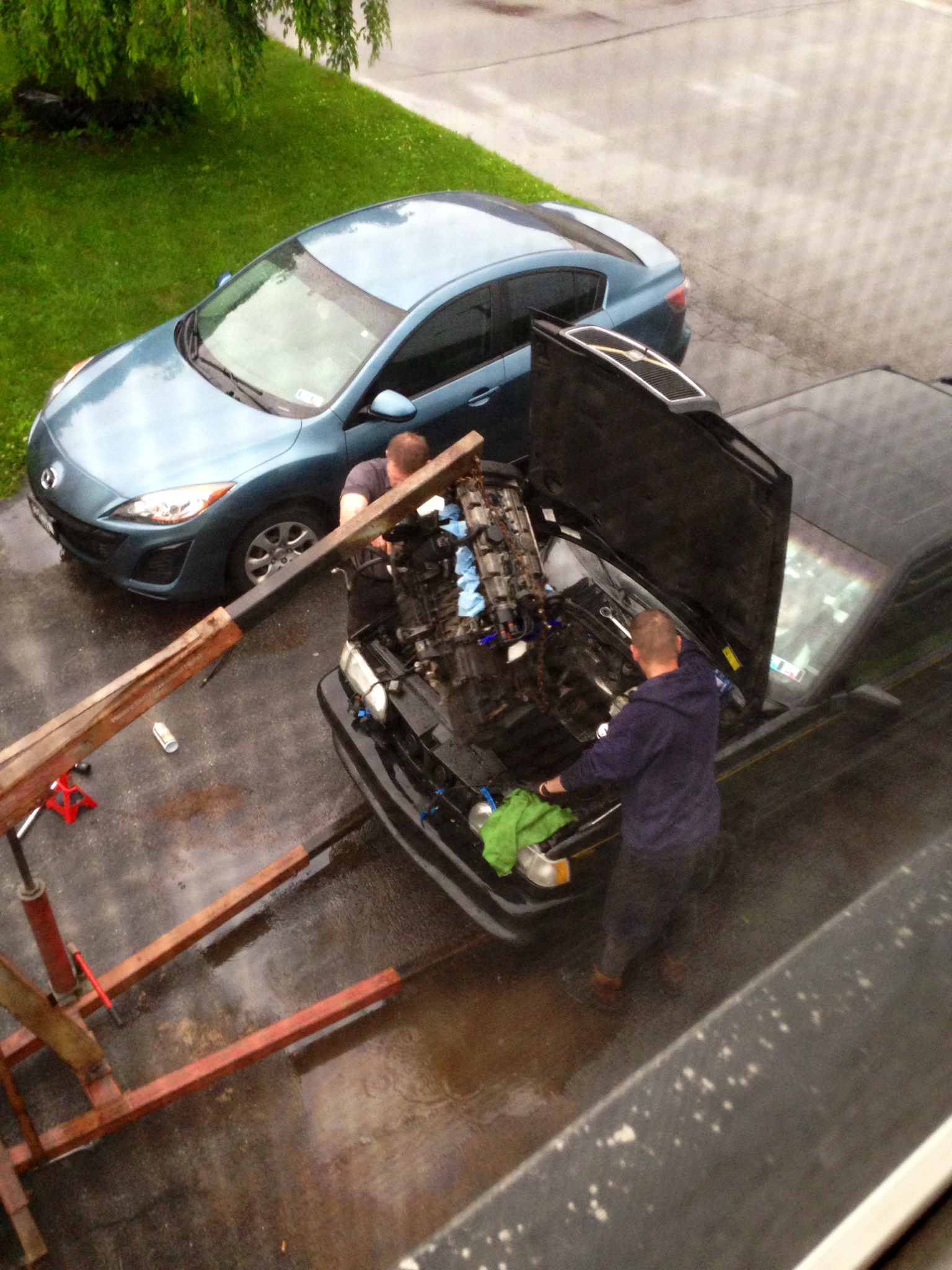

With the engine and transmission attached it is time to put the engine back into the car. Reinstallation is the reverse of removal. If only it really were that simple. If you left the AC compressor in the car remember to attach the two front bolts before you lower the engine all of the way down. Be patient and try to get a friend or two to help with this part.

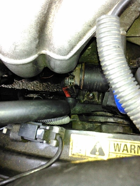

On the starter the two large wires both get bolted on the outer stud/post along with the much smaller radiator fan wire.

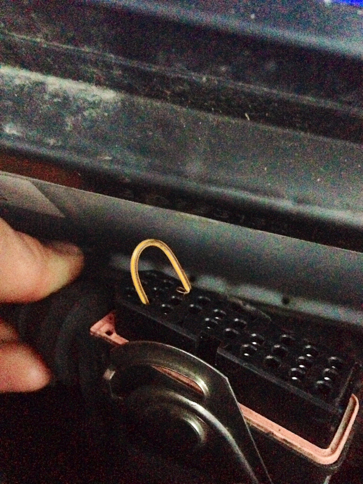

I ran into trouble with the wiring harness on the transmission side of things. On the automatic transmission the wiring harness is made up of a molded plastic sheath that fits nicely over the contours of the transmission case and bolts in place at the back. The newly installed M56 has a different shape and the wiring harness did not fit it very well. Without serious modification I couldn’t get things like the TPS and IAC plugs to reach where they would need to. The plastic sheath comes apart easily and this leaves you with just the exposed wiring. Using wiring loom I covered the wires and used electrical tape to secure everything. With my new flexible harness I moved it around until all the plugs reached as far as they needed to. I expect there is a simpler method to accomplish this but I was running short on time and it was the only thing that came to mind. I’m not very happy with this set up as it leaves a large length of wiring fairly loose and free to vibrate. It also comes dangerously close to the release fork and slave cylinder. If I can find a better solution I would like to revisit the wiring and clean it up a bit.

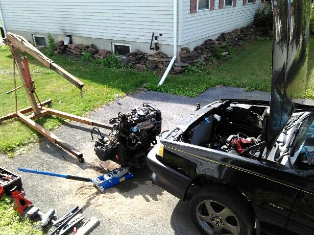

Once the engine and transmission are back in the car I would strongly recommend installing the shifter cables. These cables are stiff and much more annoying to deal with than the single automatic cable was. Installing it now will be easier than trying to do it once all of the wiring is in place. Begin by ensuring the transmission end of the cables are separated from their bracket. This bracket uses two 12mm bolts to attach to the transmission and two collar type clips (part number 3502507) to hold the cables in place. Before beginning, inspect this bracket carefully and ensure you have both clips and that they are in good shape. My cables were actually missing one clip on the transmission side and two on the shifter end. Also ensure the black rubber grommet is attached otherwise reuse the one from the automatic shift cable. This grommet needs to be on the cables before you install them. With the cables separated from the bracket, slide them through the firewall from the interior of the car out towards the engine. Ensure the cables clear the steering column and won’t rub on it. Once the grommet has been pulled up all the way to the firewall begin bending the cables into the center console. One cable has a yellow band on each end, it likely doesn’t matter which side this cable is on as long as both the shifter end and the transmission end are on the same side. Once lined up correctly, slide the cables through the middle and left slots in the black plastic shifter base plate.
Once the cables are through the center console and lined up correctly attach the cables to the shifter. This can be challenging and I wish there had been more documentation on this before I attempted it. I wasted an incredible amount of time trying to get the two cable ends situated on the shifter. The cables and shifter use a ball and socket set up. Place the ball of the shifter at a fairly large angle to the socket and use a pair of angled needle nose pliers to force the ball into the socket. This should make more sense when you see it in person. I also removed most of the old dried up grease and used new silicone grease to lubricate everything.
With both cables secured to the shifter, install the two collars (3502507) to anchor the cables to the shifter assembly. The collar clip for the left most cable will simply slide in from the top. For the right cable, the clip will slide in from the bottom and sits inside the assembly. I didn’t know about this clip at first and spent 2 weeks driving around with a really sloppy feeling shifter and no reverse. With the cables done, install the 4 shifter bolts that secure it to the car followed by the two bolts and plate at the rear of the shifter. Install the rest of the center console and reattach any disconnected wiring. Install the two nuts that secure the shifter cable grommet to the firewall. At this point the interior should be done for the most part.
At some point before you install too many parts on the driver’s side the clutch master cylinder to brake fluid reservoir will need to be connected and the clutch will need to be bled. Again, you should have made sure your EPDM hose is long enough for this because if it isn’t this step becomes an enormous PITA. The automatic brake fluid reservoir has a nipple on the back which can be clipped. Simply clip the very bottom of the nipple and quickly slide your EPDM hose over it. I recommend placing rags beneath the reservoir to catch any fluid that drips down. Once the fluid hose is connected to the brake fluid reservoir you can bleed the clutch to remove any air in the system. I used a power bleeder and feel it was fairly successful. If you have a helper you can also keep pushing the clutch in until there are no more air bubbles.
At this point you’re almost done. Finish reassembling everything in the engine bay and reinstall the seat. You may as well remove the TCU at this point if you haven’t already. The final step is to bypass the neutral safety switch. Using the old transmission connector either plug the PNP switch back into it (make sure the swing arm is turned to either park or neutral) or simply take a short length of wire with the ends exposed and insert one end into pin 6 and the other into pin 7 on the connector. To have working reverse lights install the plug onto the reverse light switch and run the wires to pins 5 and 9 on the transmission connector. I don’t have my lights hooked up yet but I’ve been told polarity won’t matter here.
