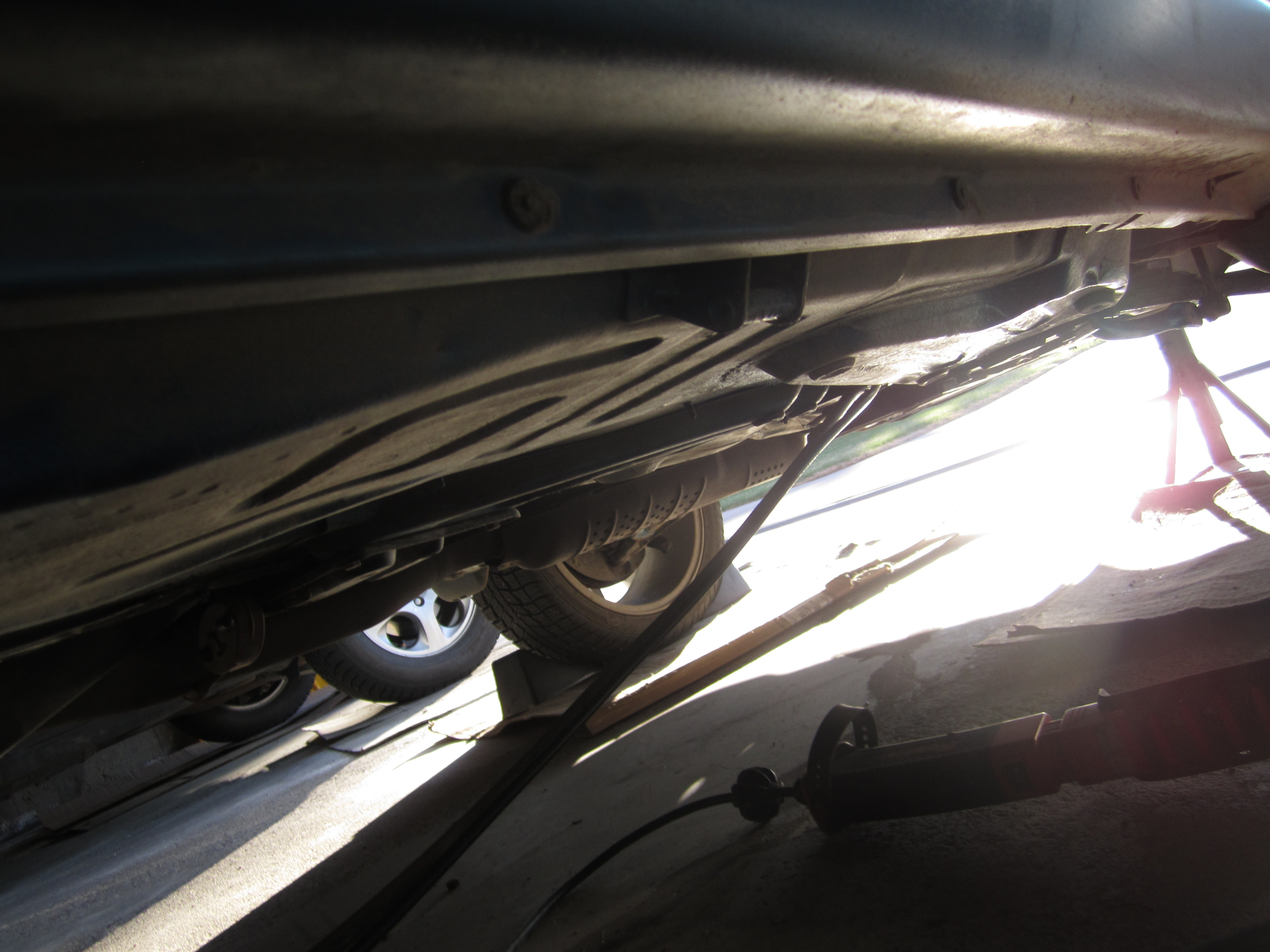

On this model of vehicle (post 1998) there is only one 'fuel' line from front to back. This pipe has an awkward to reach connection to the rear of the engine block on the RH side of the engine bay. With help from the dealer, I have previously posted that this pipe disconnects using a plastic collar that needs to be pushed into the 'dome' of the metal end part of the pipe that runs to the rear to disconnect it. I used a 10mm open wrench to help give more leverage to push the collar in. I'm told the end part (which is aluminum) has a problem of corroding and may make it difficult or impossible to remove. If that is the case, you ma have to cut the pipe to the rear of the connection to the raer of the car, and then have to fish out the pipe to the injector rail to remove the last part. Another way may be to carefully use a small metal saw to slit the connector length wise to allow you to 'peel' the connector off the pipe end without removing the pipe to the injector head.
If you follow the silver pipe in the middle of the picture down to the bottom, you will see a narrow black pipe running L to R in the picture near the steering rack gaiter. That is the fuel pipe from the rear of the car. Some cars may have 2 pipes that connect in the same area.
This is looking from above the connector. Below is the RH axle carrier bearing housing. You can see the plastic push clip that needs to be pushed to the right toward the bell of the pipe to the rear of the car. I used a lot of Deep Creep and let the connector soak overnight and then used the 10 mm open wrench to push the plastic connector into the aluminum bell while gently moving the aluminum pipe end from the rear side-to-side. Eventually, the connector gave up and released.

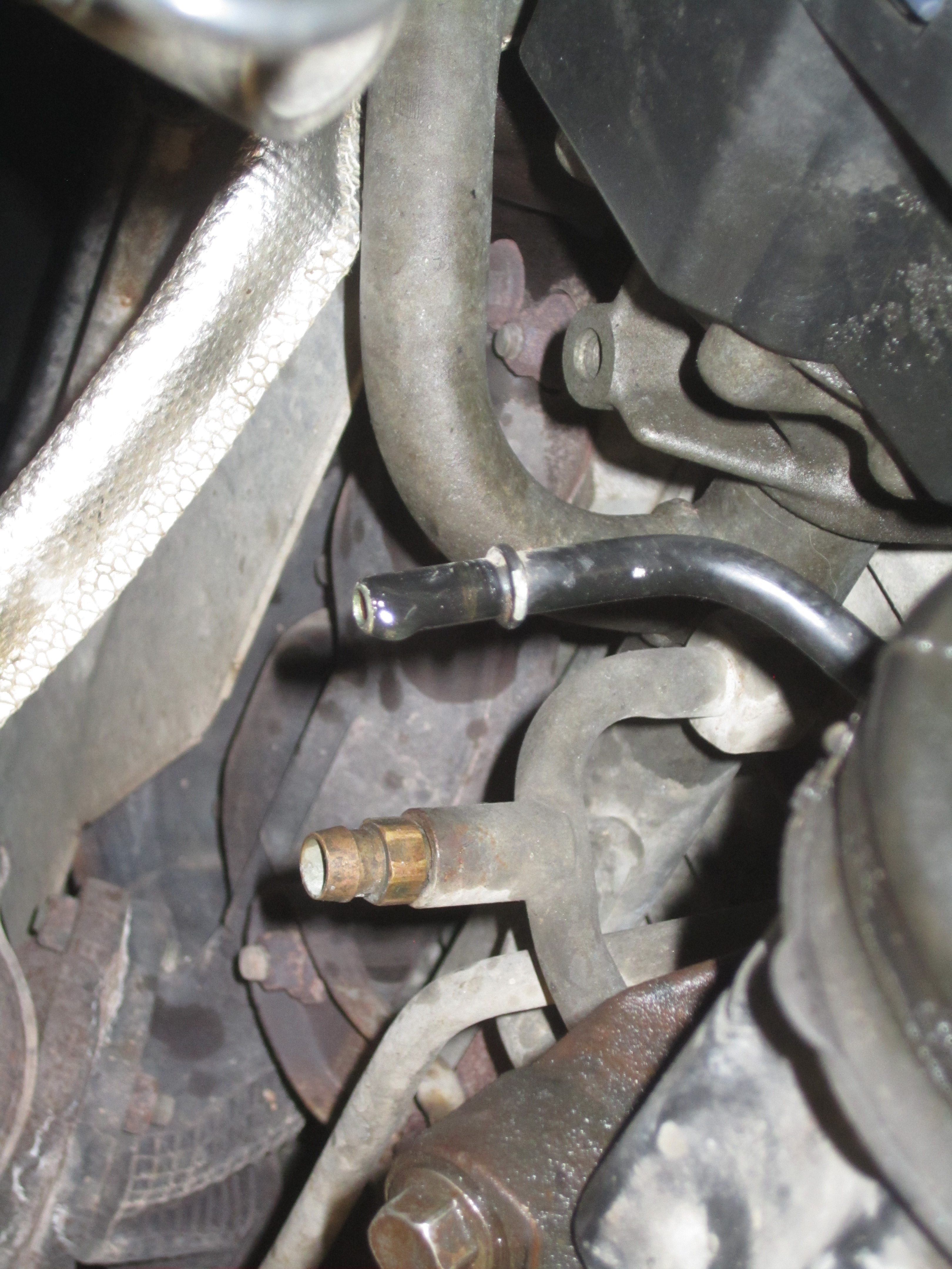

I had considered disconnecting from the fuel filter end on the rear of the car, but the plastic of the fuel pipe does not make it easy to remove it from within the mess of pipes at the rear.
The emissions pipe I did remove from the rear at the charcoal filter and carefully thread it through the system once the axle was dropped.
The emissions and fuel pipes are both run from front-to-back of the car partly running in a channel ender the passenger area.
This connector has a 'barb' on the right side as viewed in the picture. I used a small flat screw-driver to carefully pope the barb loose to allow the fuel pipe to be dropped out. Remember old brittle plastic!!

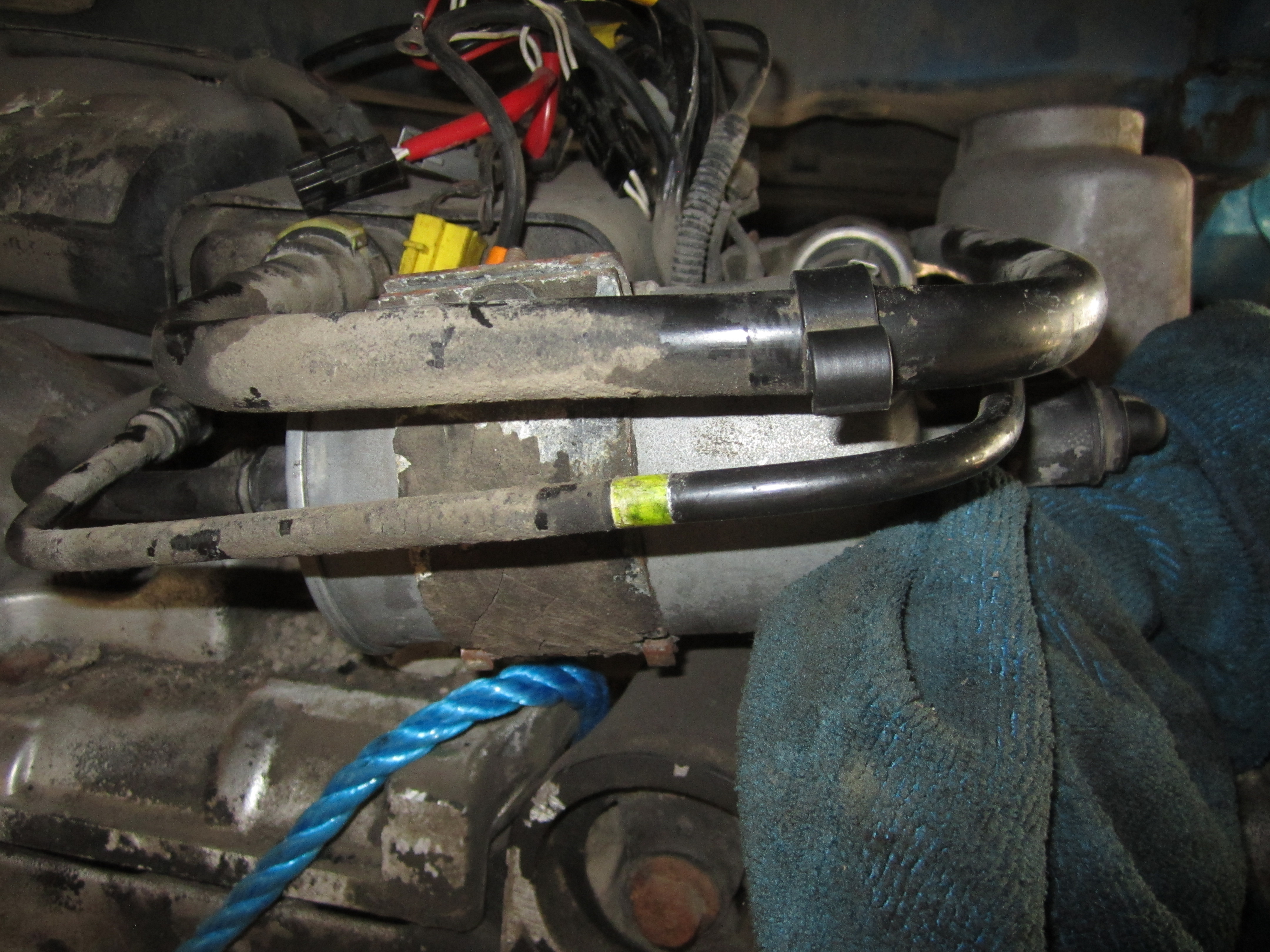

The first point is to add what has gone before. In the last photo, the pipe from the front of the car can be seen running up between the 2 black ‘boxes’ at the rear left of the photo and is GREEN in colour. This ends up on the LH rear connection of the fuel filter.
The next pipe is the run from the RH side of the fuel filter (2 pictures ago) resting on the blue cloth and runs to the RH fuel pump. In the previous photo of the tank, it is the line marked with YELLOW tape starting above my knee on the left side of the picture and running up the RH side of the tank and up between the side of the (left as viewed) RH rear shock tower and the emissions canister (black box to the RH side of it as viewed, up to the fuel filter.

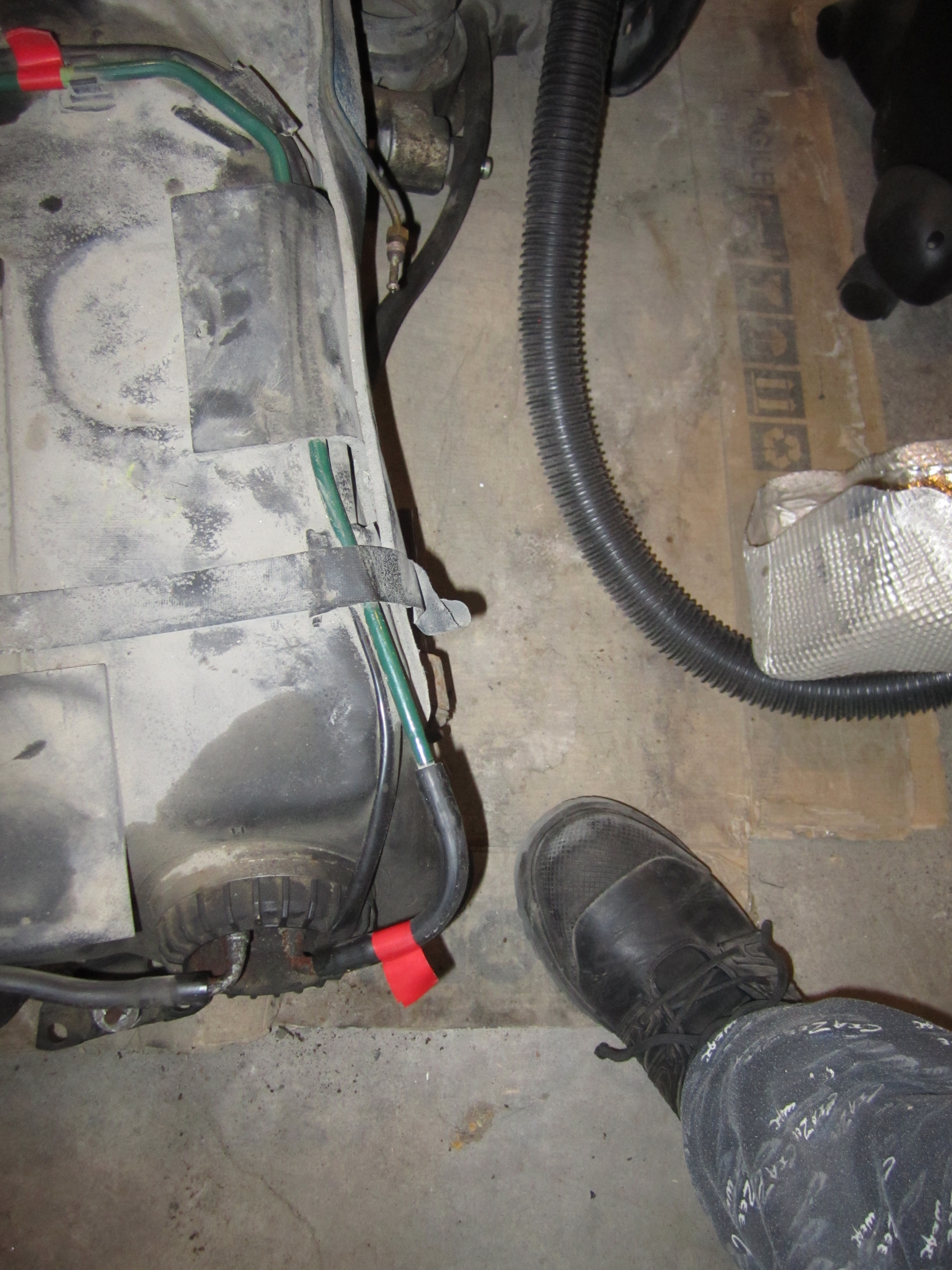

Lastly, the final fuel pump connection pipe is the RED tagged pipe running from the LH front fuel pump (lower RH side as viewed above), and runs down the LH side of the tank and across the top back of the tank to the ‘silver’ fuel pressure valve at the rear RH (top LH as viewed) of the tank. There is a RED tag just to the right of the fuel regulator. The pictures below give a better view of the positioning of the pipe run:
The pipe ends at the LH RED tag as viewed above.

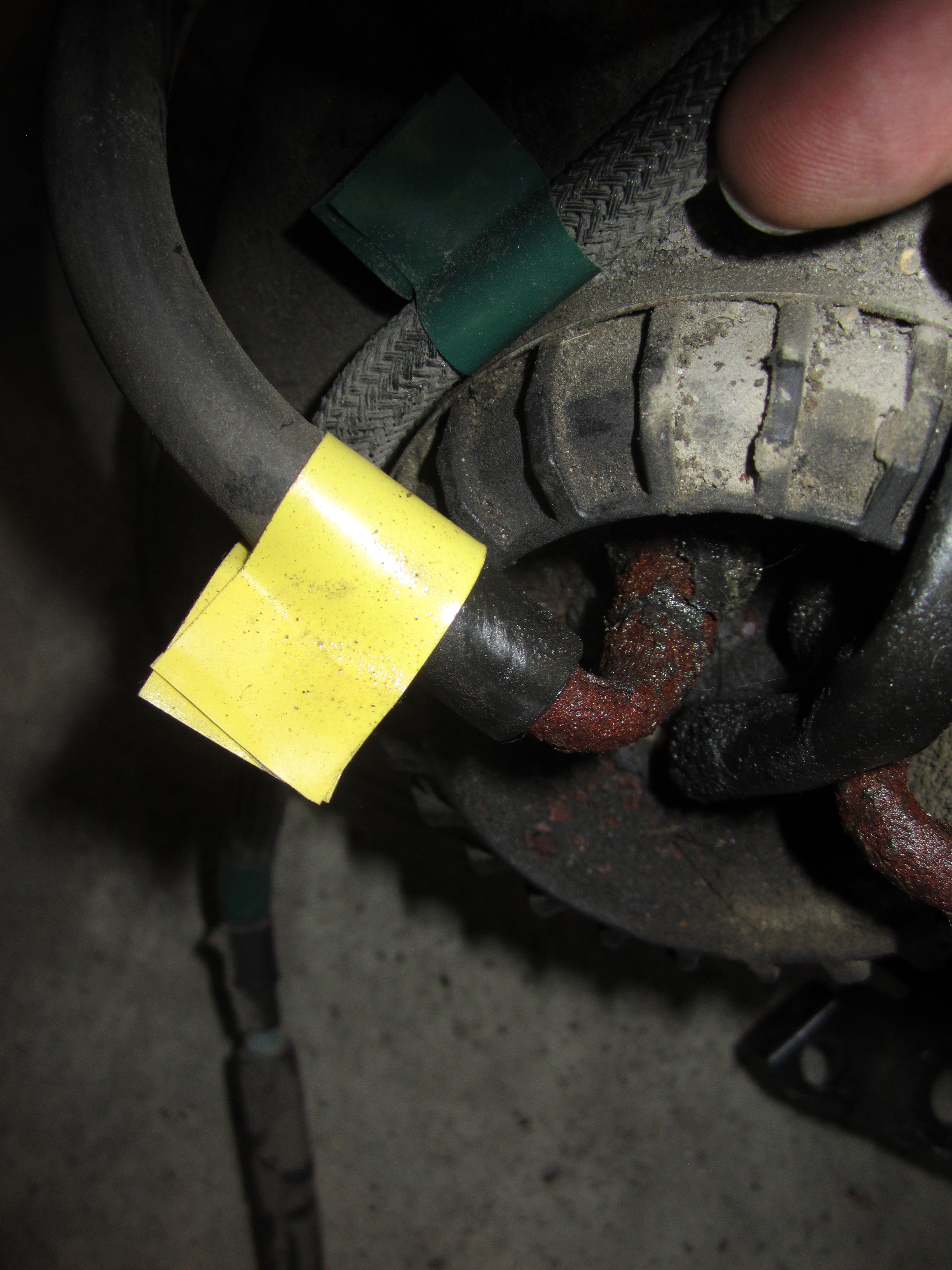

RH side of fuel filter. Pipe is YELLOW tagged and runs to the right.
The yellow tag on the LH side of the picture is the one seen in the previous picture. You can see the pressure check valve in the middle of the picture and pipe continues to the right to next tag. Just above the valve you can see a black clip. The emissions pipe from the front of the car runs up through this clip.

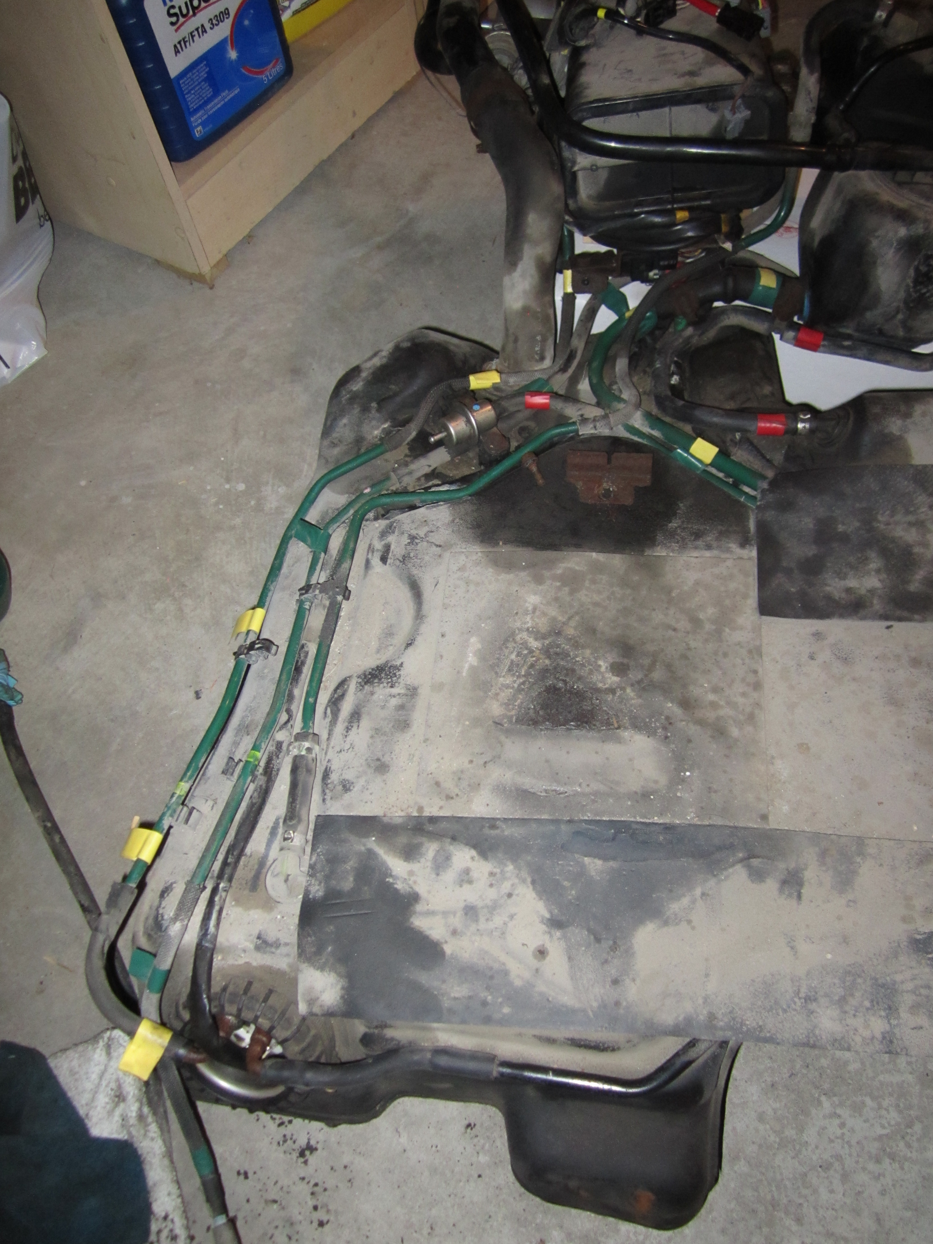

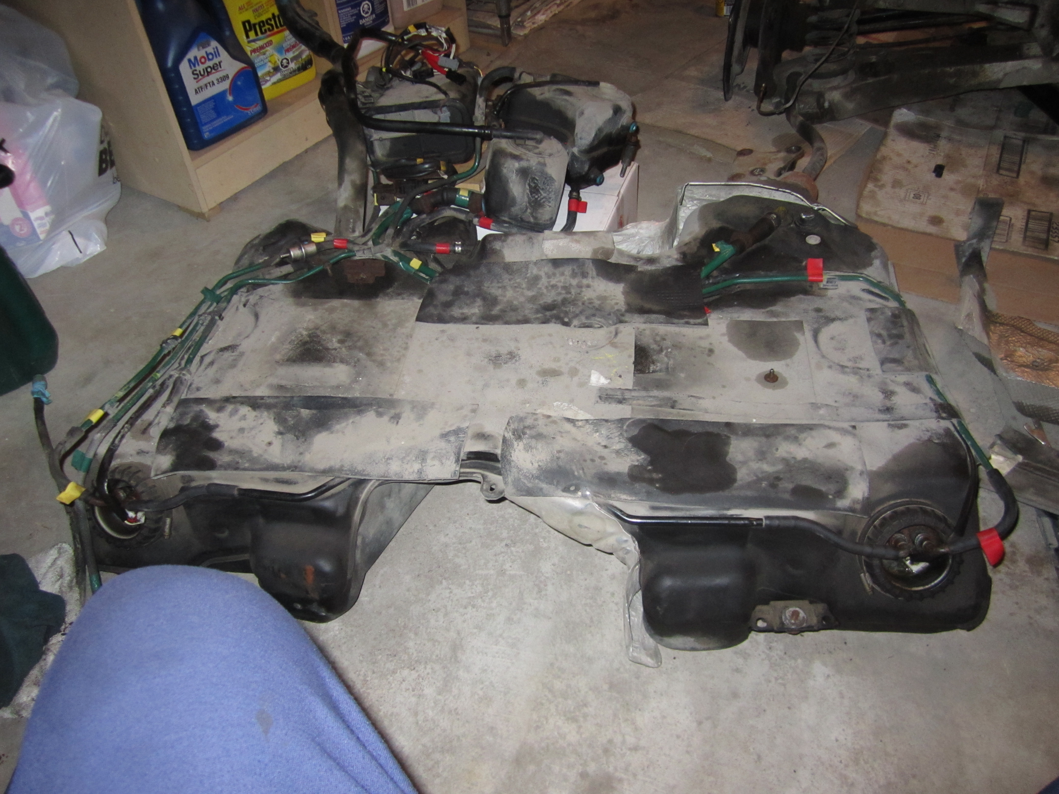

Returning to the picture of the whole tank:
This is a little confusing again, as you are looking from the FRONT of the car towards the REAR in the above picture so LH is RH and vice versa.
There are 4 pipes we will cover in this portion. 3 connect to the top of the Fuel tank at one end and connect to the small ‘header’ tanks at their other. The 4th connects from the top of the smaller header tank to the Emissions canister.
Looking at the picture above, The 3 connections are as follows:
1) Top middle back/rear of the tank. Pipe has 3 RED tags and runs to the lower connection of the rear-most ‘ larger’ header tank. It has a ‘T’ at the ‘middle’ RED tag that runs to the Evap. Pressure sensor positioned under the rear of the Evap canister.
2) This runs from the lower LH (as viewed, but RH front of the tank top) up to the top of the larger expansion tank.
3) This runs from the top RH (as viewed, LH rear of tank) across the top of the rear of the tank and connects to the bottom of the smaller expansion tank.

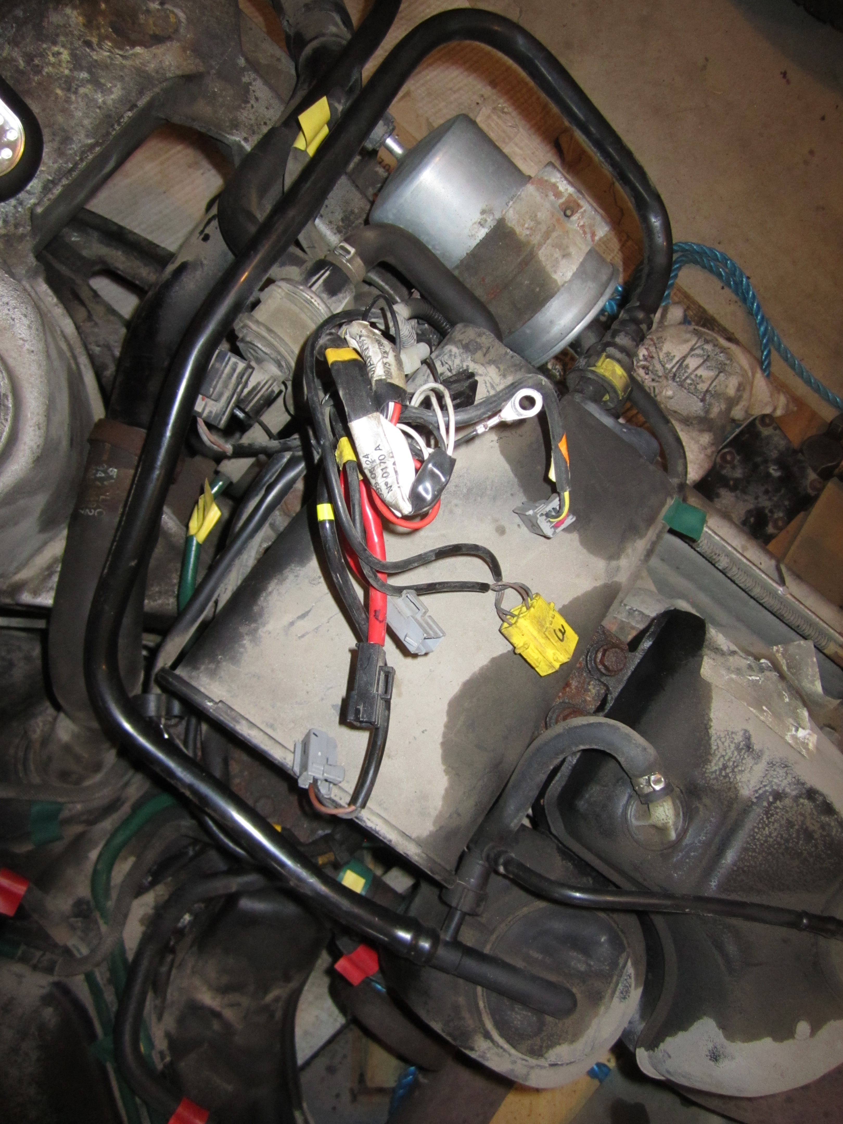

Viewed from the back of the car, the EVAP. Canister is the large rectangular object in the top left of the photo. The pipe is the short black pipe that runs to the roll-over valve. The valve has a ‘T’ which connects to a pipe that runs to the filter mounted to near the top of the fuel filler pipe.
I’ve added the above picture so you can see the 3 connections to the rear of the Evap. Canister. The pipe to the roll-over valve is still connected, the larger of the 2 connections to the left connects to the pipe that runs to the top of the 2 expansion tanks (pipe with the yellow connector. This you push down on the yellow portion to release). The smaller connection to the left of this is the connection to the pipe that runs to the front of the car to a valve at the top LH corner of the radiator. This is the pipe that runs parallel to the fuel line under the car.
