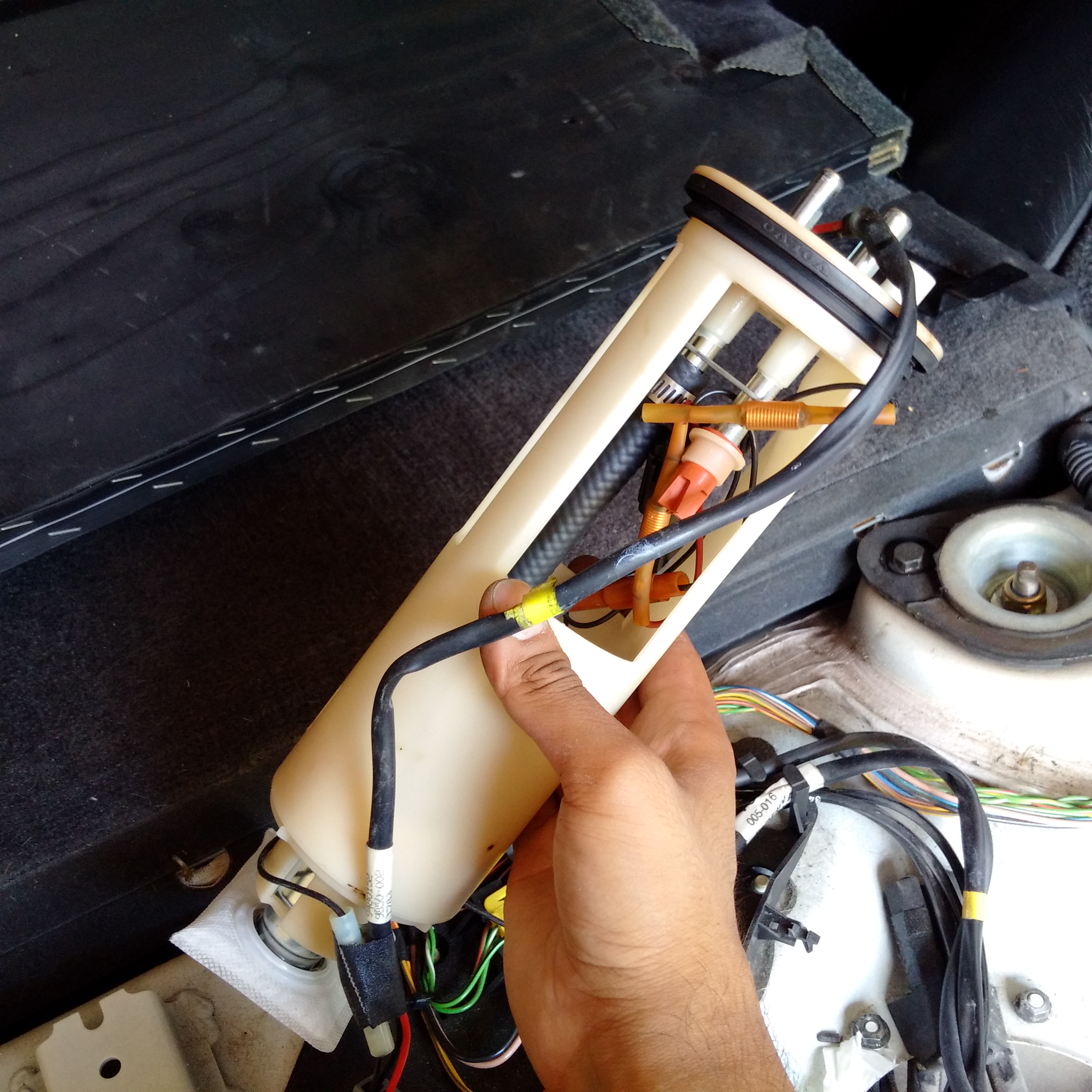

Upon removing the pump itself, we see another change from the older cars: rather than two spade connectors, the fuel pump has a single plastic electrical connector:
And on the other end of the cable, there is a ground wire that provides continuity from the pump to the pump bracket to the connector to the chassis of the car. It can be seen in this photo, looped through the pump cap:
The pump that came out when I took the cartridge out of the bracket:
No metal spring, as in the earlier cars.The sock underneath popped off with some encouragement from a screwdriver. I pushed the tab out of the way and the pump slid out pretty easily.
The Walbro is not sized for this pump cartridge. The kit came with a closed-cell rubber foam tube that was supposed to be a sleeve to help the pump fit in the 850's cartridge. I cut a square of this out to help the pump fit in the V70 unit instead. It slid in without too much force, but the pump is going nowhere. With the pump installed:
The Walbro kit was put together very thoughtfully. Of course it had the pump and the filter "sock" for the inlet, but it also had the rubber sleeve, a fuel hose, two new worm-drive clamps, and (this really warmed my heart) an adapter to connect the Volvo fuel pump plug to the spade connectors on the Walbro. I cut the fuel hose to length, which ended up being about the same as the old hose, and reassembled.
Reinstallation is the reverse, but I hit one surprising snag that turned out to be the hardest part of the job: screwing the cap back onto the fuel tank, it seemed that it just would not go on straight, becoming cocked and frustrating me for like fifteen minutes. Finally, reasoning that the cap was flexible and would bend before it stripped the threads, I just grabbed my oil filter pliers and started turning. Sure enough, I heard a thud and the threads snapped into place, letting me screw the cap down securely.
The Walbro was surprisingly loud, a virtue for which it is apparently famous: turn the key and hear a little whir before hitting pressure. But a few cycles of the key later I had full pressure at the rail. Still have some reassembly of other bits to do before I start the car, but I'm happy with the result, and the price was great. All told, a pretty easy job at a relatively low cost, and I was really happy with the kit that let me do a drop-in replacement without having to use my brain.
