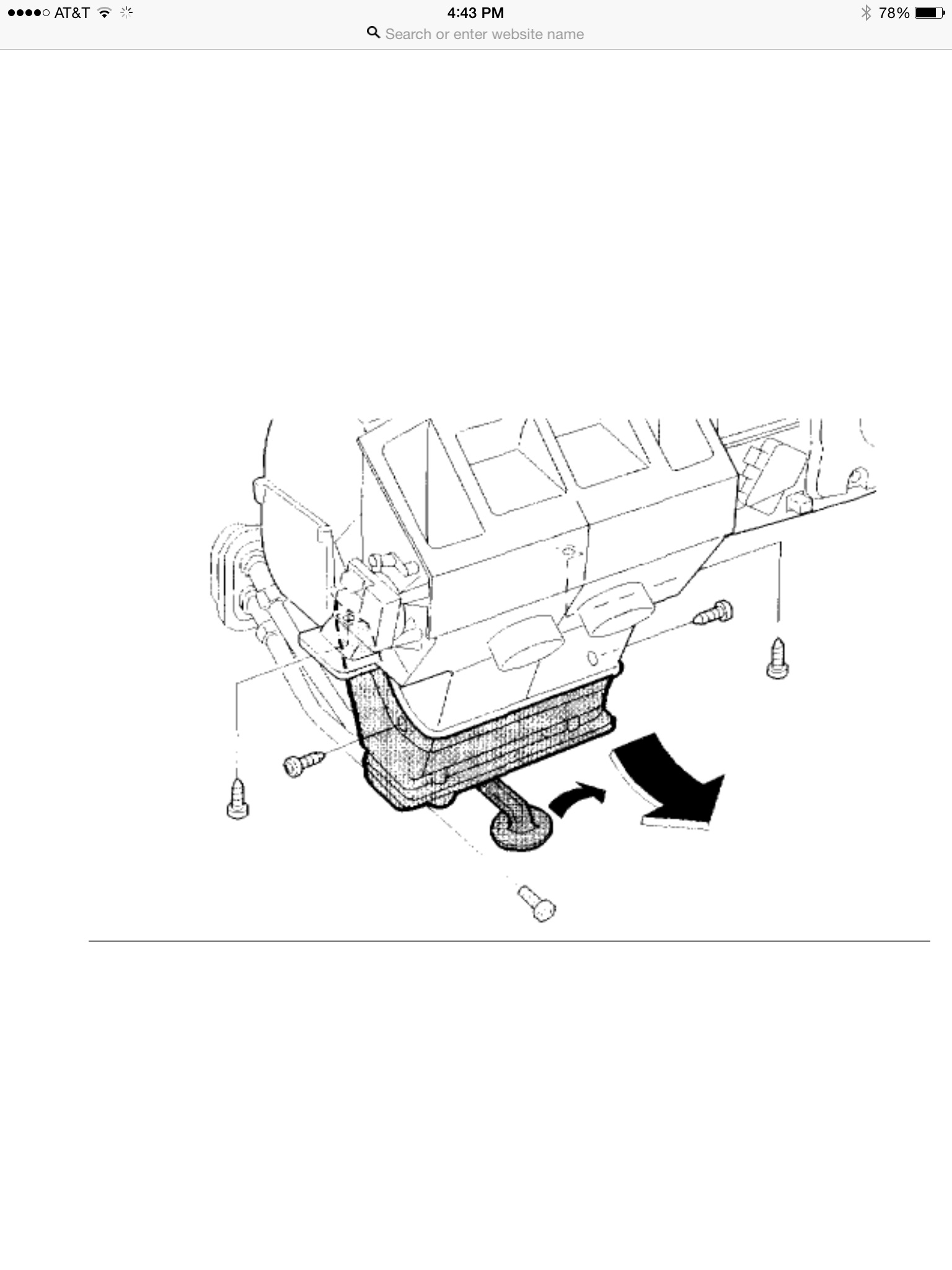

The old one is probably still full of coolant.
This is an easy job if you still have all the parts, I would make a trip to Volvo and get the VIDA picture and inventory what you need to complete.
It's the flange and pipe bits in this pic you need to make sure you have
