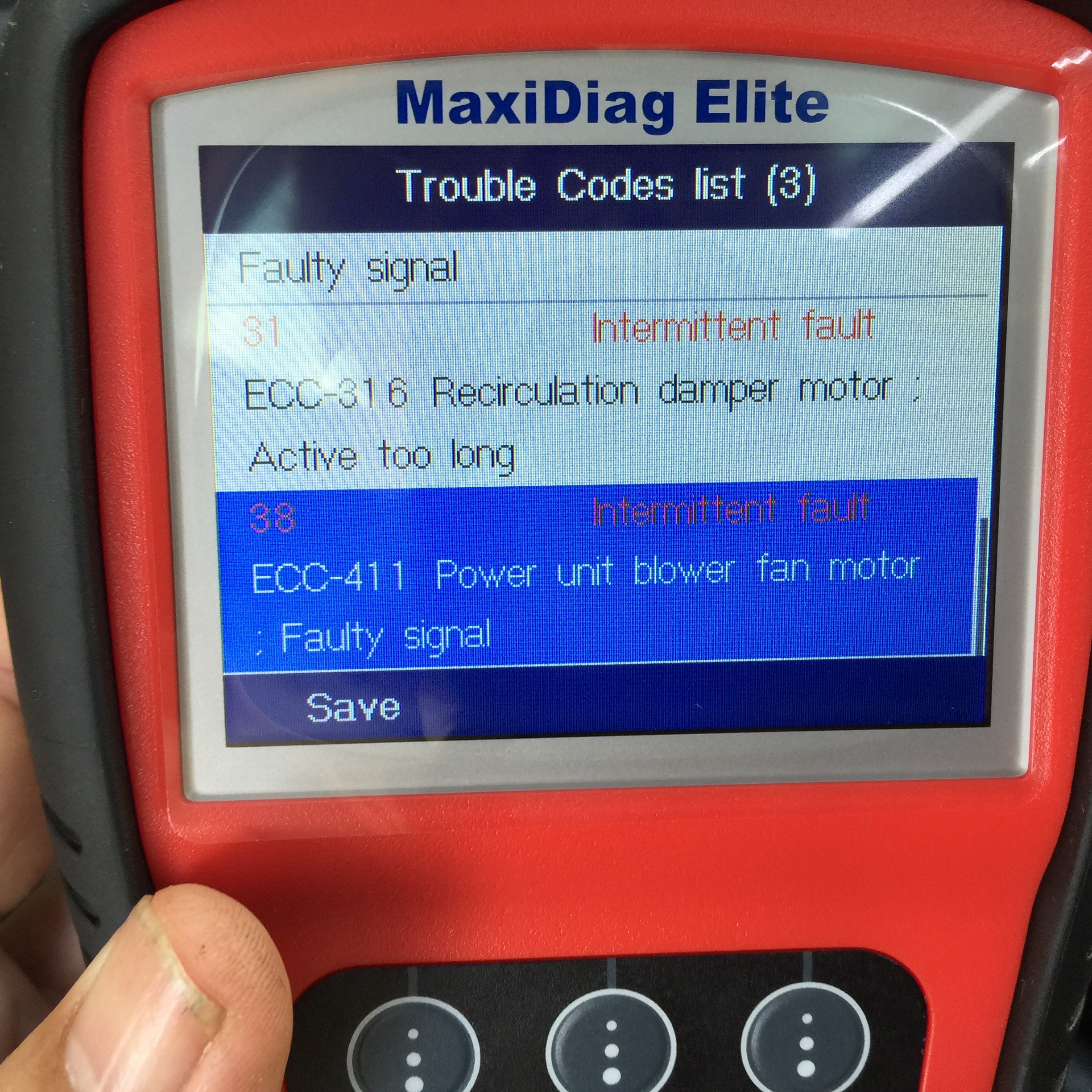

I just picked up an AUTEL 802 cheap, its usually about 250 USD on amazon, but it reads and clears a lot of codes on our fleet of Volvo VW and BMW.DRNewcomb wrote:So, the VIDA + DICE is a sort of Volvo-specific tool. I suppose you get a choice of either being generic and limited in what can be diagnosed or vendor-specific and able to do more things. The problem is that we currently have a Volvo, a Mercedes and a VW.
I just cleared an SRS on the Beetle , for instance.
It reads out the Volvo specific error codes including my ECC codes on my 1999, too.
