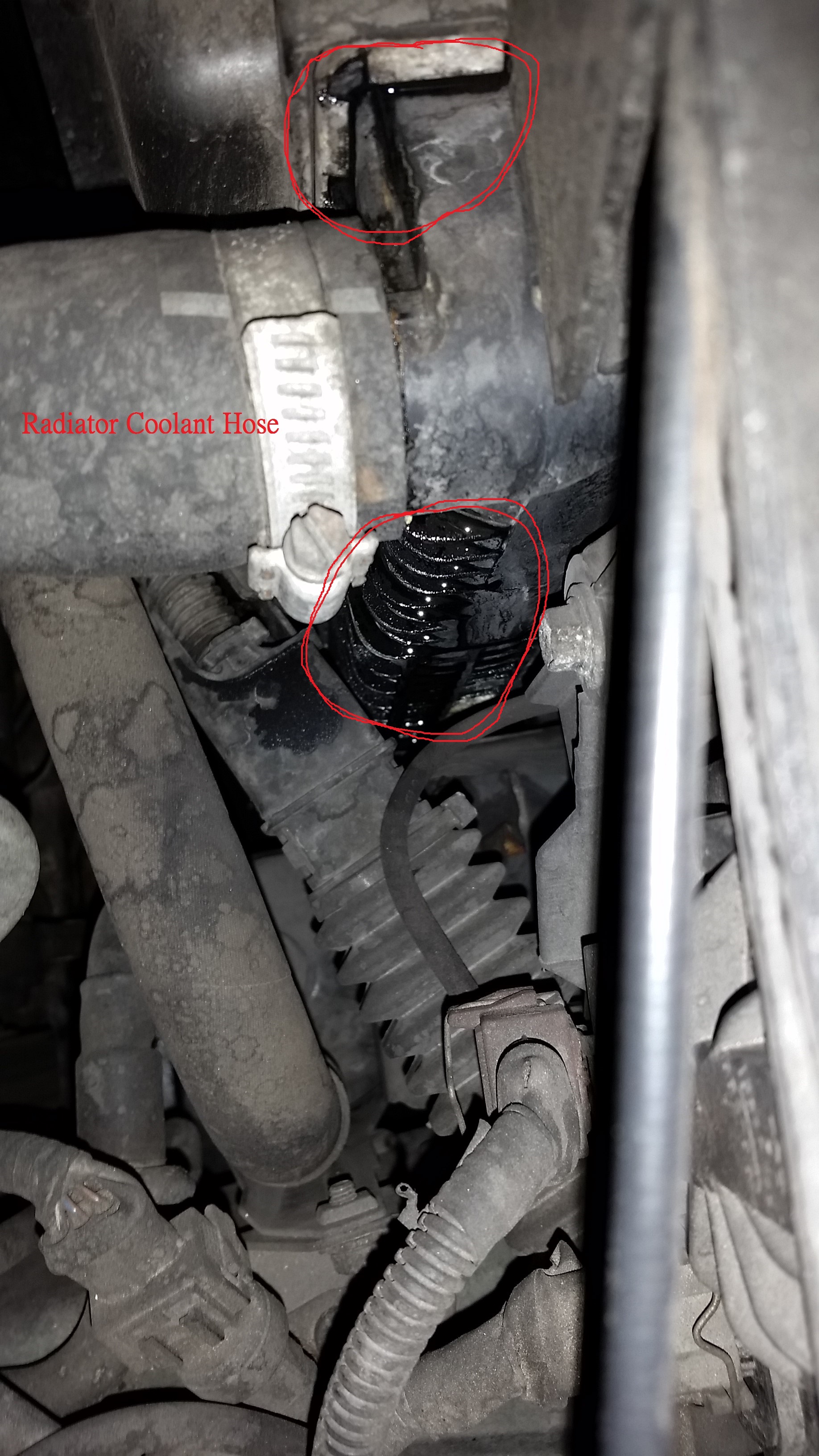

Once again needing some help and advice on solving a problem. Just discovered a few days ago that my coolant was low, warning light came up on dash, checked the coolant in the reservoir, which was low. Topped it up and checked it the next day, it was fine, but checked again after 2 days, it was down by about 1/2 inch from the max line where i topped it off to. Topped it off and few days later found some drips under the engine compartment on the passenger side. Opened the hood and found this shown below in the picture
I believe it is the radiator leaking, can anyone confirm this from the picture? So far I have been checking coolant every morning and topping it up asap if it was low. The temp seems fine right now, didn't notice any fluctuations.
Thanks in advance.

It does look like a leak at the plastic Al joint of the radiator.
No stop leak or " miracle sealer in a can" products unless you need less than 3 months of life out of the car.
The Nissens radiators seem to be holding ok as a lower cost alternative to factory

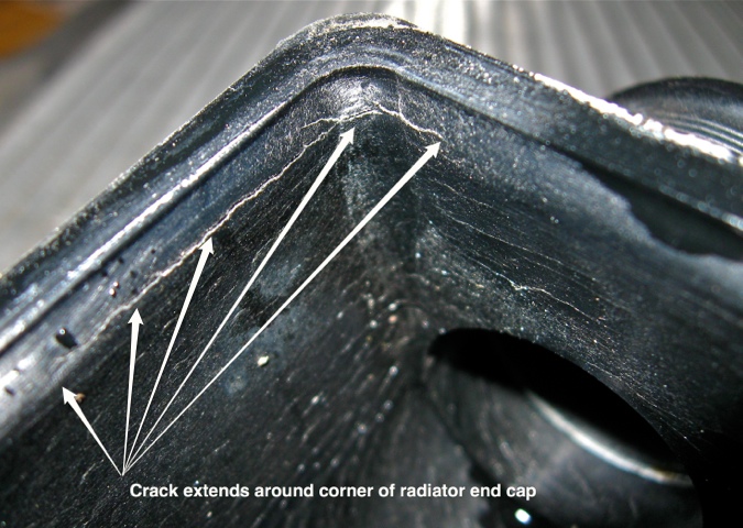

My radiator cracked at the same place. I replaced it with OEM. Afterwards I cut the old radiator open and took a look at the crack from the inside... wrote it up here:
https://www.matthewsvolvosite.com/forums ... =1&t=55629
