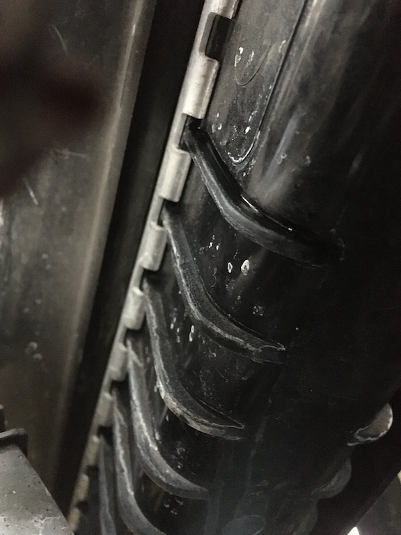

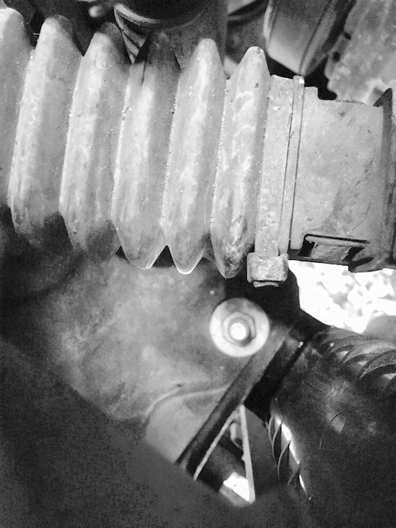

I parked my car this morning for a couple of hours. When i picked it up back, i saw a puddle under the car, on the front, passenger side, under the radiator.
As I don't want to mix extra coolant with Volvo one, i ordered a bottle of 'ready to use' to make the level. I think that to have travelled by 35 ° last week to reach holiday place (at 90 km/hour) was a bit much... This car has spent 20 years in saudi Arabia. Plastics may have been cooked. The radiator is to replace.
Do you think i can drive home without to worry much ?
Is it possible to keep and re use the coolant if it is clear ?

Since yesterday, no lost of coolant, so i think it leaks whenn the system is under pressure, so, it may only be a matter if hose. the car will bring us back, just the liquid level to control.

Make sure the low coolant level light is working, drive home keeping a close watch on it. Stop every hour to get a feel of hoe fast you are losing coolant.
The Nissens or Behr are both good replacement brands

My 2001 V70 T5 developed a radiator leak at the hose neck at about 180K miles. It was slow leak and only under pressure. I replaced before it got worse so I would not have to worry about a sudden, large failure.

I've replaced two radiators on my 850. It was the joint between the plastic side tanks and the metal radiator body.
