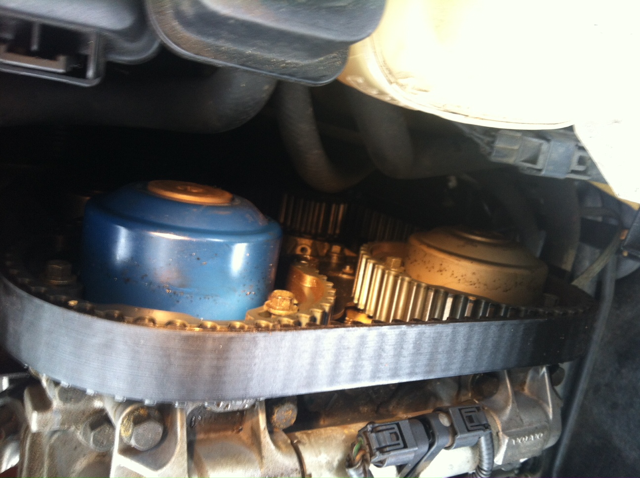

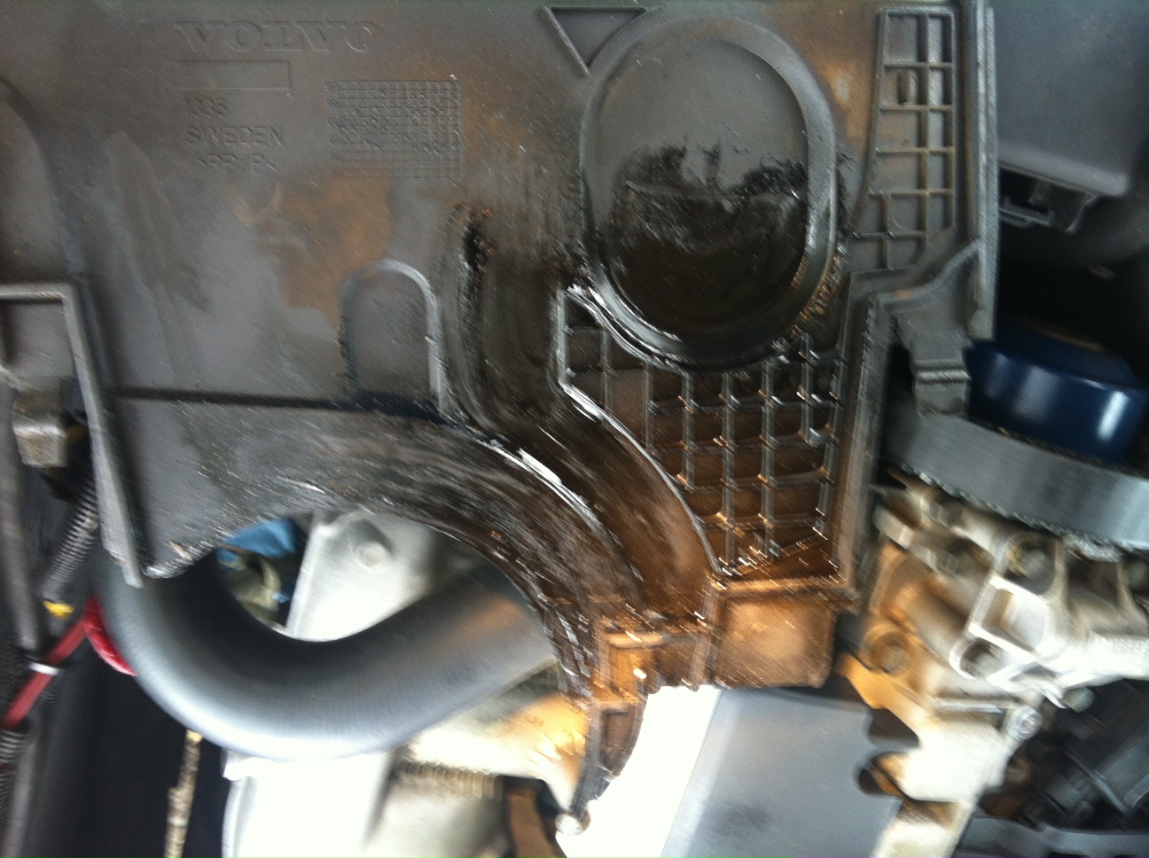

So it has been a month of trying to figure this out while funds had to go elsewhere, took throttle body back off and then had a go at looking at timing belt.
This is what I found, it would appear that there is oil/grease on the lower timing belt area I am uploading some pics, I also noticed when I took the timing belt cover off that there seemed to be oil on the bolt holding it on. Is this an indication that I need to do the PCV?
Regardless of how this looks I do not think it is the reason for the car not to start. Am going to pull the relay for the fuel pump today or tommorrow (located underneath main fuse tray in engine compartment) to check that, is there a relay for the fuel injectors that I should check as well?

Okay three issues to look at.
1) Oil leak-check for a visible source, cam seals, cvvt sprockets, piston squirter bolt (near water pump), or a trail from top of engine.

Thanks for the reply! So am pretty sure that the cam seals are leaking at this point, the grunge on the bottom of the timing belt cover says to me that it was a pre existing condition to my purchase. Did the old glove on the oil filler and had a proud high five, sigh, how pressing is this, if i can wait another couple of weeks (months?) i can better financially afford to do this... but if it needs it now...

Pop up ypthecdipstick. And vent the gas down below the car until you can get to cleaning the PCV, the team, and the engine block
The P2 cars need to be really abused to plug the PCV by the way. Do a couple of early oil changes perhaps with a desludging agent
