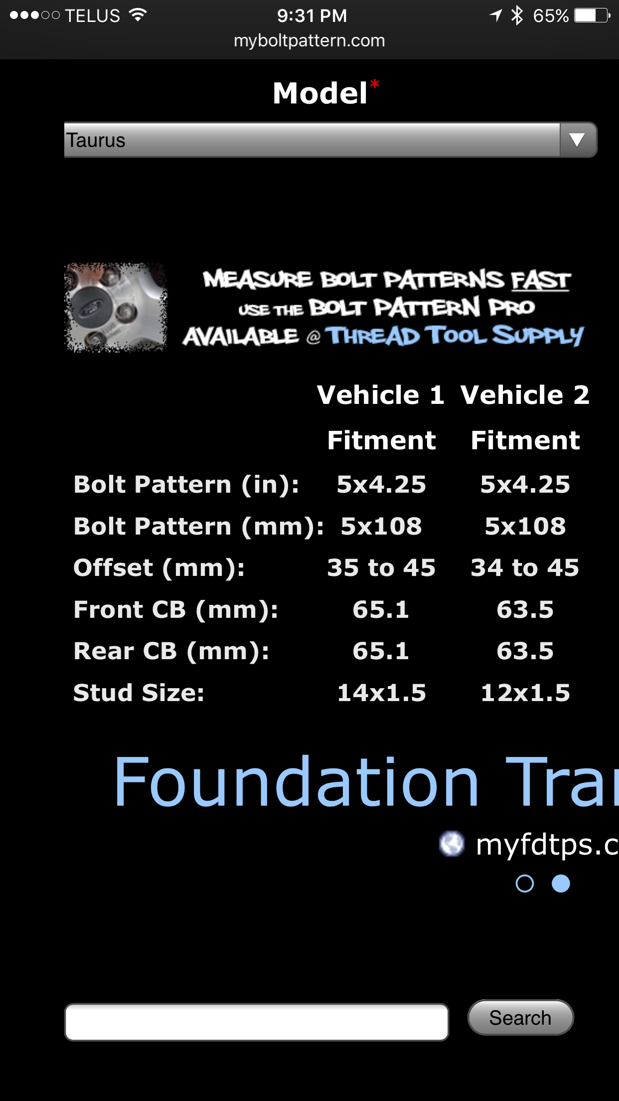

I found some 205/65/15 winters on steel rims for $300. They are off an early 2000 Ford Taurus.
I attached (factory rims specs picture). It seems the centre bore will be loose. And the stud size????
Would this be a risk?
I attached (factory rims specs picture). The second vehicle is the Taurus. It seems the centre bore will be loose. And the stud size????

Looks like the other way around. If the Vehicle 2 is the Taurus, then the wheels won't fit as the hub center is too small. You would need the center bore to be machines out. Also the stud size is less of an issue as again it is smaller, but may cause some wheel wobble if not tightened carefully.

Oops, yes the bore might be too small.
