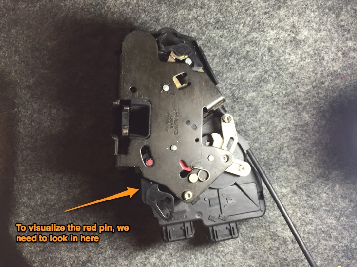

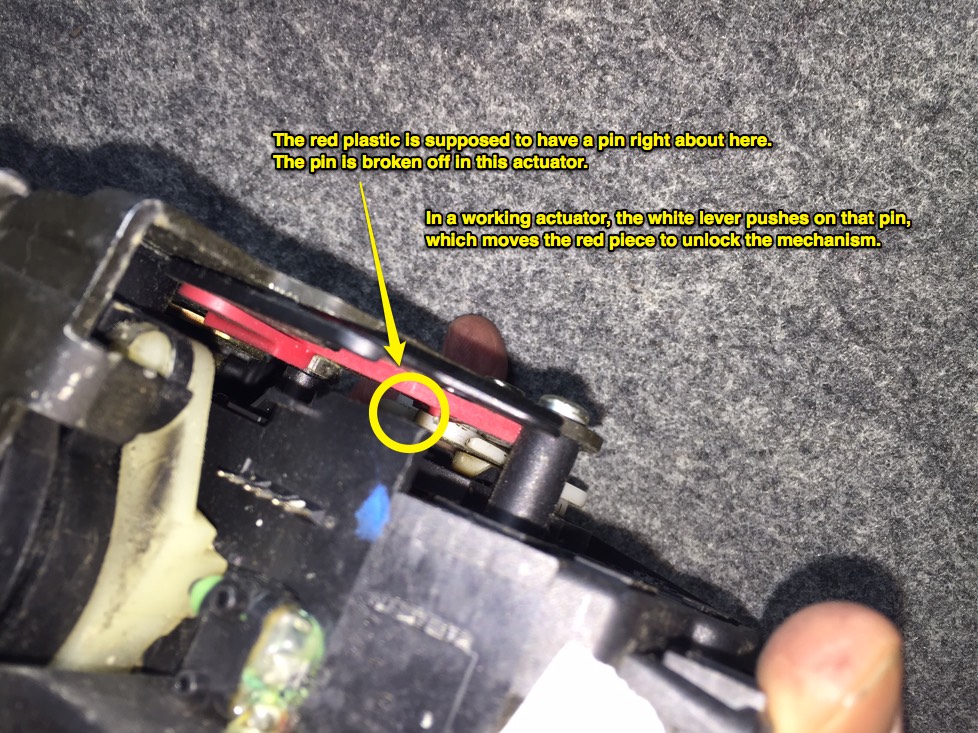

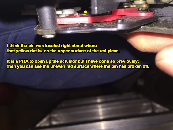

So I do not have actual pics of the pin, I didn't take any previously when I figured it out and right now all the actuators I have in the garage have the pin broken off. But I took some pics to try to describe clearly how to figure out if the pin is broken, and where the pin is located. Keep in mind the L and R actuators are mirror images, and front and rear are slightly different (I think?):

Once somebody takes a peek inside a non-broken actuator, maybe we can complete the collection of pics with one of the pin!

Turned out it was the Red Plastic thingy as erikv11 posted previously.
So:
1. Live with it (any passenger would have to wait for me to lean over to unlock the door).
2. New Actuator. Bad design from factory.
PS: I wasted time rebuilding the electric motor (replacing PTC with solid copper wire, BTW use the smallest screwdriver you can find to undo the 2 small tabs on the side), so for future reference:
- Once the door panel is OFF...reconnect only the white connector to the RF lock switch to test the motor
- Place your ear next to the actuator and operate Lock/Unlock button (on the door panel) to test the electric motor. If you hear the motor spinning in BOTH directions, but the lock know ONLY going down and not UP, then the problem is the Red Plastic thingy that erikv11 said above. In that case, new actuator is the way to go. If you are brave then remove the actuator and play with the Red Plastic thingy.

Read the posts right above yours that discuss this exact problem in great detail, starting with the post with all the pictures with orange writing on them. Lock-but-does-not-unlock is what happens when the pin is broken, check the pin visually.
