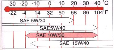

Here is the question I see that the manual says I can use 15W40 oil....now the question is...can I use 15W40 DIESEL MOTOR oil in a Volvo 5 cylinder GAS engine....? I would say YES in that diesel motor oils have more additives in it for soot and acids and so on making it a better oil for keeping things cleaner and so on....however I just wanted to ask if there is any problem or reason that is unknown to me why I can not or should not use diesel motor oil in it.

You'll note on that chart there is a given ambient temperature range given as well. Seeing as you're somewhere in Canada, 15/40 is awful thick for cold climates. 10/30 is a safe bet, with 5/30 great if if gets REAL cold where you are.
15/40 can reduce fuel mileage, and cause the motor to turn over slow when cold

SYNTHETIC SAE 5W-40, or even Mobil 1 0W-40 synthetic motor oil should work fine.__Lloyd__ wrote:...15W40 oil....
I'm using Castrol Edge 0W-40 (European formula) currently in my red-block 245 (1993)
Volvo says for your vehicle, "Synthetic oils complying with oil quality requirements are recommended for: Driving in areas of sustained temperature extremes (hot or cold), when towing a trailer over long distances or for prolonged driving in mountainous areas. "
Yes I do live in Canada, however just because I do does not mean we live in a -300c ice box....! Where I live winters are often around 0c ( 32f ) and a few times it got really cold and we hit -10c for a few days. If I go according to the Volvo oil chart, I can use 15W40 all year round in most cases. The weight is NOT the issues and not the question. The question is around more to do with using a DIESEL MOTOR OIL in a gas engine....the Volvo 850. That is the real question I am asking here. Is there some reason WHY I should NOT use a diesel motor oil in it....?
