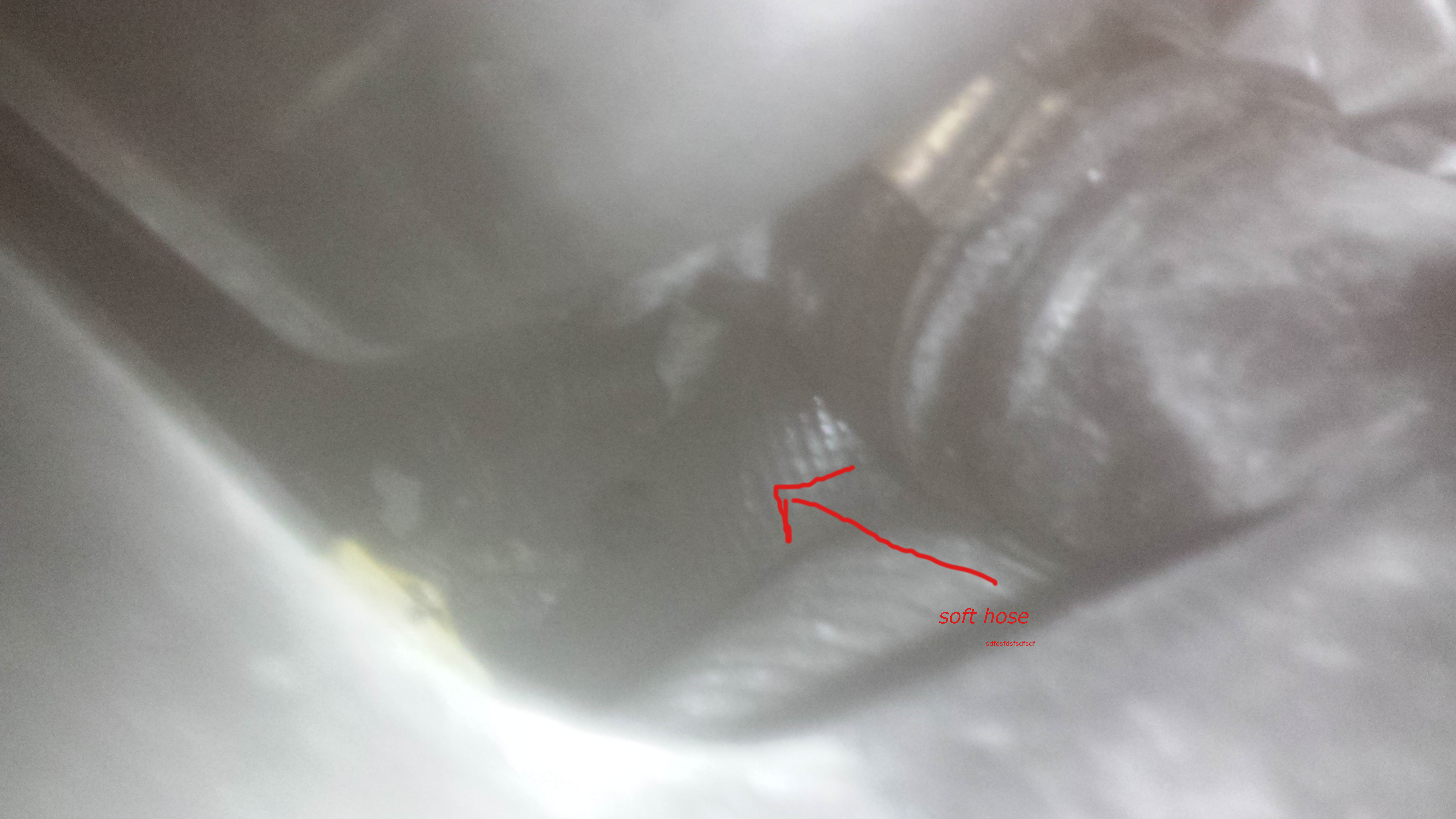

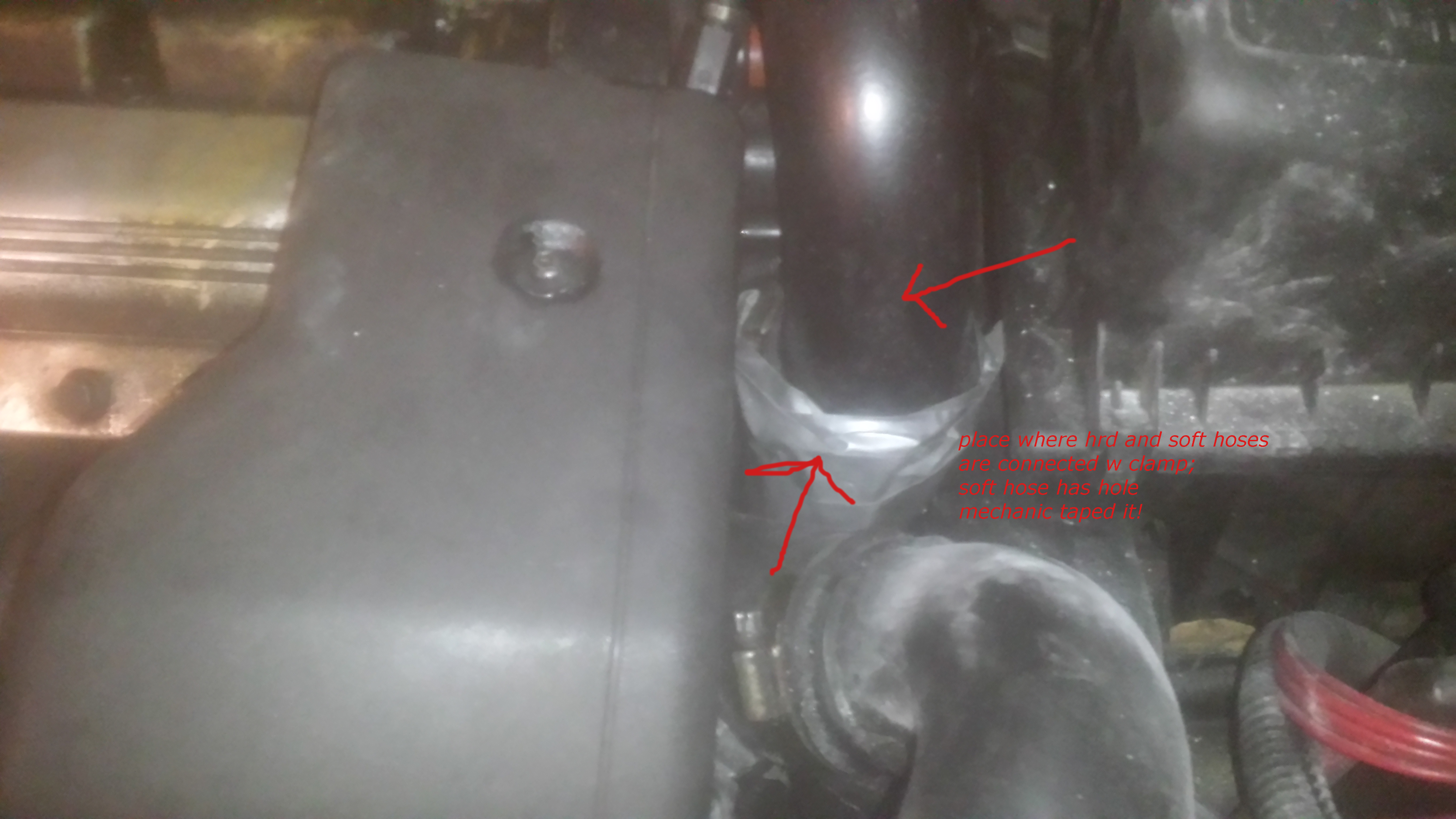

Can someone please help me id this?
I have a great mechanic, who upon noting a hole in one of the turbo hoses, proceeded to tape it, even though
it is under pressure and gushing oil everywhere. Give me a break, I am not a mechanic and don't have a dad.
This is probably supposed to be a hard hose all the way through, but mine has a soft hose connecting two hard hoses with
some clamps. The soft hose is taped at the clamp, as you can see. I had to retape it, as it isn't quite doing the job.
I have two pics: one of the top hose and another with the soft hose as seen from above. So there is the top hose, clamp, soft hose with hole and tape with a snake like texture, and then a hard hose that it connects to again below.
My question is, before I get reamed again, should I replace the soft hose with a hard hose or a soft hose? Can I get away with
something from the hardware store? I am on a tight budget. The two hard hoses above and below look intact but I am assuredly ruining my turbo with this mess. I don't have James Bond smoke coming out of the tailpipe yet.......
What part number/id is this please?
Thanks

If you're ok with spending a little more, this set will replace all the worn out soft hoses.
http://www.ebay.com/itm/Silicone-Boost- ... ma&vxp=mtr
If you just want a stock hose replacement, I think I have one $5 + shipping.

You can use the diagram from vivaperformance to have an idea of which hose is which:
http://www.vivaperformance.com/silicone ... c70-turbo/

I come up with an OEM part number of 9161091 for the hose. It won't hurt the turbo but it does kill the cars power if it is leaking.

Thanks so much for all replies. I got the hose online for 11.00 with the OEM part number. I was quoted at least 60.00 just for the hose from every mechanic I asked. I realize now that the oil is a result of a clogged PCV system. This hose problem was causing sporadic power loss.
The damn thing had a hole in it!
