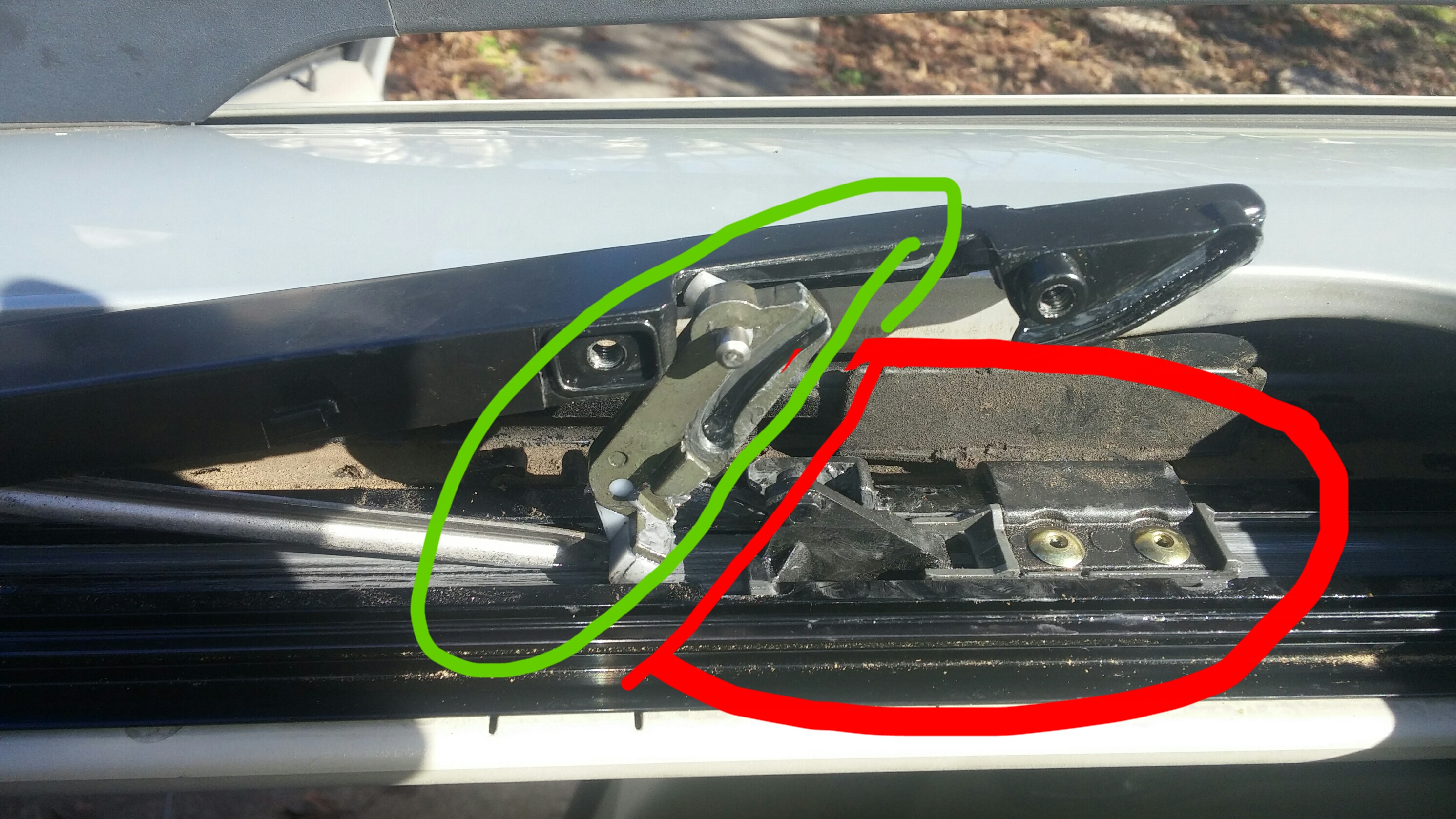

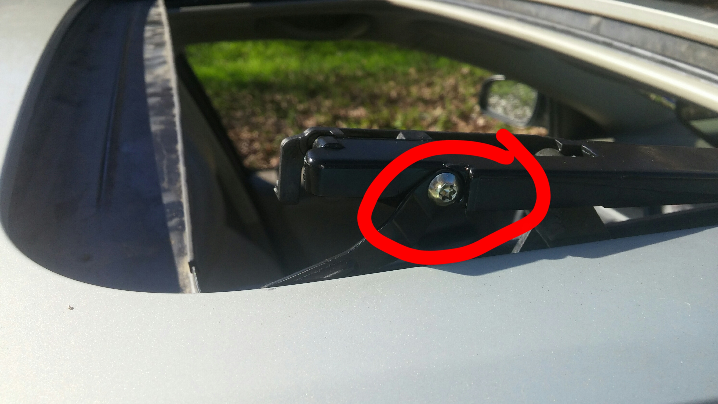

Took off the sunshade and sunroof window. Disconnected the slider arm attachment aka "guides" (to me). Cleaned rails (best as possible witbout removing them, and could run the "guides" as far back as they could go... Re-Attached guides (without window) and still only goes half way back. What am i missing here? Do I have to pull the headliner to gain full access?

Some pictures to show what I am talkin about. When the red/green circled items are attached it only produces the window to retract half way. When they are unattached I can move it as far back as it goes with the window switch. Also... Using the window switch, the sliding mechanism doesnt come to a locked position (as in where the window would be in a "closed" setting. It just goes up and immediately retracts as if it cannot find the "closed position".
