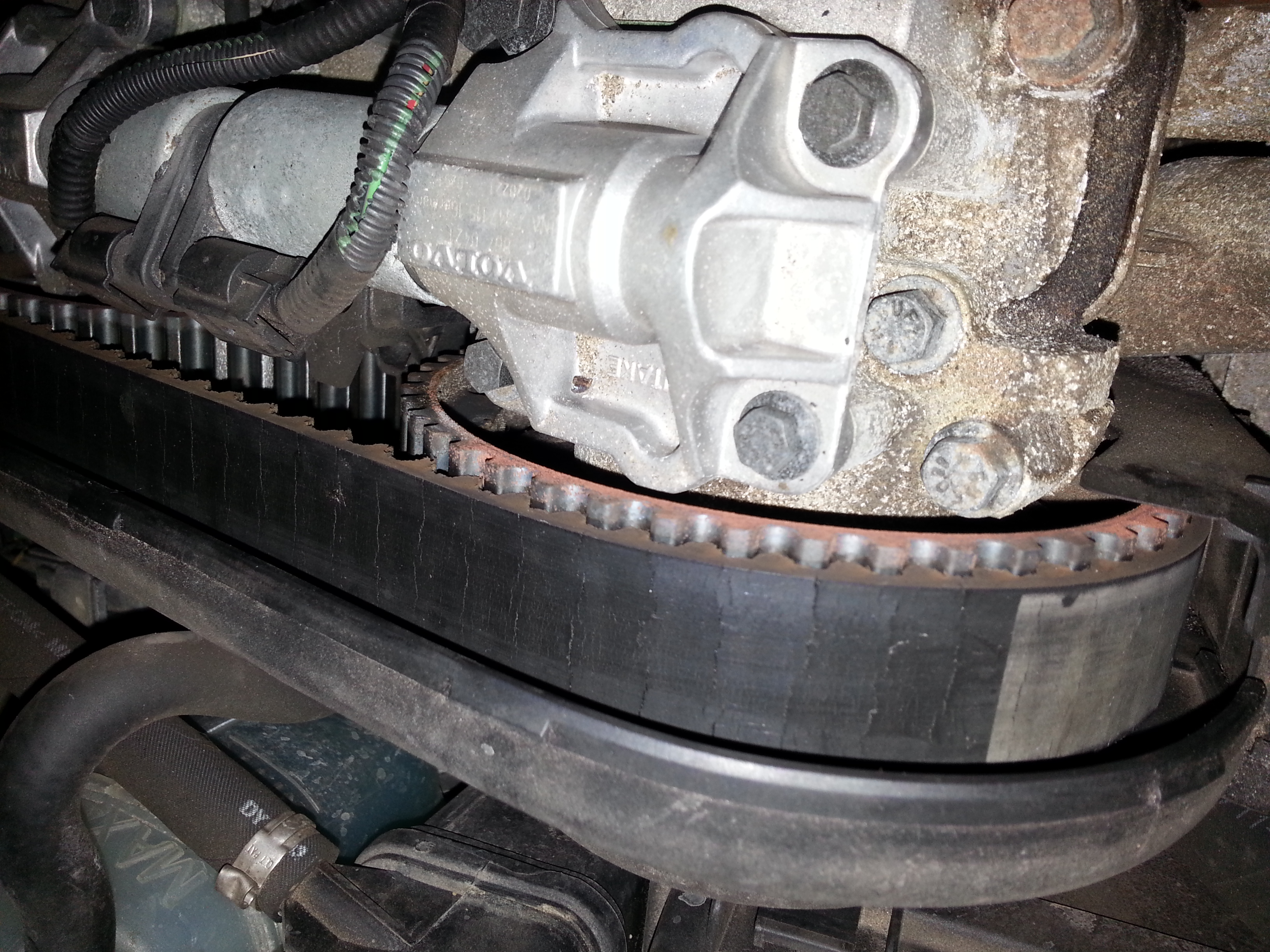

Thanks guys. Guess it's the OEM plugs for me. I just ordered the timing chain kit. I'm guessing it's the original belt. Here's a pic. I have been driving it, but won't any more until I change the belt, pump and pulleys.

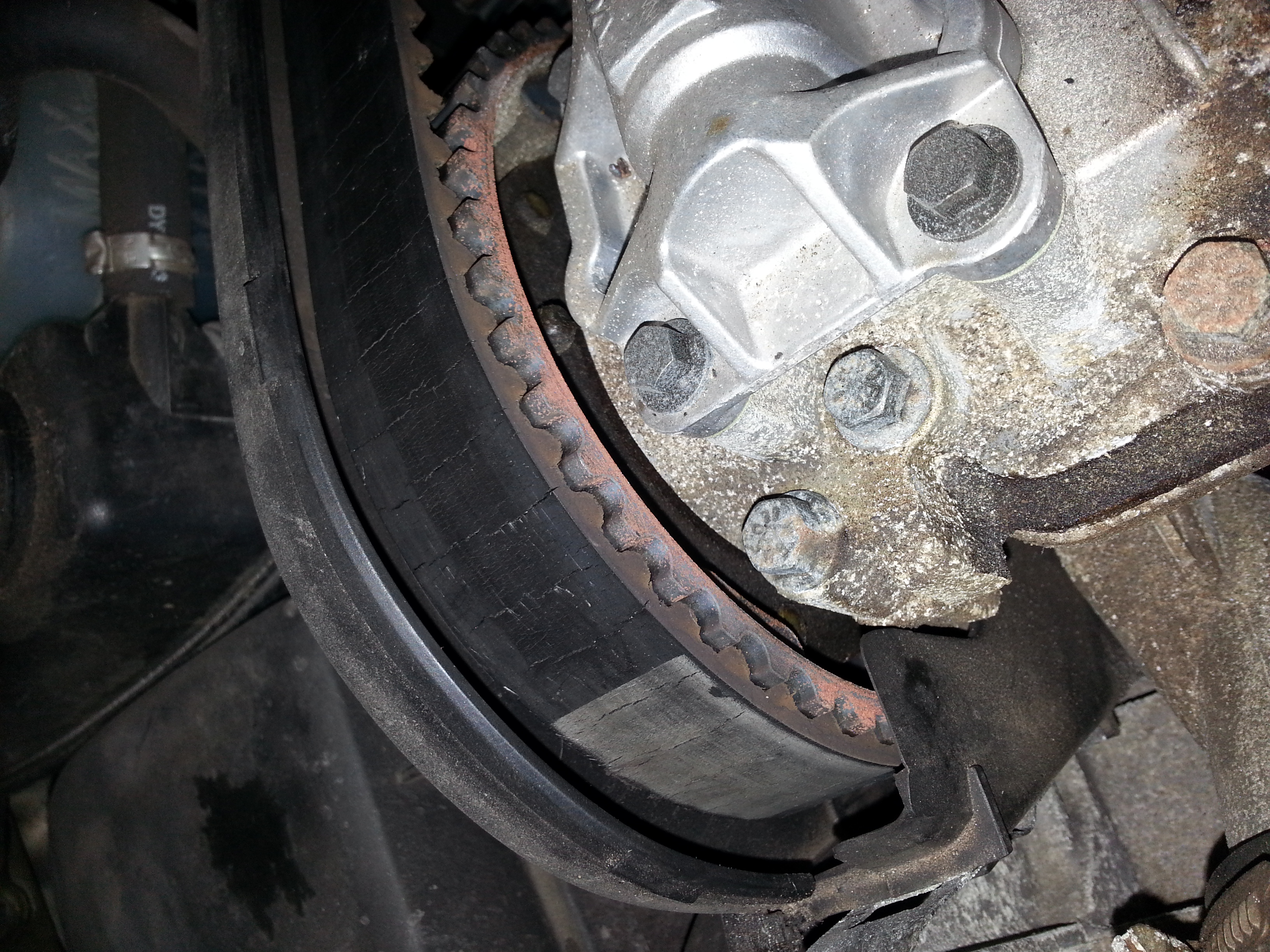

Here's some pics of the belt. Would you drive it like this, or wait until it is changed. Thanks!

Yikes on that belt! I use Volvo plugs after having read a bunch of posts on alternatives. As long as they last, not worth the risk of getting sub-optimal ones IMO. If you order them from a specialist, like IPD, FCP or for that matter your friendly Dealer, they'll make sure you get the correct set (sorry, don't have a P.N. handy). Watch out watch out for the plastic nipple on the thermostat as you remove the plastic cover over the timing belt. They get briddle with age and before tou know it you're installing a new thermostat housing. Not all bad, as kits that IPD etc sell come with a thermostat, gaskets, and also a new temp sensor, which deoending on how long ago these parts were replaced, is not a bad thing. All for a bit over $100 as I recall, original Volvo.
Thanks! I'll pay attention when I remove the cover. I'm not going to drive it until I change the belt. It's -20 deg F here. I figure there will be flexibility in the belt at that temp. The belt kit should be here tomorrow! Wish me luck!!
