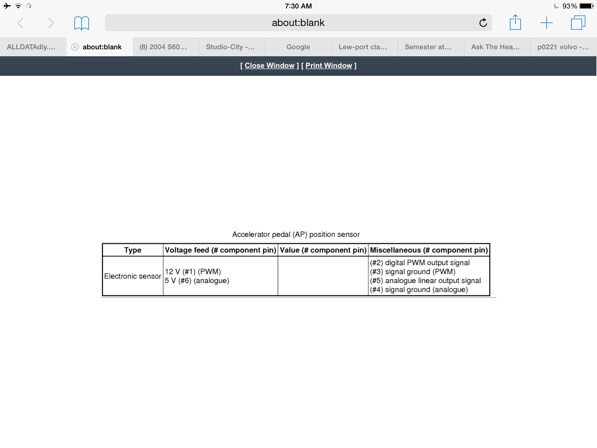

You should be able to remove the accelerator pedal sensor and measure resistance to see if it's smoothly changing. Inspect connectors too, of course.
I think your throttle body is Bosch, not the dreaded Italian job, which are really reliable.
I'll see if I can find APS numbers for my 2005 which are probably the same

Thanks for the pinouts. I'll measure the resistance today and see what i get. I do have the Bosch ETA. Apparently they can go bad also, just not as often as the earlier Italian ones did.

Thanks mate. Checked the APS today and there are no spikes or flat spots. Looks like I'll be trying the ETA.
