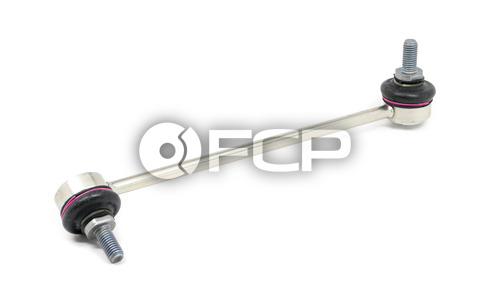

There are few actual mechanics here but plenty of us here can run rings around non-Volvo mechanics as far as mechanical knowledge and experience with these cars.
The 1996 960s have sway bar links and these can loosen with time. They are attached on left and right side of the suspension from the suspension strut tower directly to the sway bar. Tightening these is always the first step.
