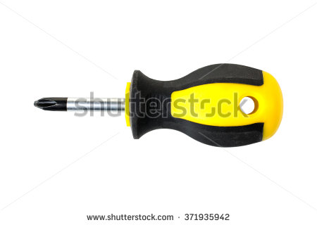

There are two difficult parts. First is to disconnect the little 'strut' from the glove box, I managed to break it. Then it's accessing the rear philips screws that attach the blower. A small handle screw driver would be most welcome
- scr.jpg (14.6 KiB) Viewed 902 times
